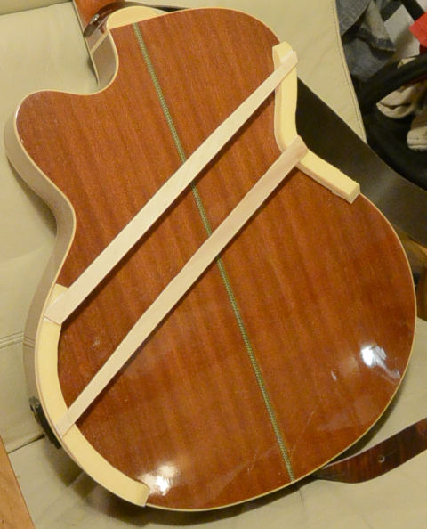

Re: Spacers on the back of a guitar?
So here's my prototype - two stripes of poplar, the spacers made of XPS, and all temporarily fixed with double sided tape. It actually works as indended, and that's sufficient for testing and getting experience over longer time.
Quite interestingly, tapping the top shows pretty large stiffness in all of the upper part of the top (i.e. completely silent) and a stripe of cm within the edges of the lower part. So actually only a small part of the top does actually move significantly, a lot less than with my other acoustic guitars. Nevertheless, that instrument is loud, and it sounds well. But that also indicates, that there is still unused potential of such a body (Jumbo, 17" wide, 11-122cm thick). Well, that's a Harley Benton HB30 which cost me 75 € (new about twice that amount), so everything is fine. I'm actually quite impressed how well such a cheap guitar may sound if it is only done intelligently.
- Beate Ritzert
- Posts: 607
- Location: Germany
Obviously. But anyaway: as soon as i move away the bass a few cm from my body, a similar situation arises there will be a gap which will of course affect the movement of the back.Alan Carruth wrote: ↑Sun May 29, 2022 12:06 pm The extra air space adds a lot of complication when it comes to the way the back vibrates, with the usual solution being vent holes on one or the other back.
The main difference to a partially doubled back appears to me the difference in reflectivity if ther spacers carry a wooden plate instead of the two stripes in my testing setup.
But anyway, a more porfessional looking solution could be something which is removable and possibly also adjustable, maybe something like an oversized violin shoulder rest.
In such a setup the beauty of the wood might even be less important because the thing will remain an addon. For now i tend to use beech plywood and just oil it with something like tung oil or probably clou hard oil (a thin oil laquer).
I am still a bit unsure wether it is acoustically better to leave the wooden surface intact or cut a large hole into it.
