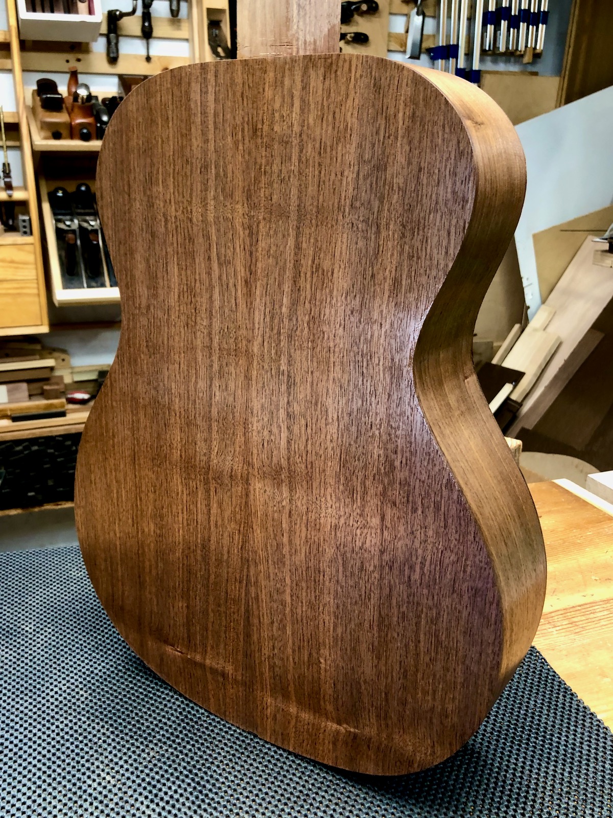

I'm making some progress on my first guitar. I have closed the box, trimmed the edges, and sealed it with some shellac. The top is western red cedar, the back and sides are black walnut.

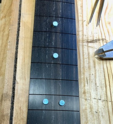

I made a fretboard from an old ebony blank I had. It has some nice color streaks in it, just the way I like it.

I think that fingerboard will look great with the body woods. Nice job.
Are the feet markers as blue as they look in the picture? I can’t tell if it’s true color or some optical effect. I could imagine that being nice with a subtle color in the headstock to match. Like Alan said, though, clear it with the customer first!

Thanks, Dick. The dots are reconstituted turquoise. The different colors in the photo above are just the lighting. Here's another image before I installed them. -EricDick Hutchings wrote: ↑Mon Aug 16, 2021 11:08 am This is coming along nicely and I'm with you on the streaked fretboard. It's much nicer to look at than perfectly black. The color choice for dots, I'm on the fence. Looks like one is white and the rest kind of aqua?

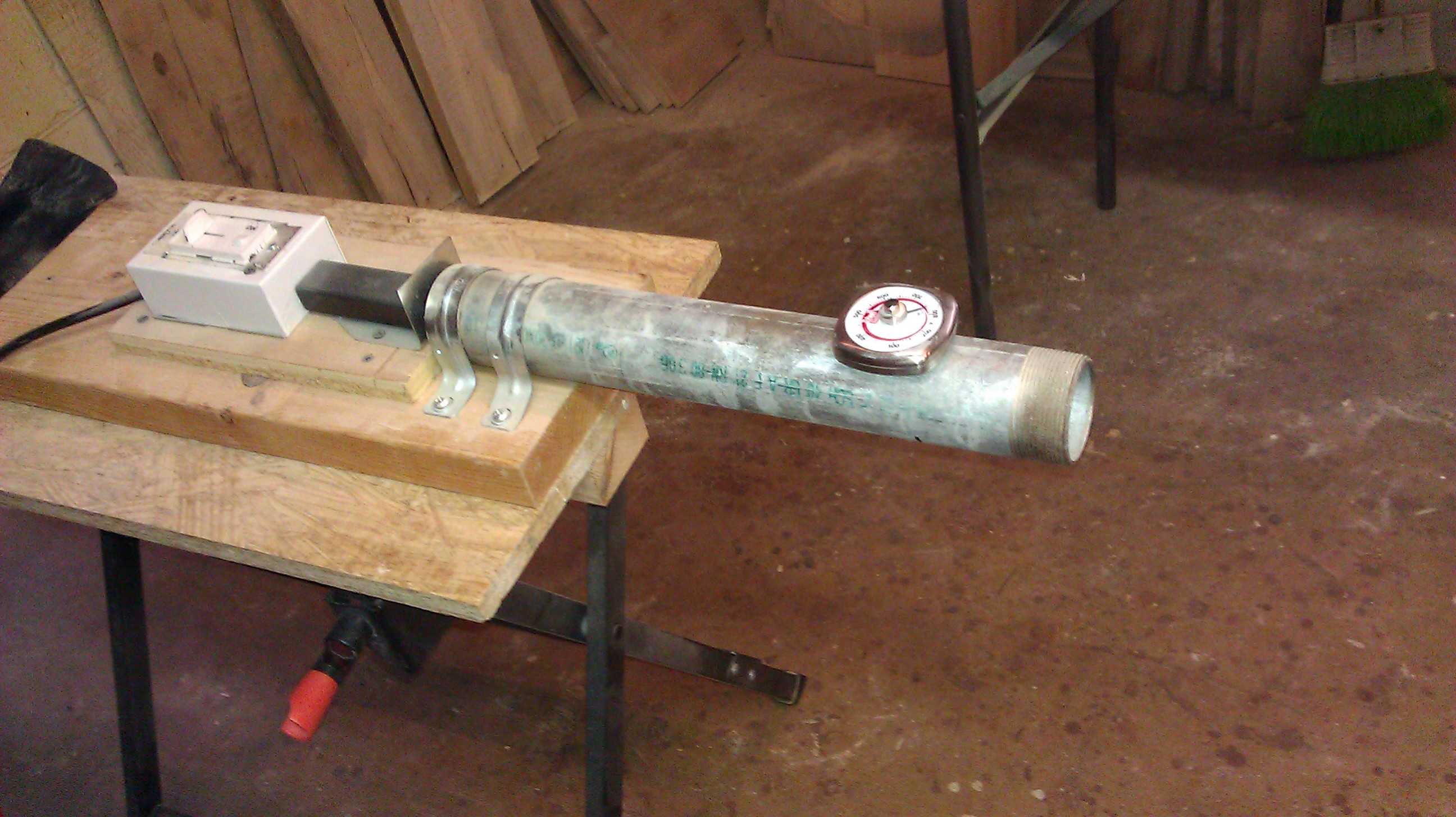

I have an old round hot pipe bender but I have no idea how hot it gets. How do you measure its temperature? I got a cheap IR thermometer with a laser pointer from Harbor Freight. However, it doesn't seem to give me accurate results once the temp is over about 200. It only says my pipe is about 210 even though it will leave burn marks on wood if I leave it too long.

I use a long thermometer probe sold for use with turkey fryers to monitor the temperature. It has a metal clip intended to attached to the side of the fryer pot, and that works great suspending the probe inside the pipe (second photo). I also tried a magnetic temperature indicator intended for use with gas grills, but the fryer probe has proved to be more reliable.
