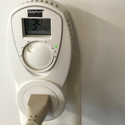

I am looking for suggestions on a room humidifier. I am in Arizona so humidity for most of the year is in the 10-15% range. I am considering hanging 2 acoustic guitars on a wall in a room 7ft x 9ft, ceiling height about 7.5ft. It's a laundry room with an open doorway to dining/kitchen area. I would likely just hang a curtain on a rod to close off the room. Not ideal but I don't think I want to install a door.

I’ve been through about all of the types available over many years. What I have settled on is the Vicks steam humidifier controlled by a Dayton humidistat. (The humidistat isn’t accurate on its face but can be set with a calibrated hygrometer in the room). The drawbacks of the other types: The wet wick or filter humidifier gets moldy. The cool mist humidifier pollutes the air with very small mineral particles unless distilled water is used. The drawback of the Vicks device is that it only holds 1.5 gallons of water, so you have to pay attention to it.
