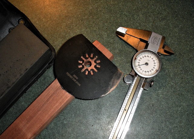

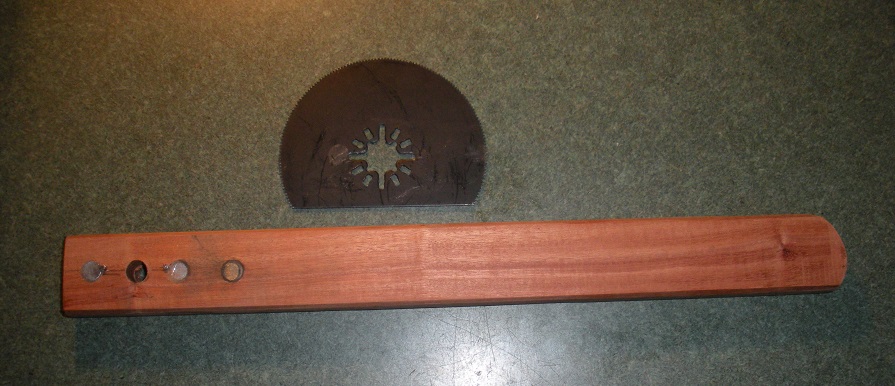

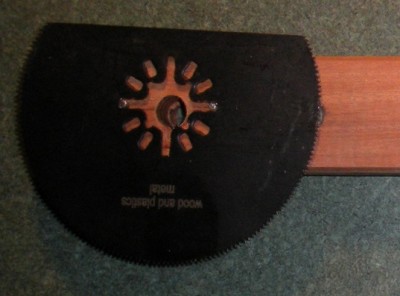

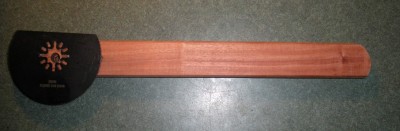

A handy little saw can be made from a half moon blade, a scrap of wood, a few neodymium magnets, and a couple of brads. The magnets are mounted into a wooden handle and allow the blade to be flipped over for left or right handed flush cutting. The brads keep the blade from sliding on the magnets and are cut and filed flush with the thickness of the blade. the brads also allow the blade to be rotated so a different portion of the blade can be used for cutting.
The half moon shape of the sawblade is similar to what some veneer saws use.

Re: Homemade flush cut/ veneer saw
If you "stone" a portion of the blade to match the kerf required for your fret wire you can also use it for cleaning out fret slots for re-freting.
