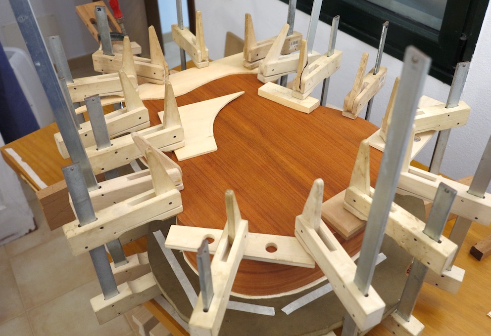

I closed one up tonight and hope to get the other closed tomorrow once the solera is free again. Then they will both be put aside for a while until I get another chance to work on them.
Thanks.
This afternoon:

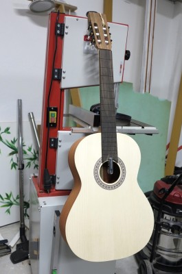

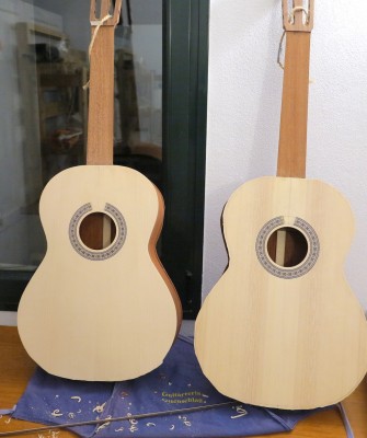

This is one of the pair I am working on at the moment. So far I am quite happy with the progress.
If this project is successful and I manage to sell the pair quickly, next up will be a repeat with maybe four instead of two and a tweak or two to the project. Gotta finish this pair first.
