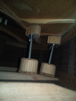

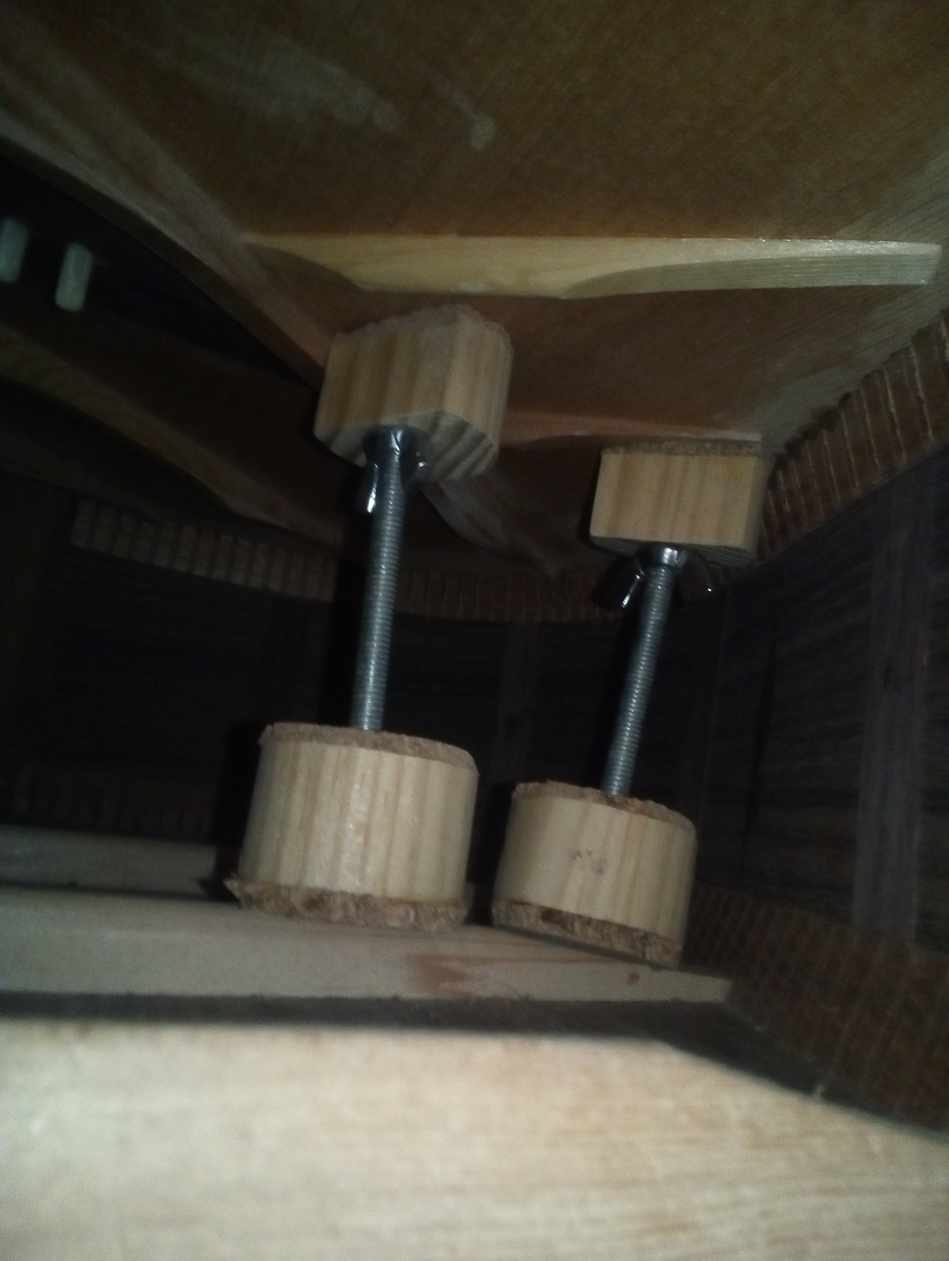

Thanks to this thread I found another issue in the guitar :) Two of the back braces have a small section where they are unglued.
The comment about the back bracing made me start tapping the back and I found a rattle. Inspecting the braces I found the problem.
Here's a pic of my dry run for the repair:
Posts: 3254
Re: Loss of bass lowering the saddle?
You might want to also apply a clamp on the outside of the guitar to resist the pressure from the internal clamps. This will also help to press the back down and close the gap.
jorge rodriguez
Posts: 56
Joined: Tue Jun 12, 2012 7:38 pm
Post by jorge rodriguez »
Thanks Barry! Will try that.
Posts: 1390
Barry took the words out of my mouth. Make sure you protect the surface of the top from the clamp so you don't mar or dent it.
jorge rodriguez
Posts: 56
Thanks so much for the tip... I was just doing the repair now and clamping outside was exactly what allowed the gap to close :)
