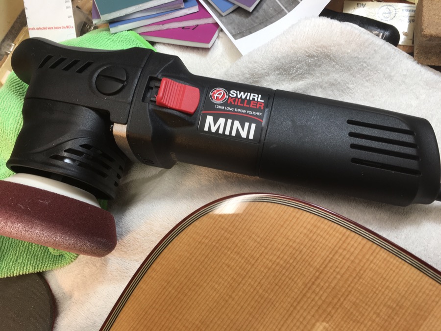

My pneumatic ROS/ buffer finally bit the dust. Probably loaning it to my son to buff his car was too much for it.
So I did a bunch of research and bought a new tool. I decided to go electric this time because the air driven tool worked my air compressor excessively. I ended up getting this one:
https://adamspolishes.com/collections/e ... t-polisher
It has a long throw orbit (12 mm) and is a geared random orbital style. Really heavy duty and uses 3" or 4" diameter pads.

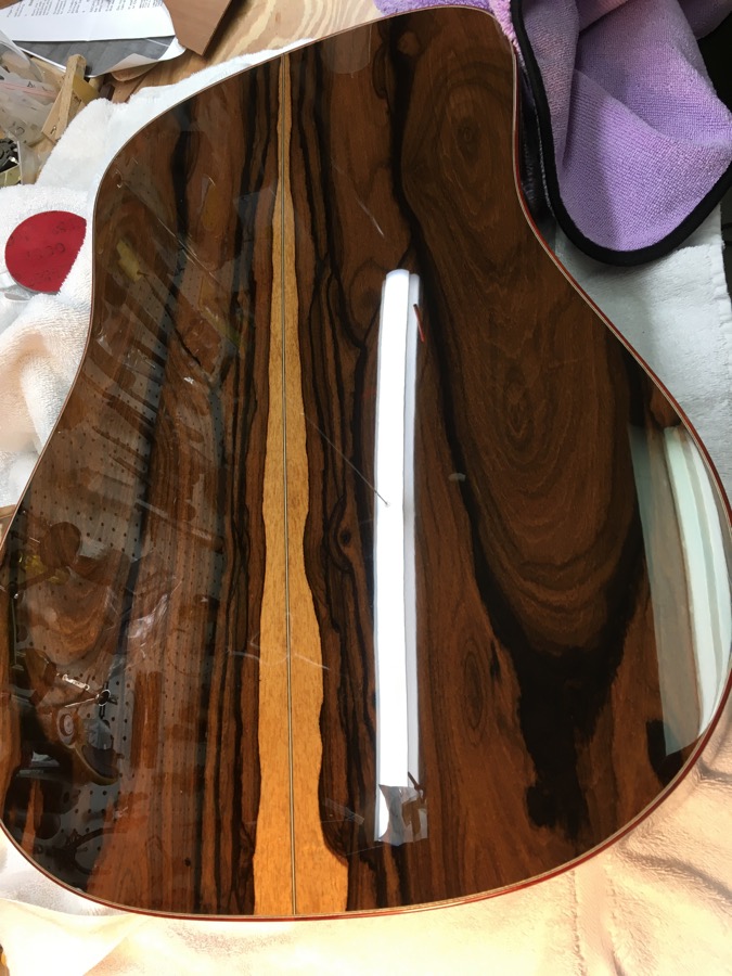

Can is sand as well? It looks like it has dust ports on the pad. That's a fab looking guitar there for sure.

That guitar was built by a friend of mine and I re-did the finish for him. Beautiful zircote for sure.

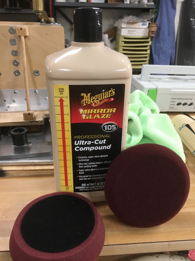

By the way, the pad I am using on the buffer is a maroon, beveled, 4" dia., firm cutting pad by Meguiars. It fit the buffer great. The beveled edge of the pad went across the waist of this dreadnaught, polishing it well. Never been able to do that with this style of buffer before.

The geared mechanism makes this a very different machine from the normal RO sander or buffer. The orbits don't depend on the pressure you place on it, but are driven by gears so they are regular and unchanging. It makes the machine much more aggressive. Yet it is smooth enough to give you a fine polish. It even has a soft start feature. The tool is pretty large and heavy, but I was still able to use it with one hand while I held the guitar with the other. I am very pleased with it so far.

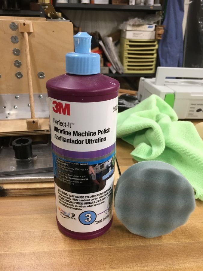

I like to do buffing in two stages.
1) First stage is Meguiar's Mirror Glaze Ultra-Cut Compound 105 buffed with Meguiar's G3507 DA Power Pads for Step 1 Compound (4" maroon firm pad).

2) Second or final buffing is done with 3M Perfect-It Ultrafine Machine Polish (39062) using a 3M Ultrafine Polishing Pad (4" baby blue soft pad).

You can also use 3" diameter pads with the Adams machine but I like the 4" because it gives you a little extra pad to prevent the hook and loop disk from running into your finish around the curves of the guitar.
