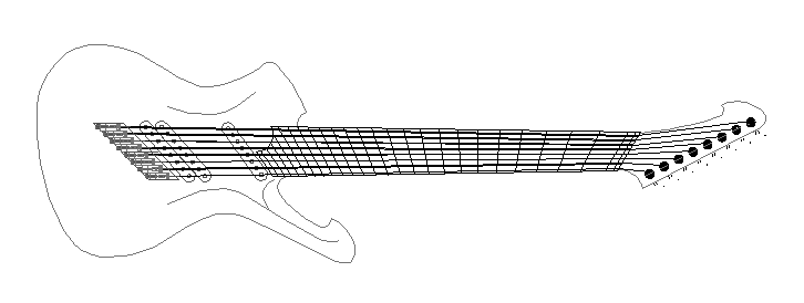

The design so far:
This is super-ambitious, and I'll have to make a lot of my own parts, but it'll be a fun challenge :D

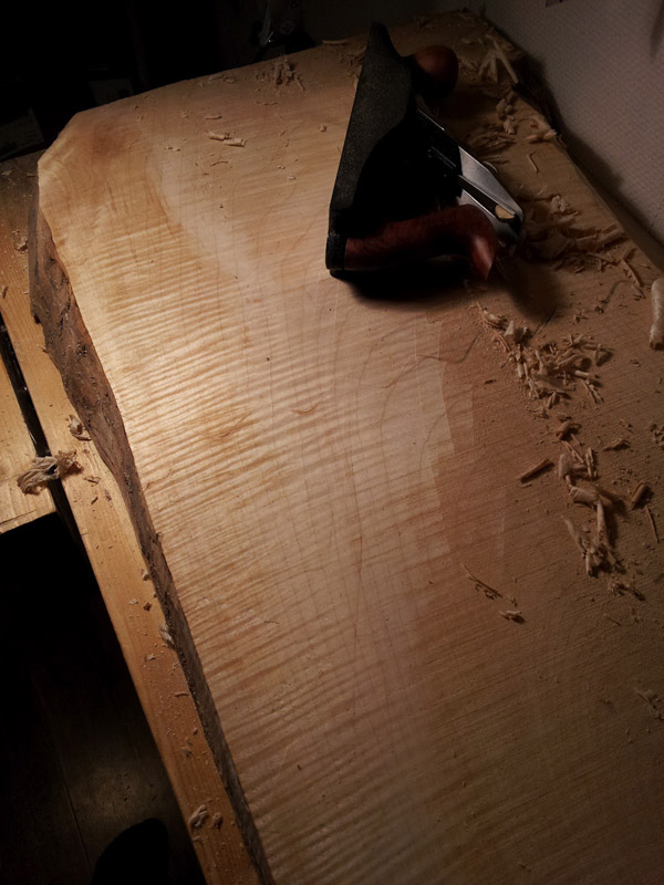

Here is a shot of the beautiful slab of flamed maple I have. I paid 5000€ per cubic metre for this, so a 15mm thick top should be around 11€ worth. The neck & fretboard should cost about the same, although if I laminate the neck with a strip of walnut it will drop the price some.

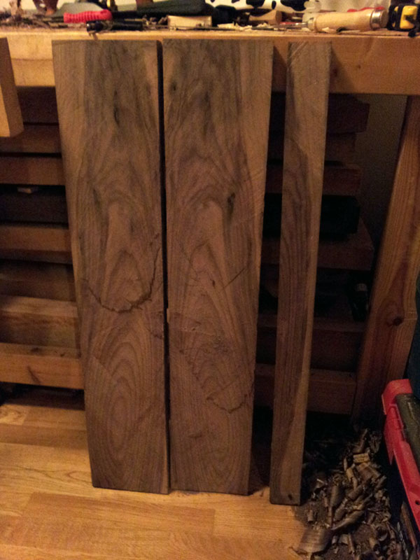

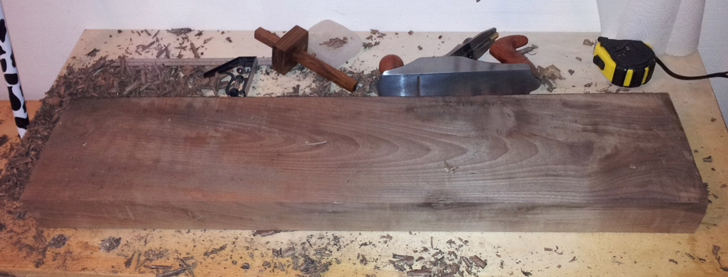

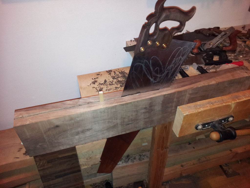

Alrighty so today I got cracking on this build after a week of "planning" (read: procrastination). Since I'm using walnut for both of my builds, I chose to do the body resawing all at the same time. I started by crosscutting enough walnut and roughly cleaning it up to better see what I was working with:
Measuring up, I realised that if I would still have enough for the two bodies if I first ripped 3cm off the side - so I chose the side with the straightest grain and ripped it off to make a neck blank. This might actually become the basis for the neck of this guitar, with a central maple lamination. We'll see.. Anyway, I then set about bookmatching the main chunk. This is a pretty serious bit of sawing for a hand tool shop - ripping 35.5" of 6 3/4" wide stock is a real workout! For this I used my Big Bertha saw - custom made 29" sawplate and a home made thumbhole handle:
Note the wedge holding the kerf open and copious amounts of wax on the saw! My technique here was a bit sloppy today, I haven't done a rip like this in over a year, so I strayed from the line in a couple of places. I will have to sacrifice some thickness as a result. Anyway, here are the results of the day's sawing, straight off the saw. Enough 25-30mm stock for two bodies, and a 64mm wide neck blank. There is some neat grain swirling around :)
A question for those with more experience with walnut: I think the sapwood there on the neck blank will look great on a guitar - will I have any strength/stability issues if I try using it?

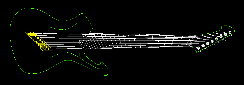

I added the pickups to my CAD drawing:
I'm currently thinking of making the humbucker actually two "normal" single coil pickups, so that I can split them for a more Strat-like tone. The plan is to make the polepieces from 5mm mild steel, and attach 5mm*1.5mm Neodymium magnets to each. I've been intrigued to play around with these magnets in pickups. I'm planning to make the bobbins from wood - perhaps curly maple, although I do have a huge number of beech sticks in a very convenient shape.
