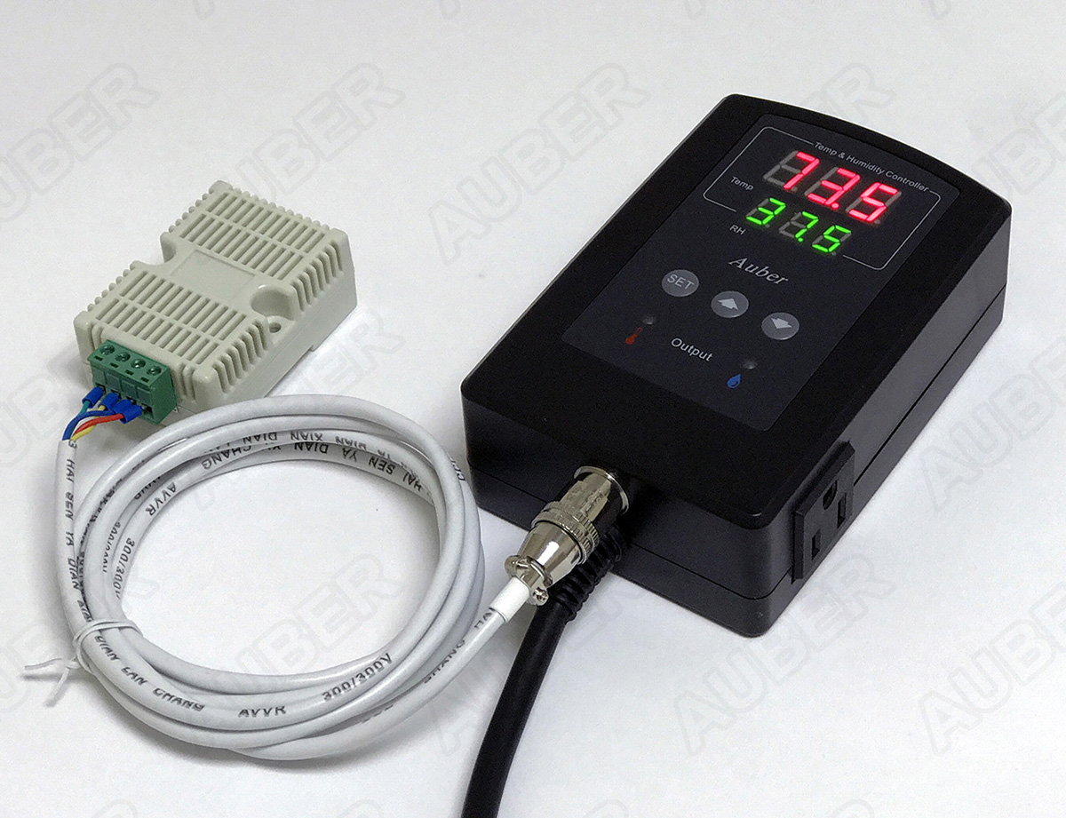

I found this thing
Might spring for it. I also need to empty out the shop, line the walls with poly and put sheathing over it. It's just studs and insulation now. Rigid foam on the ceiling. First things first.

I found this thing
