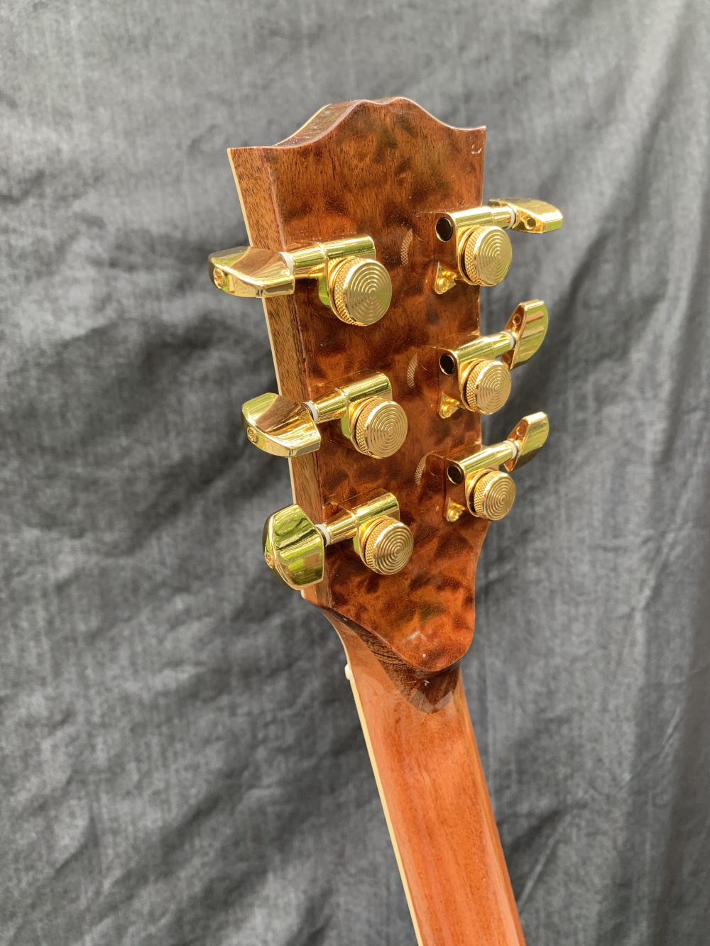

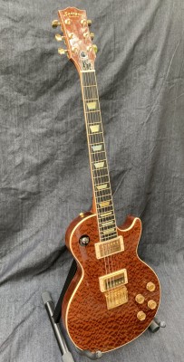

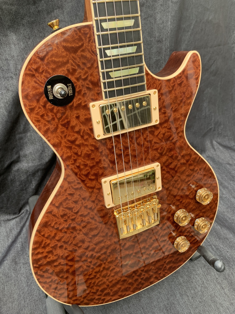

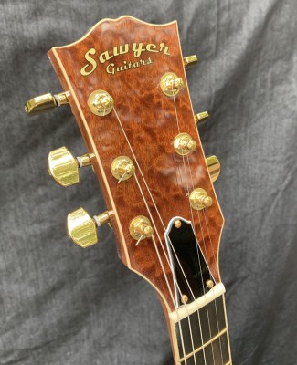

A few minor finish flaws, but overall I'm pretty pleased with how this came out. Plays real nice!!

Thanks - really turned out better than I had any right to expect being my second build. Had to work my way put of a couple of gnarly issues, but all's well that ends well. Very impressed with Brite Tone for a brushed-on finish! Wish I had space to spray, but I can make this work.
Also, this is my first guitar with an ebony fret board. Wow. String-bending and bending w/vibrato (always a challenge for me) is a whole new ball game. Like buttah...
I was going go do Brazilian cherry, but decided goofs on the inlays would be easier to fix in ebony. As it turned out, the inlays needed no gap-filling, but really pleased with the ebony. I'll probably use the cherry on the bass I'm designing.

Thanks, Christ. I did a test piece with GF High Performance, and while it’s ok, it doesn’t self-level anywhere near as well as Brite Tone. The HP had to be level-sanded between coats, but I was able to apply 10 coats to this and only level-sanded after they were all cured.
Spraying should be amazing, and can be done with far fewer coats.
