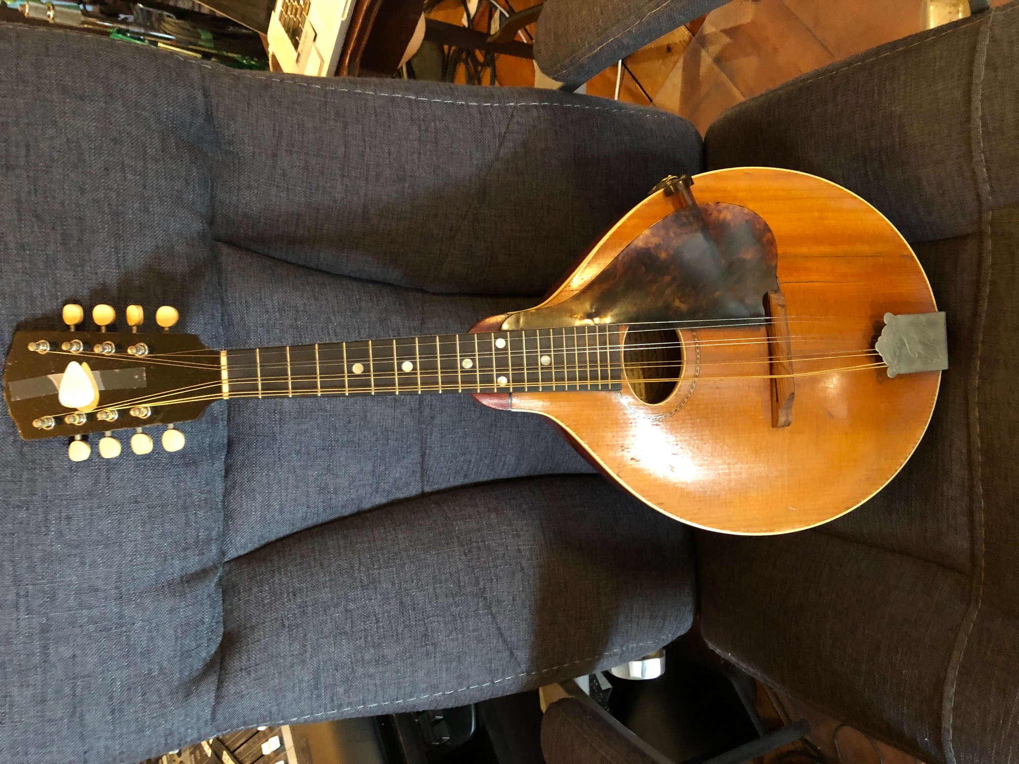

I recently bought a very nice 1915 Gibson A mandolin with several face cracks, but otherwise in very good condition with the original pickguard and tailpiece cover in excellent condition. The face cracks shouldn't be too hard to fix, but in order to work on them, I need to remove the pickguard. It comes off of the side clamp easily enough, but the 2 metal pins that hold it into the fingerboard are not loose and have not responded to gentle pressure.
I bought this primarily because it was all there and don't want to take a chance on damaging the pick guard. Does anyone have any thoughts on how best to do that? I'm considering a lubricant like a lemon oil but thought I'd check in with the forum first.

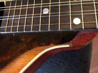

Rather than lemon oil, I would apply a drop or two of water and let it seep into the hole in the side of the fretboard and then apply some pinpoint heat on top of the fretboard directly over the pin using a soldering iron. You can protect the fretboard surface from scratching or marks from the solder iron by having a very small square piece of thin sheet metal laying between the adjacent frets. Just be careful not to touch the iron to any of the plastic parts.
The glue holding the pin should be softened up in 5 minutes of low to moderate heat from the iron. If you don't have an adjustable iron, then apply a full heat iron for a few seconds at a time between cooling off intervals, to prevent burning the wood.

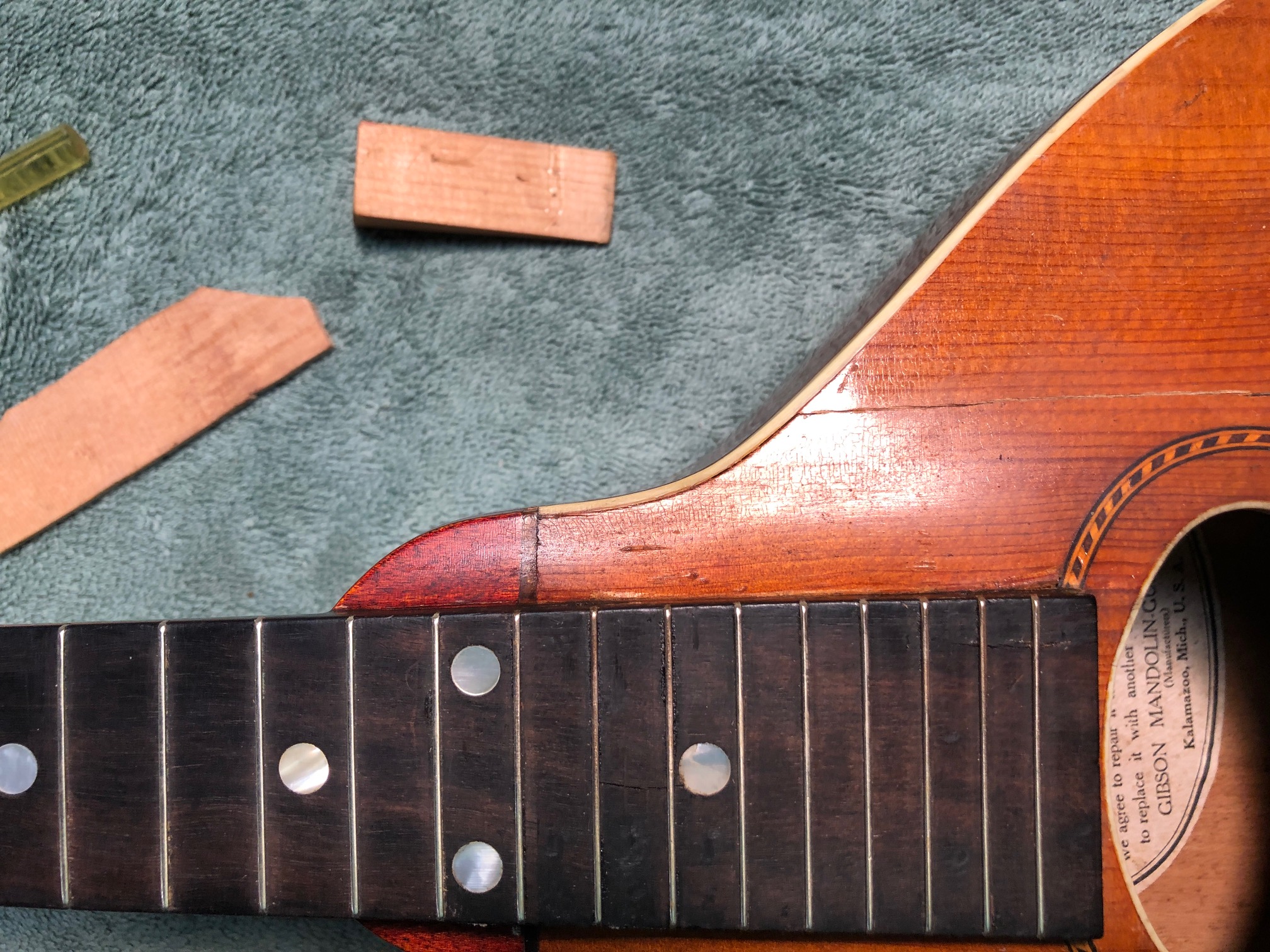

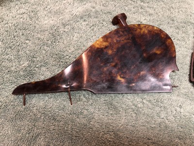

Success! After another slow heating with the soldering iron on the frets, I was able to get the pickguard to come lose. A slow process to be sure, but gentle use of the wedges, heat and an antique putty knife made things go quite well. As suggested, the nails were bent and rusty and it did "pop" off at the end. Thanks for the heads up on that.
I was surprised at just how much the nails were bent. I wonder if the bend wasn't related to installation. If the Pickguard was initially installed at the angle the nails go in, that 30 degrees folks talked about, it would give you access to drive the nails in and then the pick guard would be pushed down into place bending the nails like we see.

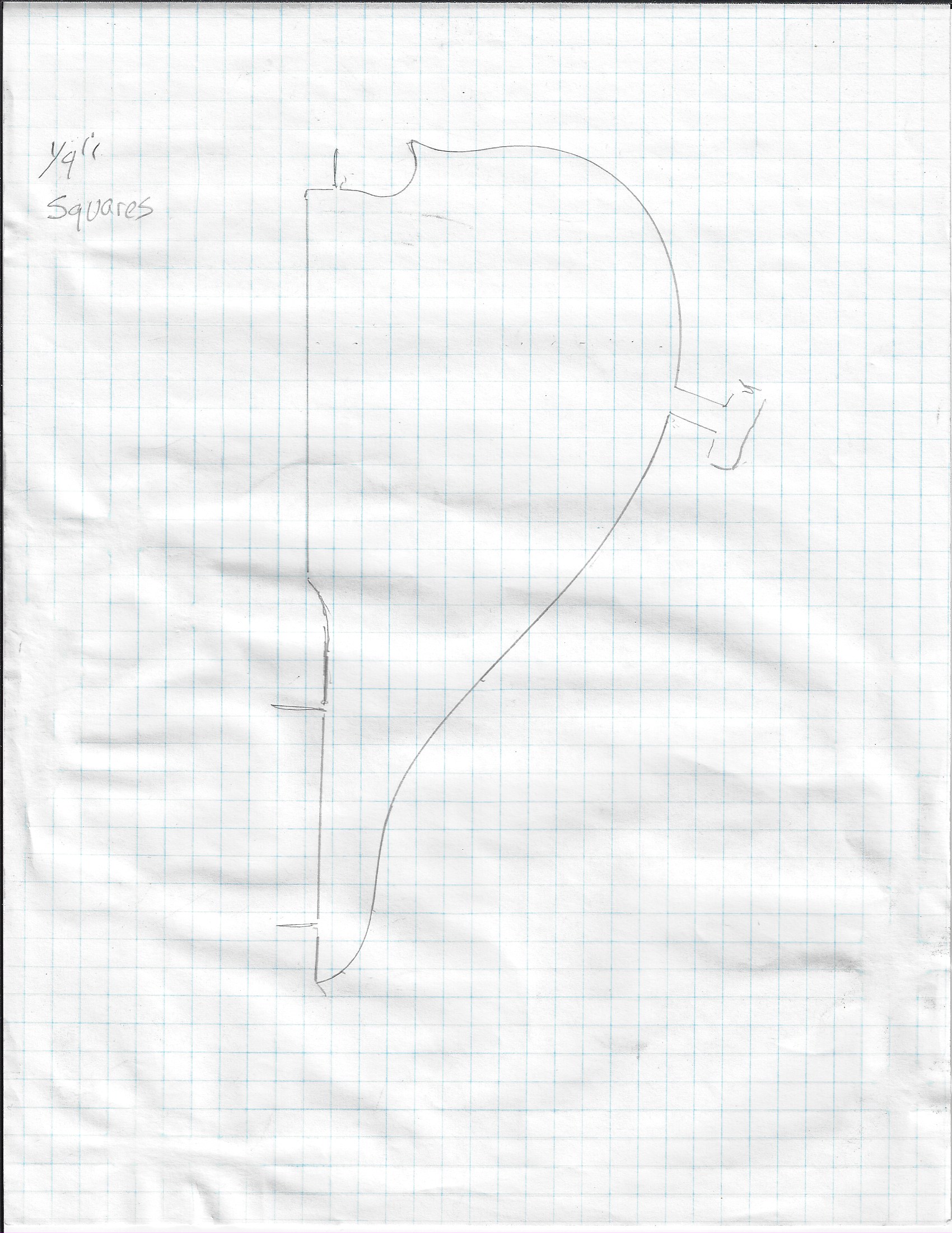

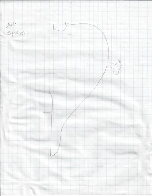

I've traced the outline of the Gibson A Pickguard onto 1/4" graph paper which is probably a much more accurate way to give you dimensions. I'll attach it here as a J-peg. You can download the PDF of this at this google drive link: https://drive.google.com/open?id=19DjwF ... qrunsZNSo2
Please note that I place this upside down on the paper to make the tracing and used a mechanical pencil with the lead extended so it should be a fairly accurate tracing. Regardless of how you print this out, the squares are 1/4 " so you should be able to get a very accurate feel for the size.
Hope that helps!
