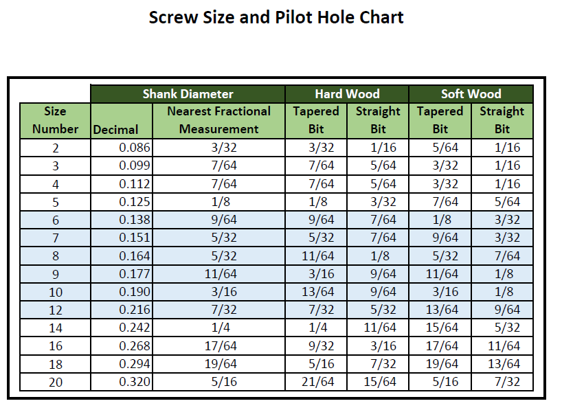

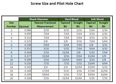

There are well-established guidelines for pilot hole sizes. They are determined by a) the number size of the screw (#8 or #10 is common for neck screws) and b) whether you are screwing into hardwood or softwood. Print this out, laminate it and hang it on the wall!
Everything we use for guitars is pretty much hardwood. I pulled a bunch of info together for this chart which shows the actual size of the screws (so you can determine what you have in your hand with some calipers) and the size of the pilot hole. If you have tapered drills which are specific for drillling pilot holes for wood screws, use them. If not, straight bits are fine, but more likely to need that wax depending on how hard the wood is and how tight you're trying to make the hole.
Also, I agree with Barry - there should be no engagement between your screws and the body holes.
Finally, what you're asking is the size of the "pilot hole" in the neck that is a) small enough to allow the screw threads to fully engage and b) large enough to not "bottom out" in the gullets between the screw threads, which can make the screws too tight and risking snapping the screws off while inserting them. The advice re waxing the threads is a good idea. Personally, I use a small dab of paste wax; it's easier to apply and sticks to the threads. Beeswax is "dry" and will fall off the threads, although it works fine if you warm the threads with a lighter or something so that the beeswax melts a bit onto the threads.
