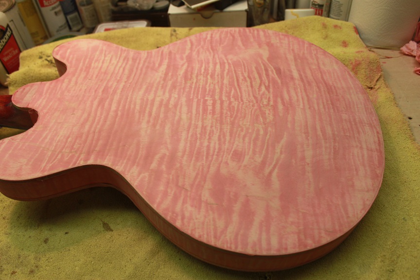

Steve Sawyer wrote:Freeman - your post is saying "stain" but your process sounds like you mean "dye". Stain is finely ground opaque pigment in a carrier. Dye is a transparent color in a water or alcohol carrier.
I have always used the the term stain to mean coloring something like wood (or your fingers) by absorbing a colored liquid. A dye is the material that provides the color. I know it is a thin line but I put dye in alcohol to be absorbed into the wood, I also put it into clear lacquer to make a tinted finish that is not absorbed. Wiki seems to agree with me
https://en.wikipedia.org/wiki/Wood_stain "Pigments and/or dyes are largely used as colourants in most stains"
The description gets muddy when we talk about cloth - we dye cloth with colored dye, but we also stain it with blueberry juice.
Certainly not something I'm going to squabble about, just the way I learned the terms.

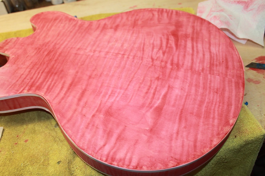

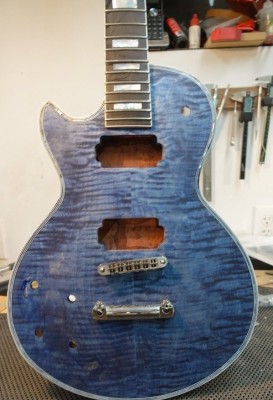

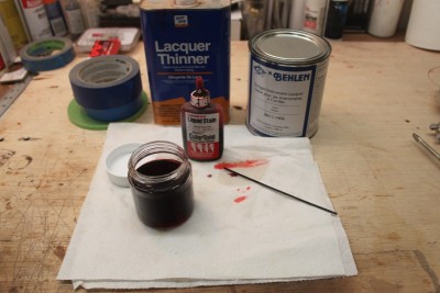

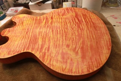

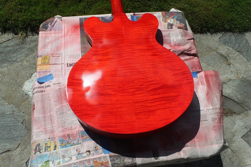

I've never done a blue guitar and I've never used TruOil with any colors so count me out with those. I've also never done a poly finish of any kind, so again, no comments. However if I WAS going to do a blue guitar I would do as others have suggested and either used a black pore filler if the wood was porous or I would stain the wood with a very dark blue alcohol based stain (since I am going to use lacquer). If I was going to FP it I would use a water based stain. I would sand that back to almost white which should leave a lot of color in the figure. Then I would apply a much more diluted blue stain to the entire guitar, that should color the lighter wood between the grain and figure. I would then seal the colors into the wood with vinyl sealer which I know is compatible with my lacquer. If I was not using lacquer I might seal with shellac. I then shoot 10 or 15 or 20 coats of lacquer.
If I wanted to make the blue color get darker towards the edges or if I wanted a more intense blue that I was getting with just the stain I might add a couple of drops of blue dye to my lacquer. The results would still be transparent but I could apply more of that towards the edges to create a burst or shade if thats what I wanted.
As I said, I've never done this with blue, but here is a red guitar. The owner wanted a really rich warm red color (I think he called it 'bubble gum") so I started with a red stain to pop the grain, sanded that back to white and then applied a weaker amber stain to color the wood in between the figure. He wanted a strong red finish with just a bit of the grain showing so I added red dye to the lacquer.
(never mind that StewMac calls this stuff "stain")
James Condino gave an absolutely wonderful demonstration of hand applied colors at a GAL conference a few years ago. If you click on the upper video here he walks you thru applying a green shaded stain - this is basically the same process I use but he does it so much better. No reason this wouldn't work with blue
http://condino.com/skoolin/
