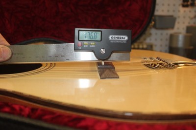

How is the neck angle? I would guess it needs a reset which would allow you to set the angle anywhere you wanted. Here for reference is the break over angle on my Stella-clone 12 string
On a guitar with a tailpiece the saddle is usually notched to set the string spacing.Michael Recchione wrote:Mark Wybierala wrote: I was considering doing pretty much exactly that, maybe even making a new tailpiece to get a slightly wider string spacing at the saddle for fingerpicking.

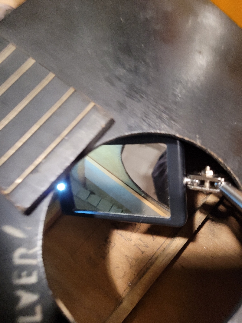

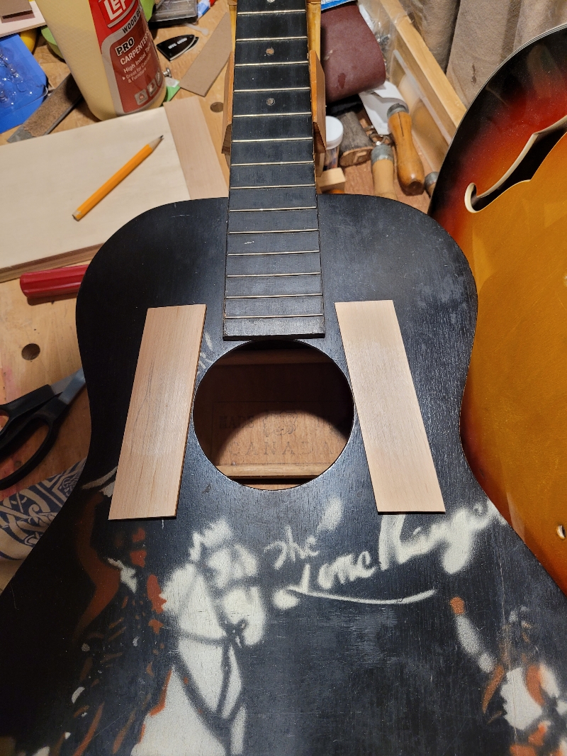

Another way to improve or correct the soundhole 'dip' or 'potato-chipping' on old ladder braced guitars, is to install bracing round the sound hole running from the lower brace to upper brace. Ideally, you sand a slight radius into the braces too, to counter the existing forces.
I have done this on a few old birch parlors and have seen results that mimic a neck reset and improve action as the area is flattened out, as well as improving break angle at bridge by enabling a higher saddle.. It also stabalizes that weak area for years to come. Btw, not my idea and I've read about it here or on FRETS.COM and watched Ted Woodford do it in a few of his videos.
Does it change the sound? Maybe a little, but not perceptably. You can do this in about an hour, through the soundhole, and it can theoretically be reversed the same way. The only thing I would caution, is that if there is significant 'potato-chipping' around the sound hole, you should clamp it flat for a few weeks before installing these braces.
