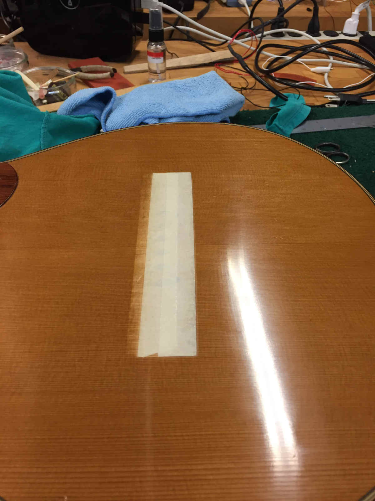

Hey People - I've not been around a long time, but I'm back in the shop, and the MIMF is still here so...
I'm repairing my first-ever guitar (from 2001!). I set the bridge wrong my first time round - just a 1/4" too far forward - Oye!
The guitar is FP'ed - cedar top - parlor size (Antes).
So I remove the old bridge, make a much better new one, and I'm fixing the finish on the top to cover the bare strip in front of the bridge - and generally just pretty the old thing up.
I get the old FP stuff out, make some shellac from flakes, and find I even have some olive oil - but it is old and rancid. I try a bit and, it makes a horrible smudge instead of helping the FP "work". oye again.
So I grab what is handy, odorless mineral spirits, thinking it might at least help clean out the rancid olive oil from the pad...
Holy crap, it works so smooth and easy I can't believe it. I've not done any significant FP for years - only repairs - so I'm totally out of practice. And even so this was perfect, first time.
anyone else tried this? After discovering it by mistake I see that Ron Hock was touting it as something Brian Burns had recommended. That was back in 2010 from the posts I saw.
If anyone still does FP (man i'm feeling old!)
Try it! Just substitute odorless mineral spirits for the oil. I maybe used a bit more because it flows more quickly.

it is too thin to apply as you describe.
i use a squeeze bottle with a luer lock top so i can change the tip to whatever is best. i've always used these for FP - all liquids. The 4oz one here. with a pink or green tip.
i was just squirting shellac and spirits on there like a madman and it just kept working. i dunno - this stuff is magic.
now - i used the odorless stuff - which is actually pretty heavy bodied - it is kinda like really thinn oil

Bryan, naphtha is much more lighter/thin/volatile than this stuff.
I'm pretty sure that this stuff is sold here in CA because it evaporates much slower than old-school "paint thinner" - and naphtha as well. That way they can claim lower VOC.
it is a longer chain hydrocarbon, but it will all flash off, so it contains a pretty narrow distribution of chain lengths. sorry - nerdy stuff
Bryan, I did some "spiriting off", and that worked like i expected. Then i got impatient and i just wiped it down with a micro-fiber cloth, which will pickup anything "oily". both worked great.
give it a try - i would recommend getting the _odorless_ stuff tho - i think it may be the magic

Barry, from the link i just read, the boiling point of C12 (dodecane - cool name eh?) .... is 216C at 1atm, I could not find the vapor pressure curve.
that seems high, but there is probably some in there - it would be at the tail of the curve so - yea.
