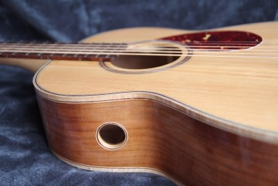

I just finished up a guitar that we are going to raffle off to support a fund we (the employees of my cancer center) run. the money we raise goes directly to help people who have been left in a financial bind due to their treatments. In an attempt to have something I could email out to the rest of the oncology division (to boost ticket sales) I asked a guy at a local shop to make a video. I pretty much just dropped it off, told him what it was made from, what it was for and asked him to pick some music that would highlight its strengths. The video is long so you can skip to the end to hear it. . .
This is a parlor guitar roughly the size of a martin size 1. I drew up all the plans myself and had some head-scratching with regards to bracing. The body is short (about 18 1/4 inches) so the 12 fret neck pushes the bridge back into the widest part of the lower bout, which I wanted but then I had to figure out how wide and where to put the X to maximize the use of such a small top. I also moved the soundhole closer to the heel in hopes to support more bass. This left a big space between the soundhole and bridge which made it hard to get the pickguard to look right and be in a position to do its job. One of the things I love about this hobby is how every decision affects something else.
I wanted to design a guitar that would be comfortable for a person who may be bed or recliner ridden. Another theme of this guitar was finding woods that were in need of rescue and giving them a second chance at new life.
top : Pine from the cull bin of the Home Depot. The board was twisted and cracked but there was s section of clear wood large enough for this guitar. I could tell by how it had split that it didn't really have any runnout so I gave it a chance. I resawed it and watched. It didn't move. I took it through several baking cycles; that bubbled a ton of resin out of it but it didn't move. I jointed it and watched. It didn't move. I thicknessed it and it felt really good. I kept expecting to have to throw it away but it kept passing the tests. . .
Back and sides : Cherry form our local urban log recycler
Neck : Maple. Years ago I bought craigslist table saw that belonged to the sellers deceased grandpa. it had a giant chunk of maple screwed to the fence as a sacrificial fence for dados. It sat in the corner for years until I realized I could squeeze a neck out of it if I cut it up just right.
Jatoba appointments : Old hardwood flooring

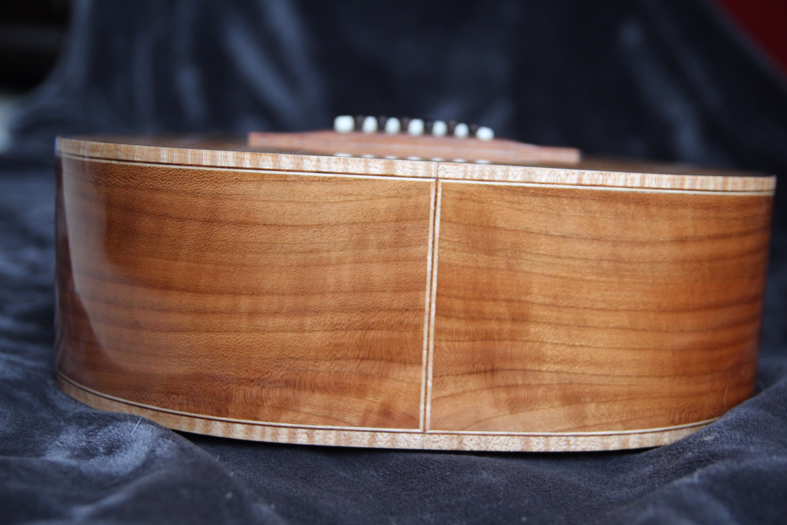

I knew I was forgetting something. . . this was my first time using Royal-Lac. Royal-Lac is a modified shellac that becomes resistant to alcohol and water after about a month. I figured that would be good since I have no control over who will end up with this guitar. I used normal blond dewaxed shellac for the first few base coats before starting the french polish. I'm not an expert by any means on french polish but I found it to be a fairly easy transition. It feels a bit thicker and stickier than normal shellac, I found myself using more olive oil than normal, but not a ton more. It built well and spirited off nicely. As it was building, it got a bit lumpier than I am used to. I usually don't sand during the FP process but I did some gentle leveling with sandpaper and olive oil. I think it may have been my inexperience with the product. After that I used more alcohol on the pad and it wasn't a problem moving forward.
I'd say I'm happy with the product. It looks good and should offer some extra protection from sweat. I don't like that it is made with denatured alcohol. I try to limit the nasty stuff that I breathe in and use everclear when I mix shellac.

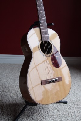

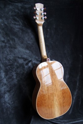

Here are a couple photos, I hope they display properly:

I'm quite impressed with the tone coming from that guitar! Nicely done.
Some very nice purfling and binding work also.

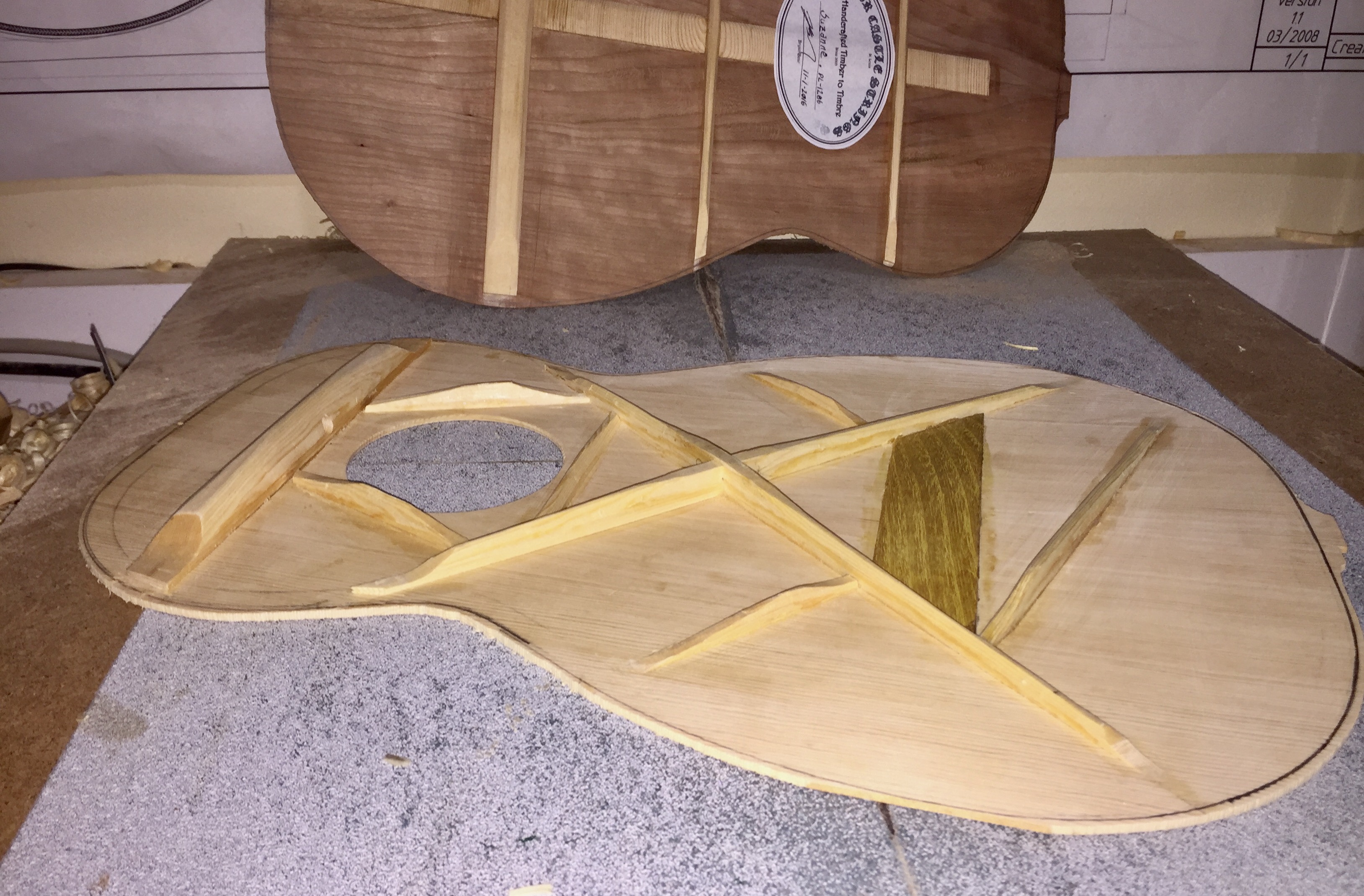

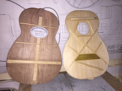

I'd like to see the relationship of the bridge plate to the x and other bracing. Do you have any construction pics?

Here is the best shot I have of the back and top bracing.
Here is the top pretty much final carve before I cleaned it all up. I don’t think I made any changes after this picture was take . The front corners of the bridge catch the x brace about 3/32” behind the front of the bridge plate. Bridge plate is osage orange just bigger than the bridge footprint.

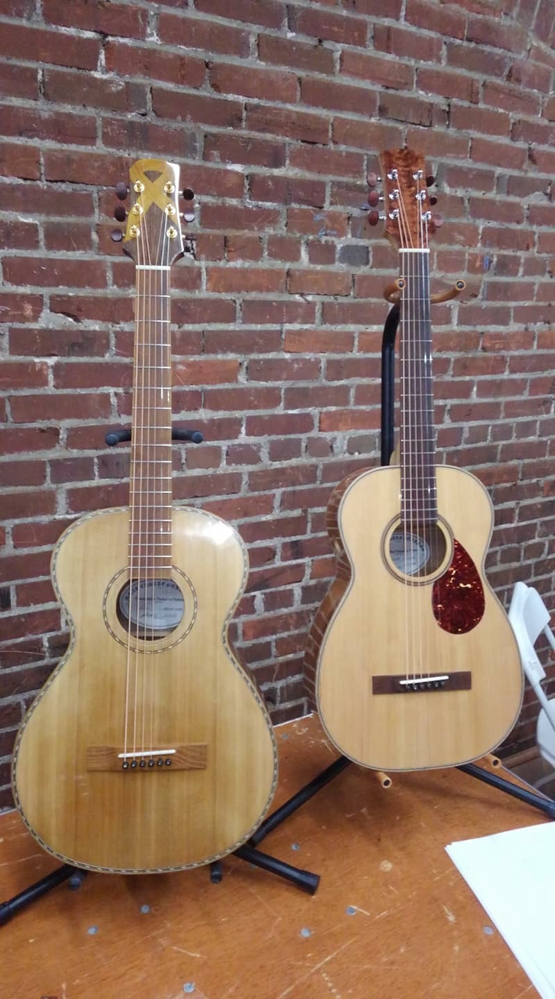

Re: My latest - a cherry parlor
Osage forced me to buy a new saw. I was using a 14” with woodslicer blades. They would cut 4 feet of 8” Osage before they dulled and could only be resharpened 3 times. I bought an 18” saw that could use carbide blades. Big difference. The wood I got this spring needs to dry quite a while longer before it will be instruments. That said, the wood is so hard to get and so hard to resaw, that I’ve been quite stingy about letting anyone else have it.
The pictured guitar is Cedar, Osage, and Sycamore. The look isn’t traditional, but it’s all domestice wood and it sounds pretty good.

Thanks for the pics Bryan. The bridge location looks more like a classical, but with steel string bracing. It sounds very nice.
