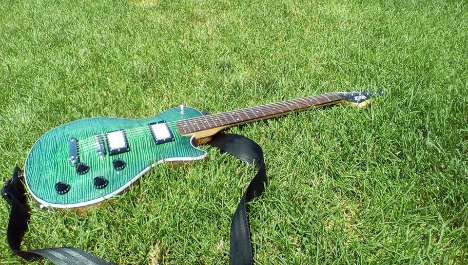

I have noticed that the availability of wood for drop tops is much greater (and a lot less expensive) than wood for carve top electric guitars. I am wondering if it would be possible to carve the top of a body blank like a regular carve top (Les Paul type, for example) and then use a drop top cap or a thinner veneer to cover the top. I have a vacuum press, and am wondering if it would work to glue the top to the carved body. Has anybody tried this? I am wondering how thin you would have to make the cap so that it would conform to the carved top, and if a vacuum press would work for this. I have considered that you might have to heat up the top cap with a silicone blanket and steam and use the vacuum press to bend it to shape and then glue it later. Just looking to see if anybody has done this before, and if they have any ideas, pointer, tips or advice. Thanks all.
- Posts: 640
Re: Using veneer or drop top wood to cap a carve top
You have to adjust the centerline seam so that it matches the contour without buckling. There is a video on YouTube that shows this well. I did it on the attached guitar picture

Eric, I took a look at that video. Very cool. Can you please give me some more detailed information. How thick was the piece you glued on? Was it an actual veneer or something thicker? How thick? Also you mentioned a frame around the body. Was that just so that the top would not get bent over the body base? Did you do any bending before hand or was this veneer so flexible that it just conformed from the vacuum? Thanks!
- Posts: 640
The piece I used was a standard unbacked veneer thickness as far as I could tell. around 1/32" thick I think (been a while). I made the frame to avoid breaking the veneer over the edge since it was an existing body. I put binding on to hide any imperfections there. I did not have to pre-bend anything, just sanded a bit of relief to account for the arch. I did a couple of test vacuum pulls on it to make sure that it was good before gluing it up.

Thanks, Eric. I also found some other videos on YouTube, where they show the process. I now see what you mean about the center seam.
