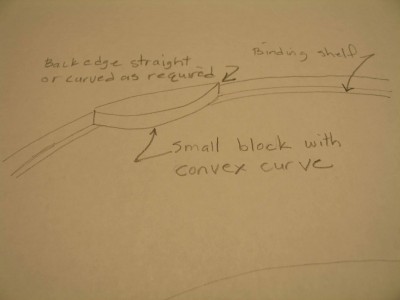

Paul, do you have a photo of the wooden block you use. I am having a hard time visualizing it.

Barry, I don't have any images but attached a PDF sketch, see if that helps.

OK...PDF is unaccepted file type. I had to start over and take a digital image of the sketch, couldn't legibly convert the scanned PDF to 150k or less. Hope this helps Barry, it took some unexpected effort to post this.

Thanks for going to the effort, Paul. I get it now.
