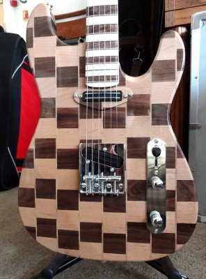

Matthew, I can't help you with the single coil switching, since I am the dumbest switch guy on the block. However, here is one of my versions of the Strat-Tele. I used rail type humbuckers in it.
The bridge is a tele rail, and the neck is a strat rail. The switch is an import type 8 lug 5-way. Here is the diagram I used for wiring (could be different color codes but easy to figure out.)
