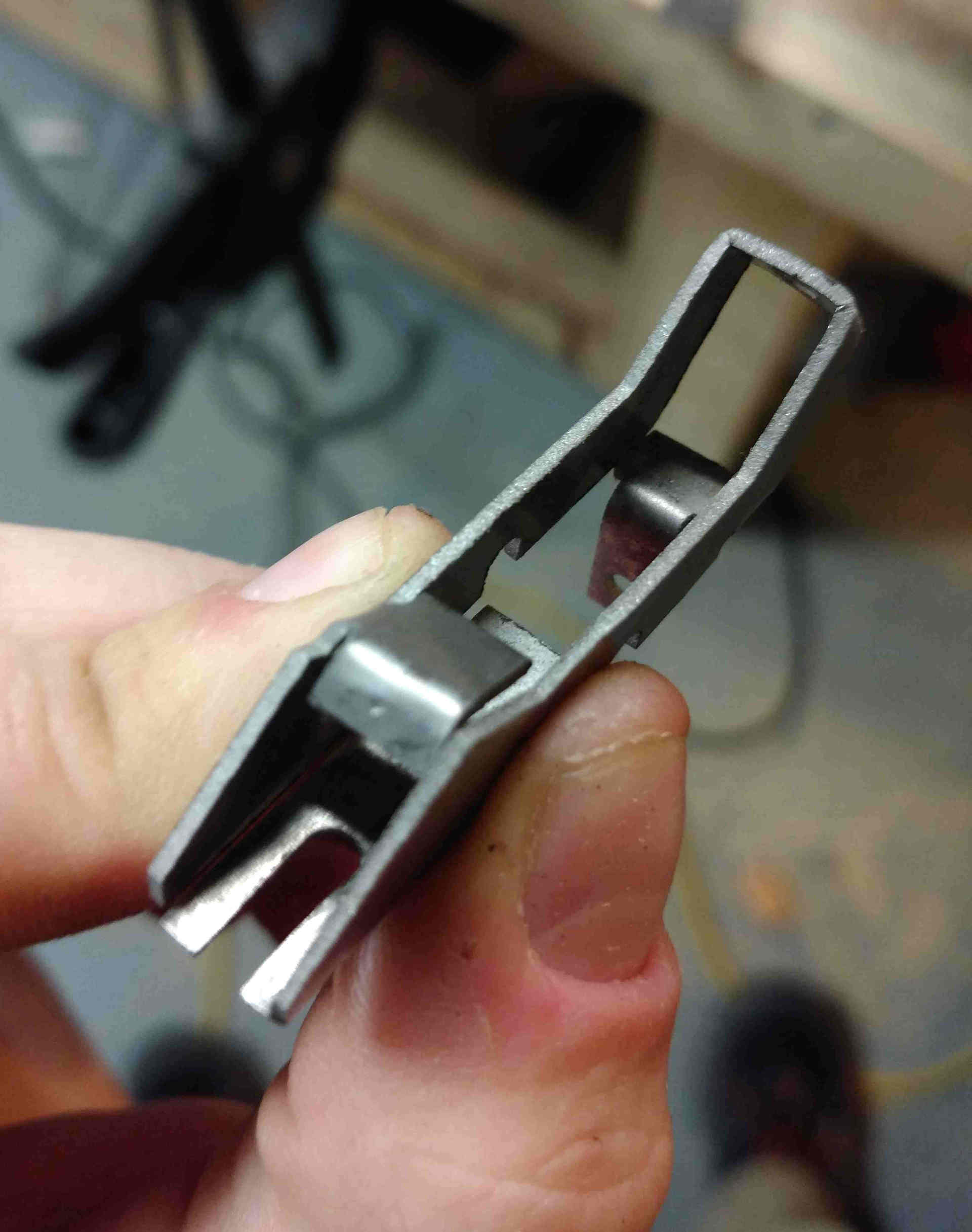

The first real issue was when two of the string saddles snapped at the pivot (look at images below). It is essentially impossible to find parts for this bridge, so after temporarily splinting them with some steel pin stock and epoxy, I made new saddles out of 1mm 4130 steel. I have access to a cnc mill, but my design required a tiny cutting kerf, so I had to have a shop water jet cut them for me. I then made a tiny sheet metal break that sat on my vise jaws, and bent them into shape. The photo is of just the test one, the ones on the guitar are much cleaner. All the holes were drilled and tapped prior to heat treating. For heat treatment, I hardened and tempered them to a little softer than what I normally make my knives. I then stuck them into a vibratory tumbler made out of a tupperware container screwed onto a sheet sander, along with ceramic media. This gave me a good surface to solder the saddles closed. At this point I remembered I needed to grind the divots at the top of the triangle that the strings rest in, so I ground each one to the correct height so the strings match the curvature of the neck. Then back into the tumbler for parkerization prep, which is the finish I settled on. After parking, I let them sit in some ATF I had lying around for the parked surface to absorb for corrosion resistance.

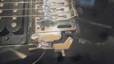

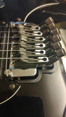

Ok, so here's where my question comes in: I'm not up to this point yet, but it bugs me that I don't have a whammy bar (vibrato, tremolo, whatever) to use with it if I ever want to. I called Yamaha, and they have long since lost nearly all information related to this guitar, including part drawings and details. I'm going to go to a guitar shop at some point to see if they have any arms that would fit this, but I'd still like to make one, as I'm sure you guys can understand.

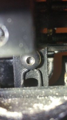

I have to measure it with a caliper, but it seems the hole is 6mm, and there is a small spring clip at the end of the hole, I'm assuming to grip a notch at the end of a whammy bar that pushes in.
1) Does anyone have any opinion on what material the arm should be made out of? It seems most are made out of steel, but I figure something lighter like aluminum would not flop around under its own weight as easily. If it doesn't matter, brass could look interesting. I can't see a way to change the friction at all like the screw collar arms can.
2) Is there any consensus on what the "best" whammy bar attachment system is? As in threaded, push-in with screw collar, the current simple push-in with spring retention, maybe magnetic, etc.? I'll most likely remake the bridge baseplate and block out of a better steel at some point, so I can also incorporate whatever arm I want to.

Nice work on the saddles. As far as the bar is concerned - it sort of looks like a Floyd arm and collar might work, these are available from lots of suppliers

Here's a bad photo of what I mean when I say "spring clip":
It's at the end of the bridge block hole. I took the photo through the back of the guitar, short of actually taking the bridge out to take a good photo and dealing with tuning again. So to sum up, the hole is smooth and goes through both the base plate and block, with a clip at the end that looks like it's for a notch on the bar.

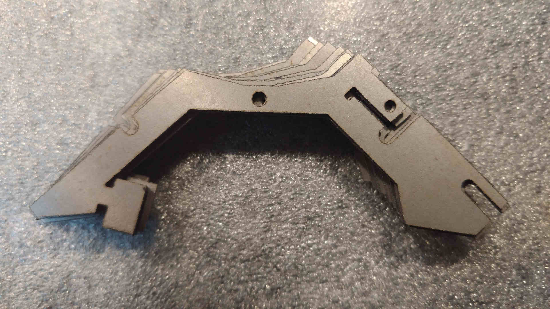

On the other hand, machining the base plate of something like a Kahler out of aluminum might make sense - it would certainly lighten it. Kahler does make their trems in a variety of different metals - steel, brass, aluminum, and some units use one metal for one part, something else for another. If you really wanted to be cool, how about machining your parts out of Titanium - you would get many of the strength benefits of steel with the lightness of aluminum (not to mention some gee-wiz factor). (I happen to ride a titanium bike and at one time considered building a titanium resonator guitar so I'm a bit smitten by Ti).
While you are thinking about the design of your trem, consider the problems of existing designs. Some of them bind as they go thru their motion - can you reduce or eliminate friction? Should the strings be able to move at the saddle break points, if so, should they be rollers? Are the saddles easy to adjust in both vertical and horizontal directions, do you have enough travel to correctly set both playing action and intonation? How about changing tension if you change string gauges or tunings - personally I think the whole No 2 wood screw/spring/claw assembly is just plain wrong. A really nice feature might be adjustable string spacing.... And going back to your very first question - how about an arm that is easy to remove, stays in the playing position without falling down, yet can be pushed back out of the way when you don't want it. And last, but maybe not least, a way to block the trem so it doesn't move for those of us who don't want it.
