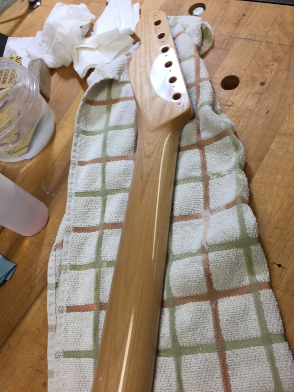

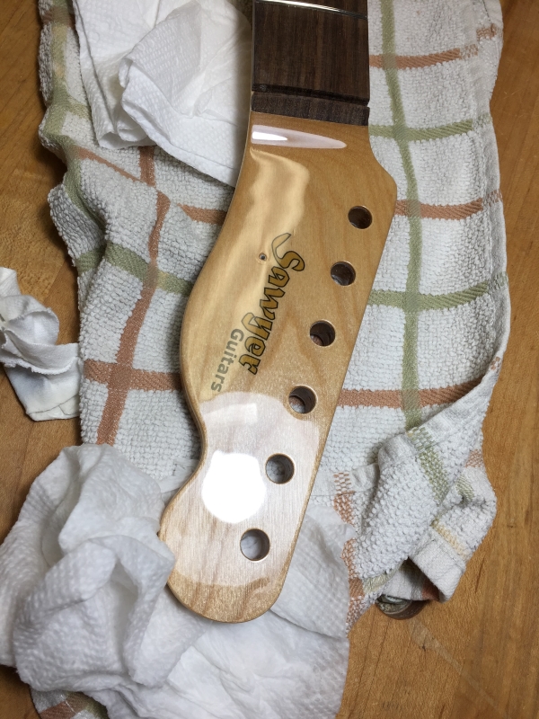

I finished the neck on my Tele build. Turned out absolutely gorgeous. I didn't sand-through anywhere, my sanding schedule worked just fine, and the polished lacquer looks like a mirror. Two tiny spots (one about 1/8" diameter, just behind the nut, one a little 1/4" x 1/8 spot on an edge of the headstock) ended up with a few scratches, and I was thinking of going back and hitting them with the 1200/1500/2000 and re-polishing, but to be honest, they're one of those things that I'd have to point out to someone to be noticeable.
However - bad news on the body.
I ran into a couple of minor problems when doing the neck which I attributed to contamination while progressing through the grits. A couple of times, on examination before progressing to the next grit, I could see some deeper scratches, and had to work on it a bit more to get it ready to progress to the next grit. This was all wet-sanding - 400/600/800/1200/1500/2000 before polishing with Meguiar's 105. With the experience of the neck behind me, I got real fussy when I went to work on the body.
Same schedule of grits, but I soaked the sandpaper overnight, and while working I was real careful to change the water I was using to dip the sandpaper into while working, so I wouldn't get grit contamination from the previous step. I also started each grit with a couple of fresh dry shop-towels to wipe off the surface, again so as to avoid carrying any grit from one step to the next. I also examined every square millimeter of the surface to verify that I saw a completely uniform scratch pattern before progressing to the next finer grit.
I spotted some dimples after block-sanding with the 400 that I drop-filled, and waited a week for it to cure fully before scraping flush with a razor blade. No sand-throughs and was careful, careful, careful to get that uniform scratch pattern before moving to the next grit.
Everything went well, until I started polishing, and was presented with fine scratches all over the body. It looks horrible.
So - what the hell did I do wrong, and where do I go from here?
I block-sanded with the 400 and 600 just like I did with the neck and headstock, and progressed through the same grits that I did with the neck (800/1200/1500/2000) using just my fingers. As I mentioned above, I was more fastidious in my work on the body than I was on the neck. I'm wondering if maybe I didn't clean the sanding residue off of the surface sufficiently before doing my visual examination. Perhaps some of the sanding swarf filled the scratches, making it LOOK like it was ready to go to the next grit, when in fact it needed more work. Then again, the neck is natural maple, but the body is clear coat over a color, so that may have caused a failure in the visual check.
As to getting myself out of this mess (once I have some idea how I messed up), my thinking is that I could back up and repeat the entire sanding process, but given that I've done this once, I'm really asking for a sand-through if I try to repeat it (I had 8 three-shot coats on it before I started sanding), so if I'm going to back up, I might as well do it right. We're going to have some sunny, dry, reasonably warm weather in the next week, and the humidity should be good. I'll get a couple more cans of lacquer (I've been using Behlen Stringed Instrument Lacquer), and lay down three or four additional coats.
If this is indeed a good option, what should I use to clean the surface of the existing finish? I've had water with dish-soap, sandpaper and Meguar's 105 all over this thing, and don't want to compromise the new lacquer coats.
Any thoughts on my recovery plans, and suggestions as to how I screwed this up are appreciated.

Barry - thanks. That sounds like that (starting with a too-coarse grit) was probably my mistake. The good news is I have a beautifully flat surface to work on at this point, so a couple of good wet coats should get me back on track.
I have this spiffy 3" random-orbit polisher from Griot's Garage that I was planning on using. However, I was a little afraid of it to be honest. I wasn't sure which of the foam pads that I got with it (it was a gift last Christmas) I should use, as I couldn't tell the difference as to their firmness (they all felt about the same to me) and don't know what the difference is as to the effect of the pads with a flat-face, vs. the ones with an egg-crate surface. I also don't know how much pressure to apply to get good cutting without burning through the finish. Also, to be honest, that foam doesn't seem like something I want to put on a guitar finish. I was thinking of figuring a way to affix a micro-fiber cloth to the pads which seems to to me to be a much better choice for polishing, but what do I know? Given that, I made a small (like 1 1/2" dia) polishing pad from some well-washed cotton (old t-shirts) similar to what you'd make for applying a french polish (damp paper shop towel in the middle, and wrapped tight with the cotton) and did the neck entirely by hand that way, so I continued to use that technique on the body.
Since I had nothing to lose, I experimented with some micro-mesh just to see how it compared to the polish, and started using micro fiber cloths to wipe off the surface. I realized that was probably a better approach than paper shop-towels, and was planning on using those on the next go-'round. Thanks for confirming that!
As to a backing pad, I'm using a very small block for block-sanding (about 1" x 3/4" x 3/4") and sanding in an overlapping circular pattern. Would you recommend sticking with a similar sized felt or rubber pad when working through the grits? I want to be able to sand right up to, but not over the edges to avoid sanding through. Using very small squares of sandpaper and working like this worked very well on the neck. Also, if I use a felt pad, am I correct that I should use a different pad for each grit so I don't inadvertently transfer an errant piece of coarser grit when switching to a finer grit?

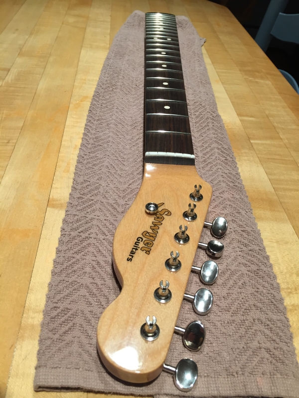

As you can see below, the neck came out great. Now I just need to get the body to match!!
