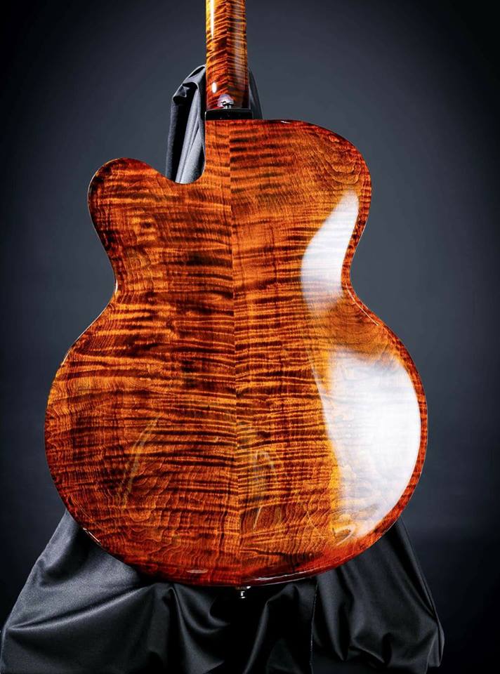

I am doing an electric solid body with a curly maple top. I saw an awesome finish on a beautiful Robert de la Garza archtop (picture attached) and want to do something similar. I tried contacting Mr. de la Garza, and he did respond, but I don't think his English is that good, because his responses were very short and not detailed. He said the finish he used was nitro, and he "activates" the curl before he applies finish. I asked him if he dyes the maple with black stain first, and he said yes, but I would like more detail. Has anybody done something similar and can you give some detailed explanation on how you did it. I will be using some kind of waterborne finish. Thanks.

The picture doesn't show up. This may be a dye and sand-back type of finish.

Sorry, didn't follow the correct procedure for adding a picture. I think I got it right now. Thanks.
Here is the picture of the back.

No way of being sure, but most likely a black or mission brown (or combo) transtint dye applied directly to the bare wood. You apply it dissolved in either alcohol or water, but I prefer alcohol. Wipe it on VERY dark. Let sit and then sand back. Sand until the surface is not tinted and only the figure has tint. It will look ugly until you apply the garnet shellac or a tinted amber base coat of nitro. That is when it really pops. It also pops odd swirls or defects, so make sure the wood is really clear.
Of course, practice on scrap first.

The finish in the photo not only has the stain process described by Randolph, but also includes a sunburst of amber/red that was sprayed on in the top coats.

I am not seeing the sunburst at all. Maybe I am not as attuned to that, though. I am find with not as much chatoyance. I will probably give it a try, and will post pictures of the results. Thanks for all the great advice folks!

The sunburst is subtle but it's definitely there. It is most obvious on the heel of the neck.
- Posts: 257
Re: Advice on getting dark curly maple to pop
I see that now. Wow, good call. Thanks for all your responses, Barry. Do you think the initial stain is black or a dark brown? The top of the guitar is black, and he said black, but it looks more brown to me.

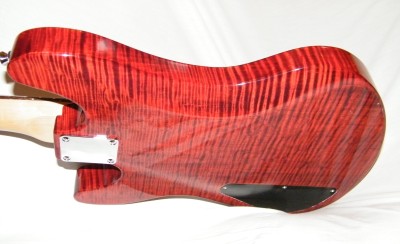

On one of my guitars I used black first, and then red second. After the clear coats it really popped, and had that beautiful 3D look.

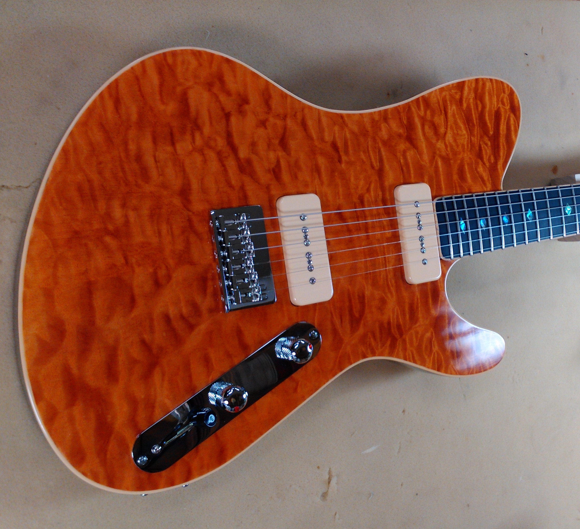

On another guitar, this one with quilted maple, I simply used a custom color stain before clear coats.
Both have their own beauty. It is quite hard to get a good picture of this one. It is actually more gold than it appears in this picture.
