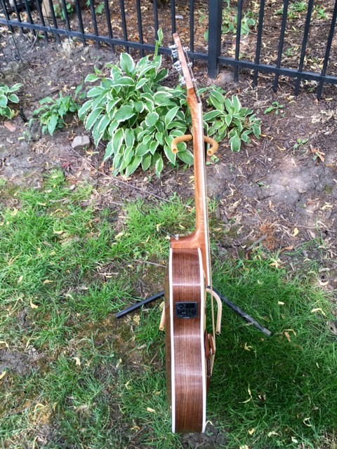

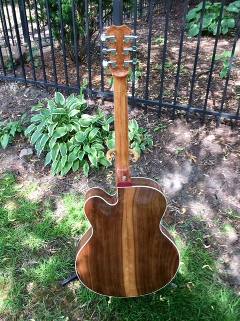

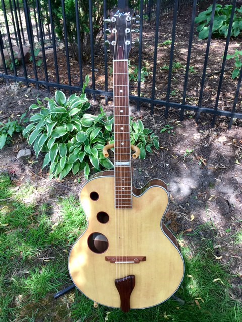

I built this guitar for my brother. It's a 16" lower bout and the body is 19.5” long 25” scale. Sitka top...walnut back and sides with a mahogany neck. It's the loudest archtop guitar I've built. The sound just jumps out of it. Has excellent tone... and gorgeous ringing sustain. When I first strung it up… I was thrilled and knew my brother was going to love it (I surprised him with it).
It's a working musician’s guitar... ABS binding with a K&K pickup and an on-board preamp in the side bout. X-Braced with a bolt on neck. I had bent the sides and set them aside during my last build... and the top was just some extra Sitka Spruce I had laying around. It's nothing fancy for sure. I also had cut an extra tailpiece on my CNC when I had the setup loaded... so it's a little of this and that. The Bridge is an adjustable configuration with a bone saddle.
I get a lot of comments about the sound holes…good and bad. It really seems to open up the guitar. My brother is a working musician playing in bars and clubs around the area. He really needed a new axe as his Martin was really starting to show it's age... having years of bar work... summer festivals, airplanes, pickup trucks etc. This archtop was created with that environment in mind. He has been playing it for several weeks... and said feedback has not been an issue and can dial it out with the preamp.

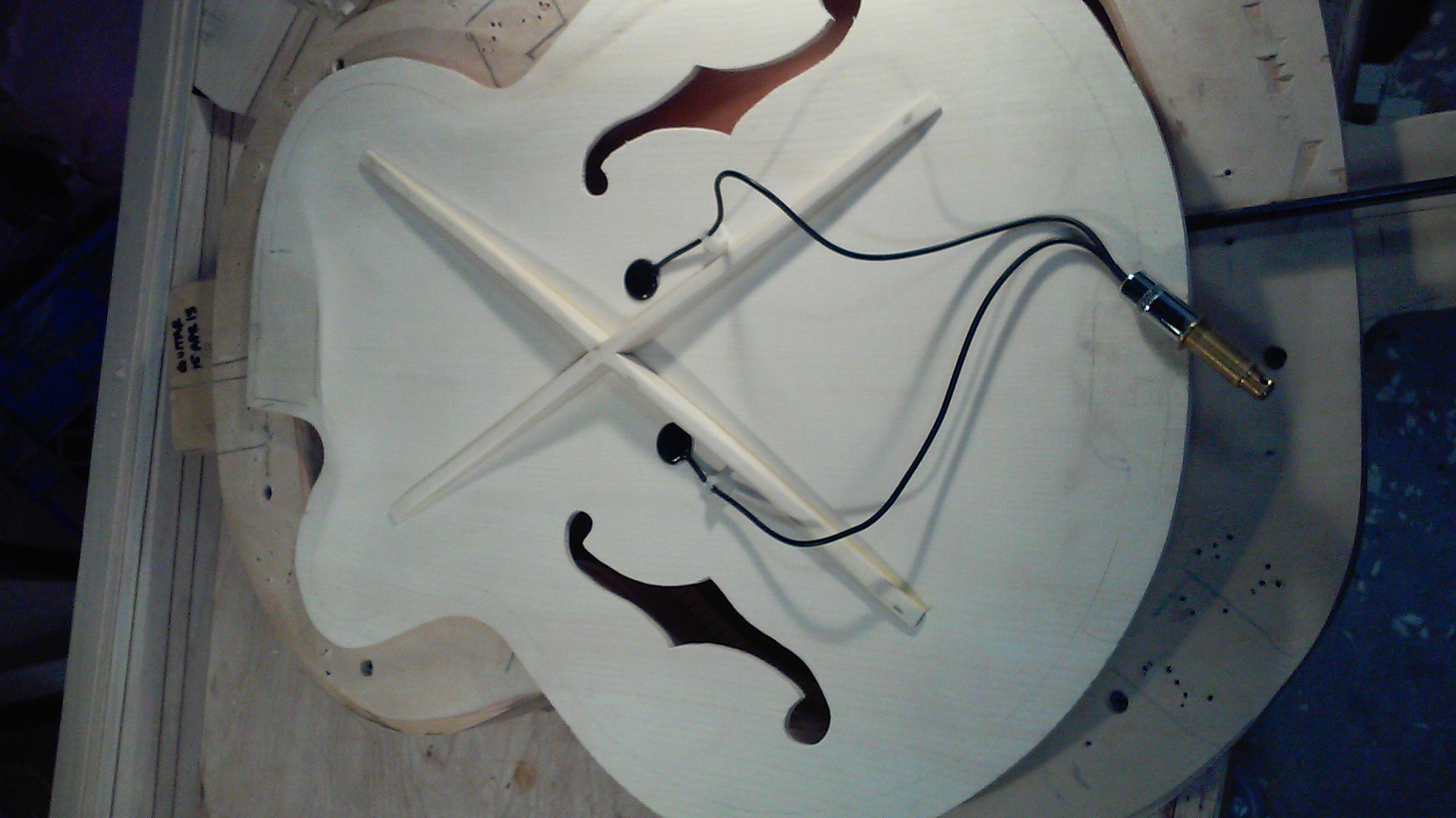

Only issue is the pickup output is a little low (even with the preamp). I really want to find a better solution for an archtop. I love the K&K's... (glued to the underside of the sound board), These pickups are not made specifically for archtops… but they work and have a really great natural sound... but with the bridge setup... and the top... the output is down slightly. I've tried several of the higher output type...glued in around the f-holes (Twinspot)... and while the sound output is good... I find the pickup has way too much ancillary body noise. They also feedback too much. I really want a design under the bridge without all those wires running across the top (the under-bridge design specified for archtops). I’m going to try and contact a few of the manufactures to see if they have any ideas. I really dislike the pickups jammed under the bridge with wires running across the soundboard. As a builder… I just can’t support that look… Something I need to keep working out.

The archtops I build are most definitely meant as an acoustic instrument. When strung up with nylon strings, the K7K/JJB piezo's are just about the only choice unless I want to go with the RMC madness. However, for players who play mostly steel strings I have had to concede a magnetic pickup. I just cannot get a reasonable sound with the piezo's alone.
For magnetic pickups, I am blown away by the sound and quality of Pete Biltoff's pickups. He will customize for a reasonable price. The Vintage Vibe Charlie Christian is magic. I hate having two jacks on the rim of the guitar, so I've been exploring what to do with the signal chain when I have both the piezo and mag on the guitar. Wiring to a stereo jack and then using a "Y" plug that splits a TRS plug into two TR jacks seems to be the obvious choice. That keeps the guitar clean, but puts the onus on the player to deal with the signal.
The piezo then can be sent to a preamp and the signal recombined at mixing pedal. That't lots of extra gear just for your guitar, but placing all that onboard feels like a step too far.

I'm getting output equivalent to a magnetic pickup using JJB 220 piezo's (essentially the same as K&K) mounted in my X-braced 16" archtop and 14.5" octave mandolins as shown:
The JJB is encapsulated somehow and gives a nice warm tone glued directly to the top plate using gel superglue (without the K&K recommended 3M tape). The treble transducer is just in front of the treble bridge post, and the bass tranducer is about 3/4" ahead of the bass bridge post.
For dual magnetic/acoustic builds I am using either a Vintage Vibe neck mounted humbucker or a full size top mounted humbucker wired to the tip stereo endpin connection, and the JJB to the ring connection. A 1/4" stereo cable to a Radial Tonebone allows for buffering and blending. The volume settings I am using are essentially identical, so the pickup outputs are likely identical also.
The location of the piezo transducers have a big effect on the output and tone. The usual installation through the f-holes on a completed instrument tends to be just inside the f-holes, which yields a "tubbier" sound and significantly less volume.
