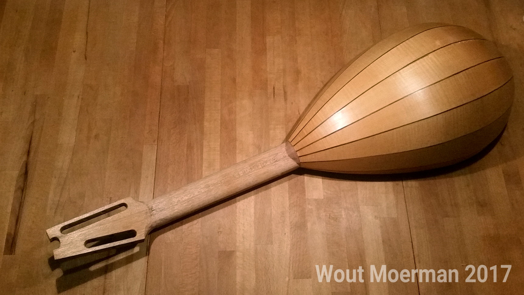

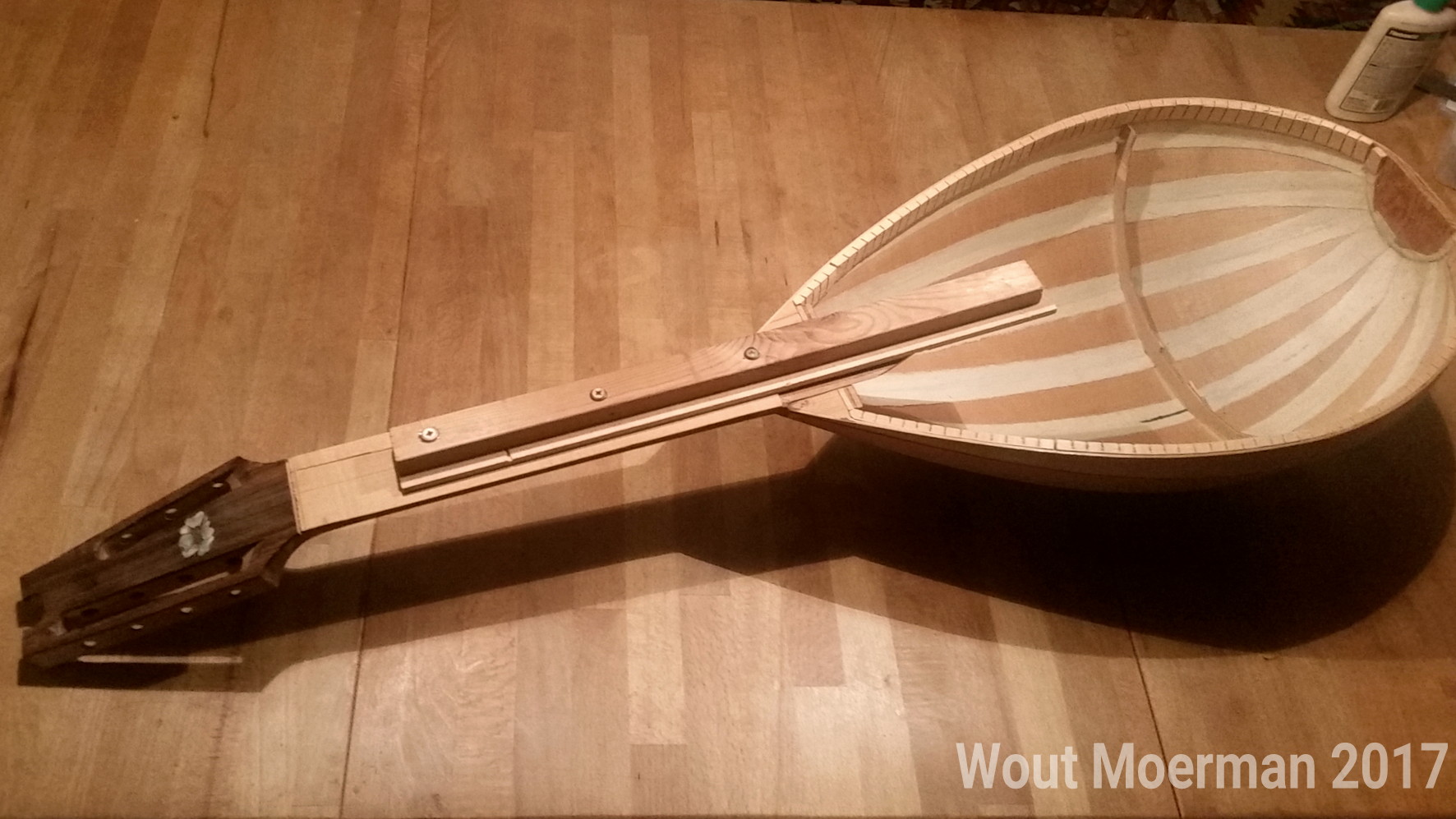

I am a bit hesitant to post pictures because of the flaws in the construction. But maybe it won't show... Biggest problem is that I have built the bowl in free air and the ribs weren't glued perfectly 'flat' to each other. In de wanding process I tried to even things out and in some places I just sanded through the 2 mm ribs. Luckely the glue joints were internally backed by strips of linnen cloth so the integrety wasn't lost.

Here are two pics of the lute guitar. The block of wood attached to the neck is to secure it in the vice.
Re: Bracing suggestions for experimental lute guitar
I wonder how it would sound if you glued in a flat "inner back" to give it more of the characteristics of a guitar body? You might want to give it a sound port to allow it to move more freely between the curved "outer back" and the soundboard.
