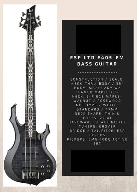

I followed the links shared with me in a previous post but could not find the parts I was for the following guitar. It is an ESP LTD F-405-FM. Where can I find replacement electronics, the nut definitely needs to be replaced as it was filed to much to compensate for the previous owners strings, and the bridge. I will post a pic just to show the specs.
I can't find parts for this guitar...

When you say "electronics" do you mean the Pre amp or the pickups and preamp. I just did a google search and the pick ups are available (from Jet.com of all places) but it looks like they don't have the 3 band EQ (I'm assuming the pre amp is volume, blend plus 3 bands). It looks like that is available from EMG as are the pick ups.

If the pickups are EMG 40DCs you can buy those from about any EMG dealer. Start looking on eBay for better prices. The active electronics isn't listed in the specs but one would expect them to also be from EMG, possibly their BTC or BTS.
Most parts on most basses can be replaced with generic parts although one might have to drill new holes to mount a different bridge. ESP LTD 400 series guitars are made in Indonesia but most of their parts are likely to be Korean . That same bridge will turn up on dozens of other off-brand guitars and is probably available on eBay as well.

Thank you all for the helpful information. Stew-Mac was the first place I looked but couldn't find the bridge or the electronics. The reason I want new electronics is simply to have a back-up set. The reason I want another bridge is because the one I have on there now has blemishes from being left in the damp cold I suppose. The guitar shows obvious signs of neglect and I want to do the best I can to restore it's original beauty.

A quick search on line reveals that the bass comes with an "ESP BB605" bridge. Someone on talkbass reported that the back of their bass's bridge was printed "sungil bb105" which is the Korean manufacturer's name and model number. A search for that yielded this: https://reverb.com/item/746833-sung-il- ... -105-black
The string spacing is reportedly 17mm, you might check that with a ruler to confirm. This is bottom of the barrel hardware but if it works and sounds OK so be it.
You'll need to pop the control cavity cover off the back to confirm what the electronics are. This is such a low budget bass that I have some doubts they put an actual EMG preamp in there. Here are the likely candidates for comparison if it is a domestically produced EMG preamp:
http://www.emgpickups.com/accessories/b ... ntrol.html
http://www.emgpickups.com/accessories/b ... ystem.html
EMG might have also designed the preamp for offshore production to save money. There are dozens of Korean companies that produce the high volume import lines and it's often very difficult to track back to the OEM without some better clues
