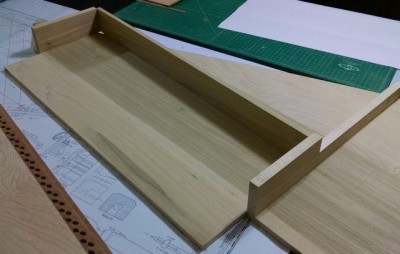

Here is the baseboard. It is poplar, about 0.5" (12.5mm) thick. The bentside (on the right) still needs to be trimmed. Barnes recommends waiting until the case is ready to be assembled before trimming it (the baseboard) to match the actual bent side. The long edge (back) is about 1.7m or 68" long. The long rectangle in the front is where the keys will be.

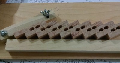

I'm working on the jack guides and doing it a little different than the book. The jack guides are built up from a pattern of notches in the wood, then the wood is cut into the individual blocks (we need 29 of them). In the book, the notch borders are cut with a handsaw and then they are chiseled out to make the grooves. I'm going to use a tablesaw instead.
So here is a photo of the notches cut in some cherry that has been planed to a thickness of 12.3 mm. If I had a wider piece of cherry, I could have repeated the pattern horizontally. After the notches are all cut, the length is cut into 29 mm long blocks. Next, a little jig is made to hold the blocks (now standing on edge). You can see that the notches on the back side line up with the notches on the top to create the jack guide. The angle (nominally 26.5 degrees) will vary slightly depending on the actual thickness of the cut. We need the octave span to be about 165 mm. Here's a group glued up. I glued up 7 - 9 pieces at a time, then glued them all together. Next I need to cut off the top and bottom so we have a flat surface to glue to the wrestplank.

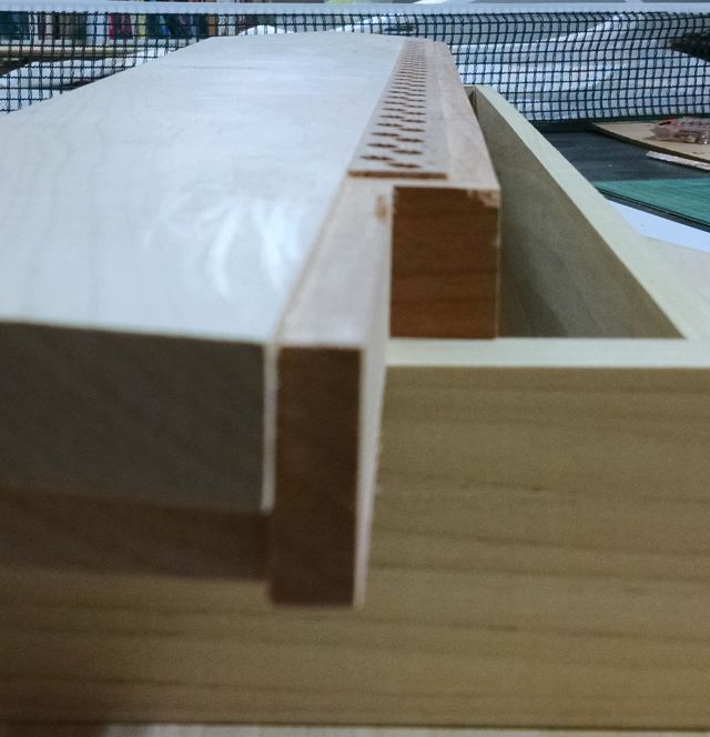

Jack guide with edges trimmed off, just about ready to be mounted to the wrestplank
And glued to the wrest plank. The bass & treble ends have been squared off and a slight (2 degree) bevel was added to allow the jacks to move easily in the guides. The top surface of the guide is planed smooth with the top of the wrestplank. - Eric Knapp

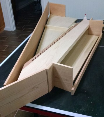

I added the soundboard liners around the jack guide/wrestplank assembly- this is where the soundboard will attach to the jack guides. Sort of like kerfing on a guitar except it's not kerfed and it is a bit lower than the guides (so that the top of the soundboard will be flush with the guides and wrestplank). Per the drawing, the soundboard is 1.55 to 1.75 mm thick along this edge.
Next I cut the baseboard liners and put them in position (but not glued down yet).
Then here are a couple photos of the wrestplank assembly sitting in its place. I still have to add a couple spacer strips between the wrestplank and baseboard.
I need to read a little further ahead before I glue things down here- there are still some things shown on the drawing that I don't get yet.- Charlie Schultz

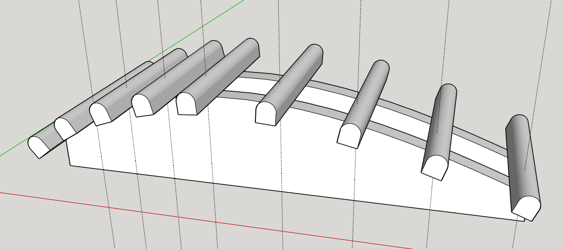

Some questions for anyone that might know...
There are a couple of "sloping" shelves shown on the drawing, but I cannot find any reference to them in the booklet. I'm not sure what their purpose is. The first is shown in the following drawing- the sloped wedge on the right baseboard liner, presumably right in front of the wrestplank assembly. The second "sloping" shelf looks to be the horizontal baseboard liner shown in the drawing below. Now, it does slope left to right, but the booklet clearly says this liner is glued down but the plan notes that it is just nailed. So perhaps just the top is sloped? Or I'm just misinterpreting?

One of the folks over on the hpschd-l mailer clued me in. There is another thin board that slopes upward from the baseboard liner to the back of the wrestplank assembly and it basically encloses the keyboard area. He also pointed out that you can see a small portion of it (now that I know what to look for) in one of the photos on John Barnes' web site.

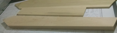

I got the case pieces all planed to thickness and at least rough cut. Here's about how they go: Per the book, I'm starting to fit them from the front, winding up with the long back piece being the last to install. Here is the detail on one of the sides that goes next to the keyboard: You can see a rabbet along the bottom edge- there is a long, thin piece of spruce that goes from the front to the back of the keywell for reinforcement. I think the historically correct way was to not rabbet the piece, but instead add a veneer (pecan) the same thickness as the spruce strip.
So I got the left side cut to proper lengths and mitered and I started on the right side- got the first two pieces done ok but now it was time to add the curved piece (which has been sitting in the bending jig all this time). Unfortunately, the bend did not come out well enough. 90% of it fit well, but the last 10% (the end nearest the keyboard) was significantly under bent. Not sure yet what I did wrong, but I steamed it last night and put it back in the jig- we'll see tonight if it's any better.
