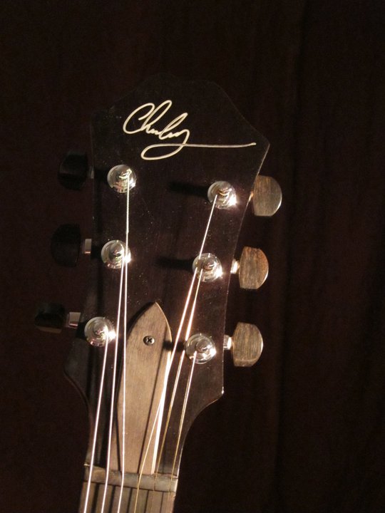

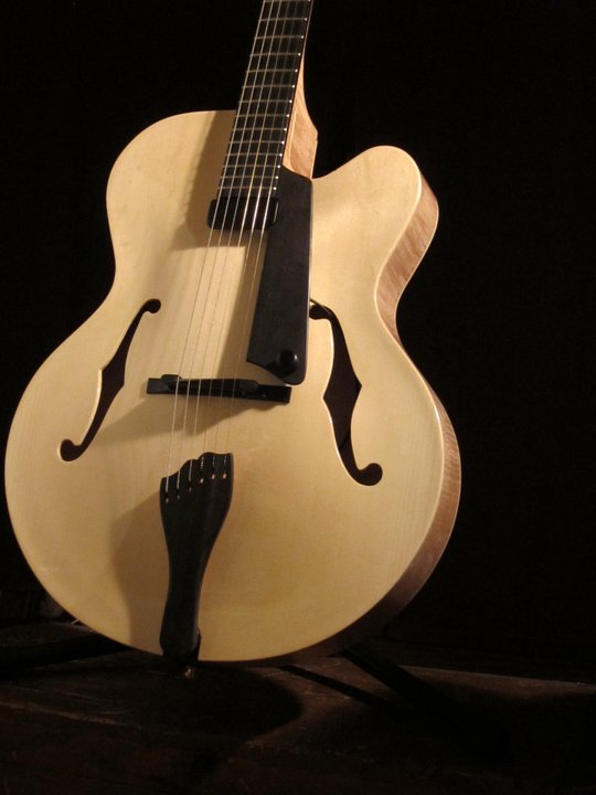

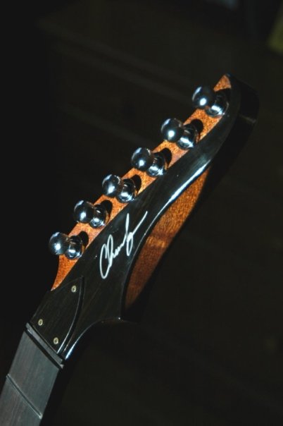

It was a really nice way to spend a week and I have an excellent guitar from it. I posted it on the forum but here it is again:

Beautiful guitar. how did you do the headstock signature? Was it an inlay you Dremel'd in? Decal? It seems a very thin line for the signature (again, beautiful but thin). String rope?

My naivete (novice-ness?) is showing. Barry, do you mean it looks like he used a Sharpie, signed it, then lacquered over it? Man, that would save me a ton of time screwing with decals.
Jeff, if you did it differently, please chime in.

Beautiful guitar, i like the tailpiece design, and the clean look without binding.

It is sharpie. I've been doing it this way for about six or seven years now. When I have enough coats of lacquer on the instrument to sand level and polish, I sand the peghead down to about 320 or 400 grit and then sign it with silver Sharpie. This leaves enough tooth on the surface for the Sharpie to grip the surface. Then put two or three more coats over it and finish it out. Looks cool and so far it has held up well. If I were to start building for other people I might go back to pearl.

Since I seem to be the leading authority on signing headstocks with sharpies let me throw out one bit of advice based on my vast experience.
Buy a handful of Sharpies and try them out. They vary quite a bit as to the line thickness. I like the ones about in the middle of the spectrum. The softest ones make a very dense line but they are hard to control and you can't tail off to a fine line. The hardest make a thin streaky line.
I should write a book.
