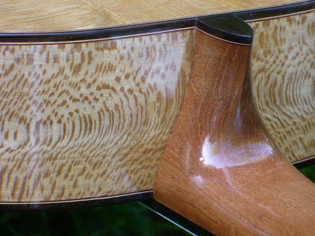

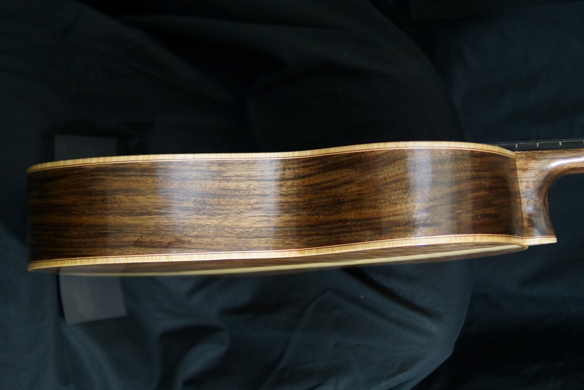

How glossy do you want it? I was always able to get it to a pretty good gloss right out of the bottle. I wipe on, very thin with no wiping off, then let dry a few hours, lightly sand back, then re-coat. No more than 3 to 4 coats a day. Build for a few days then wet sand back with Micro Mesh. Finish up with Meguire's Swirl Remover and then Show Car Glaze.

That's nice looking Waddy! That is as good as I have seen a Tru-oil finish.

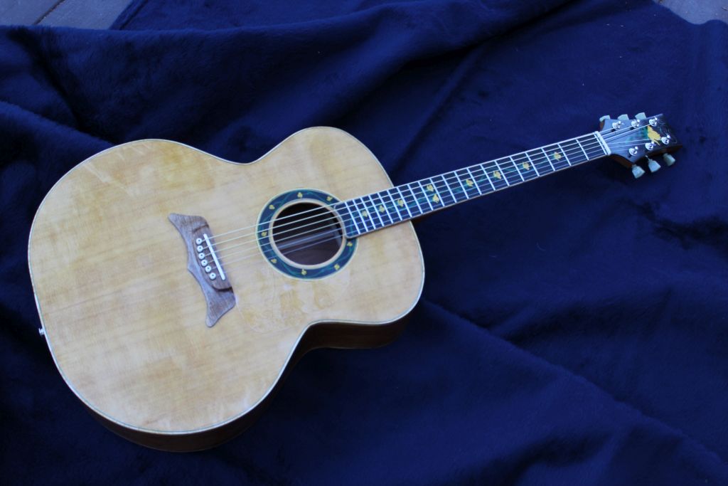

Is that the sycamore that bent itself into a guitar?

Those are the ones. I might mention, that I did not use the Tru-Oil to fill the pores on the Walnut guitar. No pores on the Sycamore. Using the Tru-Oil to fill the pores takes more coats and more aggressive sanding back on the early coats.

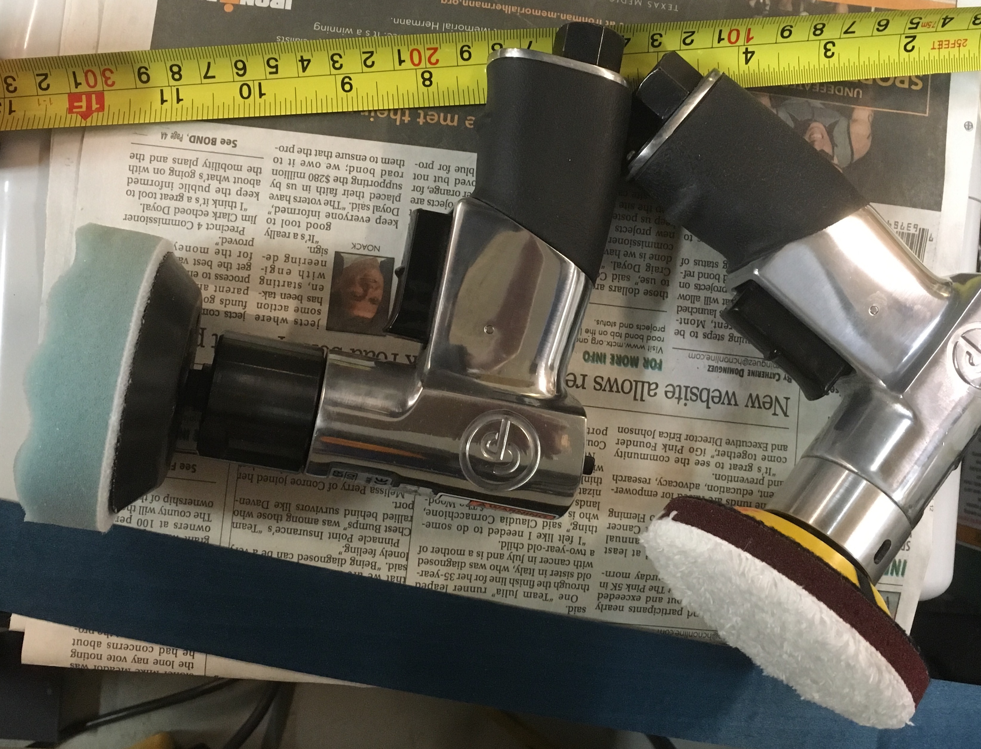

What sort of buffer do you use?Barry Daniels wrote:Buffing by hand is difficult to get a high gloss. What type of buff and compound are you using?

I am now using two pneumatic mini buffers. I have both a random orbital and a rotary. Different compounds like one or the other. The microfiber pad works great for Meguiar's 105 compound and the soft blue foam pad is used with 3M finishing compound.
