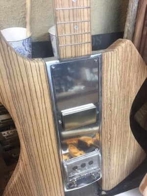

here is a detail of the instrument before the wooden side panels are attached(via the dovetail along the length of the guitar) it has a purpleheartwood fret board resin bonded directly to the cast aluminum body and i cast my own bridges, my guitar company is called deadman guitar

Re: total noob question about single pick up for bass guitar wiring
The capacitor goes between the tone pot's middle lug and ground, so you can ground it wherever it's easiest - soldered to a pot casing, or the volume pot's 3rd lug which is grounded (usually bent back and soldered to its pot's casing), or any other ground point.
I was assuming the whole body was going to be metal, but if your electronics are in a cavity in a wooden wing, you will need a ground wire/electrical connection from the electronics to the metal where the pickup and bridge are mounted. It might be easiest just to wire it the way it is in the Seymour Duncan diagram. In any case, the bridge needs to be grounded to ground the strings.

and yes the body that houses the pickups and the control knobs is all metal(im mounting the control knobs and input jack along the tail of the instrument) so youre right, i can ground anywhere that is convenient, same for the bridge which mounts directly to a metal surface as well! i will post updates when the first played is done! thanks!
