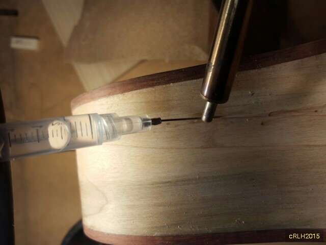

Hello, sometimes one finds a small dent or crease in a place that the eye might notice instantly. e. g. the side of the upper bout.
Here's what I did to limit the effects of steam treatment.

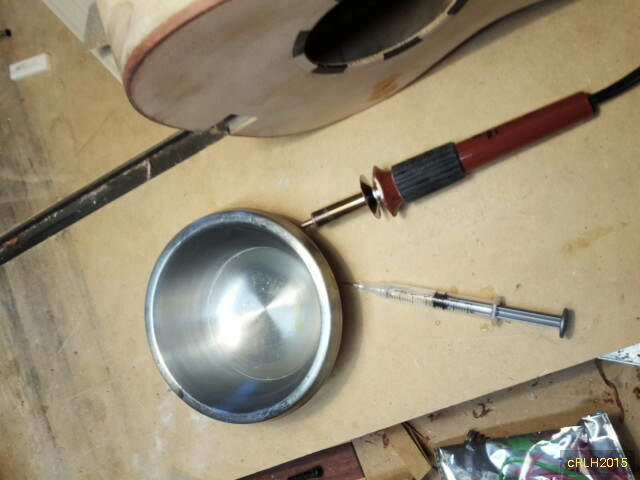

Fill a syringe with water from the catfood bowl. Place the
blunted needle, and then use a woodburner iron to boil the water in the needle, so as to direct the steam.
Choose a needle gauge that fits the need.
