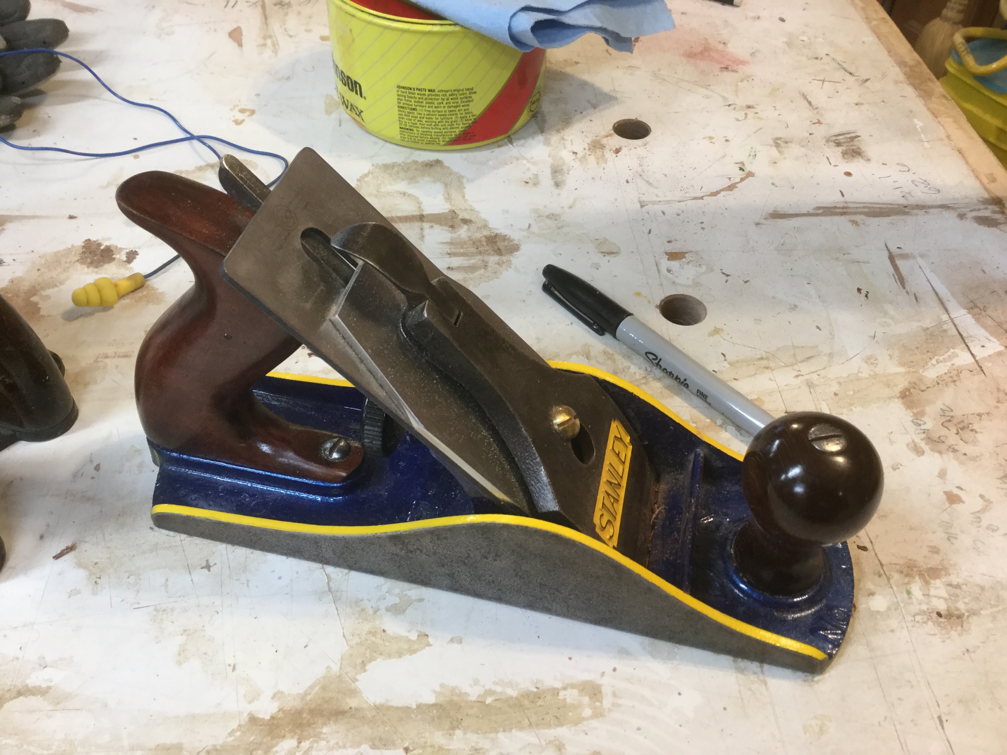

I have 3 planes for use in flattening:
1: Stanley Bailey #4
2: Stanley Bailey # 4 1/2
3: Stanley #62 smoothing plane.
I've refurbished the Bailey planes and tuned them by flattening the base and sharpening the blades to 30-degrees. I also flattened and polished the backs of the Lever caps. I'm not sure if I relieved the corners of these blades enough. I have used the # 4 with an oem blade/lever cap but have purchased a Hock blade and cap for the #4 1/2.
The # 62 came with a pre-sharpened blade, but I did a little work on the corners (not sure it was enough, but this plane gets a nice full shaving). I flattened the uke sides with this plane and it worked well.
The workspace I use is in a distant garage. So, I went to the garage last night to plane my Uke lumber. Unfortunately, I left my # 62 at home, so tried using the Baileys. When I used the #4, I wasn't able to get the blade adjusted so that I got a shaving all across the blade. I either got a shaving on the right or on the left, but never a really good full shaving.
So I put that plane away and started using the 4 1/2. The Hock blade was very sharp, so all I did was take a couple swipes on the corners using a 1200 grit stone. Then I installed it in my 4 1/2 and proceeded with planing. I got the same results: Adjust as I would, the blade wouldn't cut a shaving full across the blade. Adjust one way and got a corner shaving, adjust the other way, same result, different corner.
I'm not sure whether I should relieve the blade corners aggressively or very gently and very little.
The #62 is going to be my plane of choice for smoothing, but I am curious about what I might have to do with the other two planes to get them to work the way they should.
Is there something I should do with the frogs, or is the issue with relieving the corners?
Any input would be appreciated. Thanks.

I'm far from an expert on the finer points of hand plane use but am learning. You flattened the sole of the two smoothers, did you do any work on the frog surfaces or have you adjusted the frog position? You should be able to get the lateral adjust set fairly easily, at least not have only cutting on one side or the other. I can't really say what the problem might be, but that won't stop me from guessing anyway:
1) If you are using the lateral adjustment lever and ending up too far right or left (having trouble getting a fine adjustment), it may be that you have the lever cap too tight. It should be tight enough to keep the blade from moving in use but loose enough to allow fairly easy adjustment for depth and side to side. the lever should close with a nice snap but not be hard to close.
2) Is the frog bearing surface and back of the blade relatively smooth? I could see how that might make the adjustments more coarse.
3) Check to make sure the frogs are aligned properly with the mouth opening.

It can take some time to get the hang of adjusting a plane. Usually there's some backlash in the adjustments; a small movement on the lever doesn't do anything, and a little bit more does too much.
I grind one of my plane irons flat with the corners broken back, so that it can be used for either joining or smoothing. Sometimes it's hard to avoid catching a corner when smoothing. This is particularly true if the iron is not REALLY SHARP; the center gets a bit dull, and you can't take a fine enough shaving to avoid having the set deep enough to catch a corner.
If you've got more than one plane of similar size it can help to grind one for smoothing. The iron has an arc all the way across so that it makes a slightly fluted cut. You won't catch the corners in most cases, and can flatten up the surface with a scraper.

You mentioned that your workspace was in a distant garage.
How's the weather there? How fast does it change with respect to temperature and humidity, such that the wood would move?
Do you have scrap lumber to do some testing and adjustment, before you work the more precious stuff?
By the way:
"....I've refurbished the Bailey planes and tuned them by flattening the base and sharpening the blades to 30-degrees. I also flattened and polished the backs of the Lever caps."
Do I misunderstad something of the terminology? For the Nos. 4 & 4-1/2, there are three parts for the blade assembly: 1) the blade, 2) the chipbreaker that is held tight to the blade with a screw and supports it, and 3) the cap iron with the cam-lever that holds the blade/chipbreaker assembly tight to the frog. In the 62, there is no chipbreaker that supports the blade. There is only a cap iron that has a screw that holds the blade down upon the fixed bed (frog) of the casting.

I've thought of something else. When setting the blade, it's very important that the parts move smoothly -- otherwise they'll 'go out of adjustment' within a stroke or three.
Assuming that the frog is set correctly with respect to the mouth of the body, then the planar surface of the frog must be flat and smooth, so as to allow the blade/chipbreaker to slide easily to adjust depth of cut. The frog supports the blade, but it should not resist the 'pushback' of the cutting stroke - that's the job of the nub of the adjuster mechanism (and lateral adjuster lever). A bit of lubrication between the frog and blade might help. Also the cap iron (that holds the blade/chipbreader down upon the frog) must be snug and yet allow a smooth movement.
Try some lubrication between these parts, and don't overtighten them.

High humidity here. Came from desert in mid May.Bob Hammond wrote:You mentioned that your workspace was in a distant garage.
By the way:
Yes, I have scrap lumber and have been testing before I start working on the expensive stuff. I continue to learn more and more about sharpening plane irons and now, after 30+ years, I'm showing some progress.
On terminology, thanks for asking. I must have been tired: On my Bailey 4 1/2, I have not had to do anything to the lever cap. I flattened and sharpened the chip breaker . The angle was probably 45 degrees and I found it easier to hand sharpen than to use my Veritas guide. I also decided to hand sharpen the Hock blade and did a pretty good job. I chamfered it just a bit and that really helped.
I've had better luck with the #4 1/2 than the # 62 on this go-round. I worked on the 4 1/2 a lot just because of the challenge. Now it seems to be doing a better job than the # 62. Tomorrow, I'll play with the # 62 to see if I can improve its performance.

I took a close look at the frog on the # 4 1/2 and found it to be slightly off. I adjusted it just a bit, eased the cap iron screw by a "schosh" and that was a big help.Bob Hammond wrote:I've thought of something else. When setting the blade, it's very important that the parts move smoothly -- otherwise they'll 'go out of adjustment' within a stroke or three.
I'm now getting better results with the # 4 1/2. The # 62, bevel up, device is still a bit of a mystery.

Yep, after I sharpened the # 4 1/2 and did some other "tuning", I eased up on both the lateral adjustment and the blade extension and things are going better. ThanxBryan Bear wrote:I'm far from an expert on the finer points of hand plane use but am learning. You flattened the sole of the two smoothers, did you do any work on the frog surfaces or have you adjusted the frog position? You should be able to get the lateral adjust set fairly easily, at least not have only cutting on one side or the other. I can't really say what the problem might be, but that won't stop me from guessing anyway:

I highly recommend the Veritas planes or any WWII vintage Stanley. My 4 1/2 is the best smoother I have and the WWII planes have a little more iron in the casting, which adds to the heft of an already heavy plane.
Remember to lap the back of your blades! My planing quality improved greatly when I figgered that out. Put a mirror shine on there.
