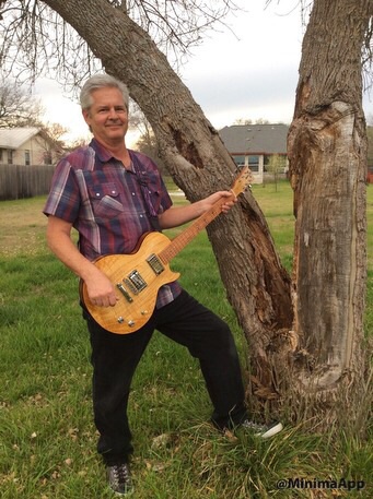

I cut and dry Mesquite.
I try to make my chainsaw cuts right down the end checks, parallel to the rays.
Cutting your own stuff gives you control of your finished stock.
I waste a lot of Mesquite, but I save it for the grill.
I made this one from a back yard Ash that had curly figure.
