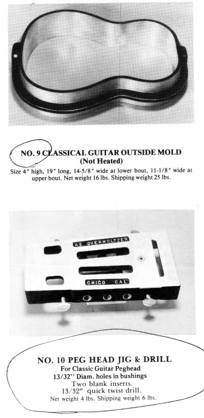

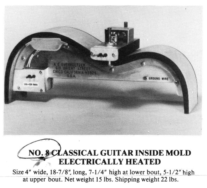

I scanned 4 pages from my old book of the jigs you could order. Here are two segments. Need any more let me know.
As one can see, people are still making versions of what Art sold many years ago.

As I recall, Art's book pretty much covered all one needs to know about using these jigs. They weren't cheap to purchase even when new. I have the electrically heated inside mold, have used it, and find it is a good bender if you don't mind being limited to Art's plantilla. Plug in the waist caul, crank it slowly down when the wood is warm and compliant, then unplug the waist caul and plug in the inside form to bend the upper and lower bouts. It's really quite easy to use. What more would you like to know? The outside mold seems pretty straightforward, though I've never seen one nor used one; use it as you would any outside mold to maintain the shape of the sides while working on the guitar. The peghead jig and drill guide is also pretty straightforward. It is used with a router to cut the string slots and the sides of the head, and there should be a removable piece that can be cut to use as a router guide for shaping the top of the head to whatever shape you decide to produce. Use a drill through the guides in the side to drill for the tuners. The 4 thumbscrews position the guide on the head blank. It's really all pretty self-explanatory. As far as their origins, I believe that Art had these gizmos made originally for his own use, then had then produced for sale, later, I think, his son-in-law (I believe) took over production, but I believe production halted some time ago. As to their present day value: whatever a willing buyer will pay for them; they _may_ have some value as "collectors' items"--someday they'll be "antiques", "rarities" etc.. As for their utilitarian value, most builders will prefer a Fox-style bender or a hot pipe and their own shopmade jigs.

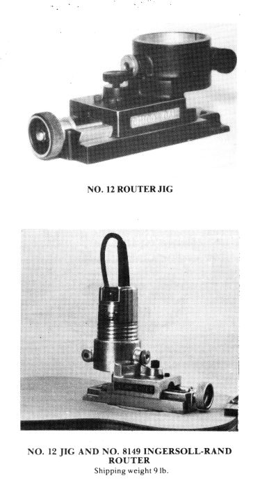

I should add that both the waist caul and the internal mold of the bending machine have thermostats that can adjust the temperature of these parts. It's accessible via a hole through which one might insert a screwdriver. Also, to elaborate on the origins: These jigs were made for and sold directly by Art Overholtzer at first, then the sales (and production, I believe) were taken over by his son-in-law. There was also a router guide for cutting the binding/purling ledge(s). Most of the items were a bit pricey, being cast and milled aluminum, and satisfactory tools for these tasks could easily be fashioned by individuals in wood, making them not indispensable tools to have.

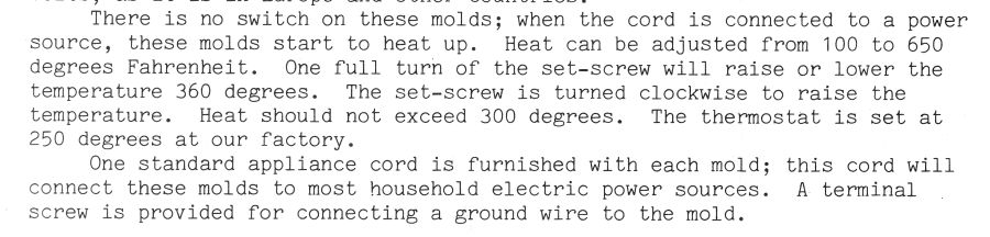

As an afterthought, I would be remiss in not warning that when in use the electrically heated bending mold MUST have a separate grounding wire. The thermostat has a small porcelain nib that prevents the adjustable contact from touching the frame; this piece of porcelain can be easily fractured when adjusting the thermostat should one bear too hard with the screwdriver (I've done that!). In that case, depending on the polarity of your line cord (it's not polarized), the unit can be electrified with mains current and cause injury or death to someone touching the mold if it is not grounded.. I found it helpful to mark the cord with the proper polarization so that I avoid the spark and tripped circuit breaker attendant upon plugging the unit in the wrong way, and always make sure the unit is grounded securely.

Yea says you have to add a ground wire in instructions like Bill stated.
Here is also pic of router attachment Bill mentioned. He also sold other molds and a fret slotting box.
