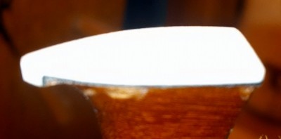

Post by Dick Hutchings »
Crummy picture but it's the best I can do with my phone.
I haven't tried the shellac yet. I'm quite happy with it as it is for now. Just thought I'd post a picture of the finished tip. I plan to buff it out the next time I have it re-haired. I'll do it before sending it. Picture size has to be pretty small compared to some forums.
