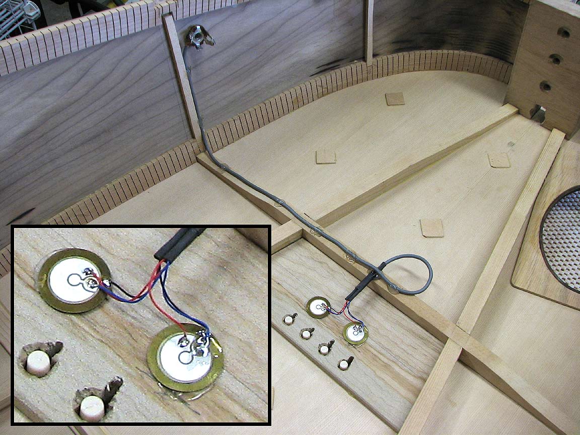

I'm looking for tips about what kind of wire to use to wire up a two-element piezo affair. Perhaps it is not so critical, I probably can source some nice flexible stranded wire from a local hobby shop, if that would work.
I am thinking the two discs need to be wired in parallel, not in series; am taking direction on that also.
Lastly, I was going to spread a thin layer of epoxy or CA to help hold the wires mechanically, and CA the element to the soundboard. Is that the right approach?
MS
Wire type/source and design, and "affixment" for piezo

Use Shielded wire to solder onto the piezos.

Here's some info from a bass I made: http://www.mimf.com/phpbb/viewtopic.php?f=10&t=973
There's a lot in the library here too. I ended up using a thick layer of hot melt glue to mount 2 pickups in parallel under the bridge plate. I've never used them to gig with, so can't really say how they sound. They're just there as a contingency measure.
Definitely use shielded cable as Mark says, as their high impedance can pick up noise. Here's a pic of the way I mounted mine. I installed the jack on the side rather than at the tail so I could reach it through the sound hole in case I ever needed to.
