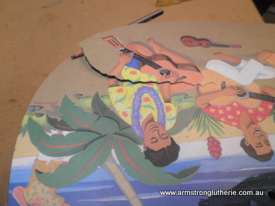

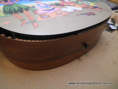

Thanks to everyone for your replies. I don't have any confidence that the neck can be removed from the top without damaging or buckling the top - and as you'll see from the photos, the top has a print on it and I suspect that damaging that will be unavoidable.
My gut feeling is to give the owner the bad news and suggest he buys a new guitar ... and takes better care of it! The reason he wants it repaired is he thinks it is a collectors item because it is one of the limited edition artist print ones with the Hawaiian scene by Robert Armstrong (no relation) printed on the top. But these are still available for around $1,000. I've included a few photos here so you can see the damage. The bridge is totally off and there is a chunk missing from the top (which he still has) and there is a sizable crack across the top along with the top being detached from the sides for all but about 2" either side of the neck. Maybe I'll just glue all the bits back together as best I can and suggest he hangs it on the wall as a conversation piece!
Any other thoughts?

The painting, on top of the formica, degrade the value of this instrument instead of increase the value.

Why not just re-glue all the pieces parts back together taking care to minimize seams showing and call it good? I've worked with quite a bit of hpl on countertops and always relied on contact cement and a J roller. CA maybe?
The tear in the top looks like a candidate for a cleat inside.
That, or turn it into a cutting board.

The scene is not painted on the surface of the HPL, it is photo printed and an integral part of the HPL.
Re: Martin X neck joint
Formica and other HPLs are basically layers of phenolic resin impregnated paper with a photo finished melamine surface. There are touch up people who can repair those surfaces so as to make the repairs almost undetectable. If the owner has all the pieces he could seek one of those people out and may get a better result than most of us could do.
A garden variety patch up with CA would make the guitar sound about as good as it ever did, which is to say.....
