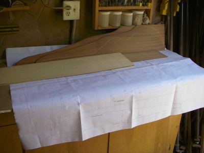

Here is a picture of my materials. I am using the weissenborn plans from our MIMF plan list. I purchassed a weissenborn sitka top from Alaska Specialty Woods, and a Weissenborn back and side set from RC Tonewoods.

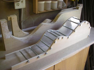

The first step was to build the bending, and building forms.

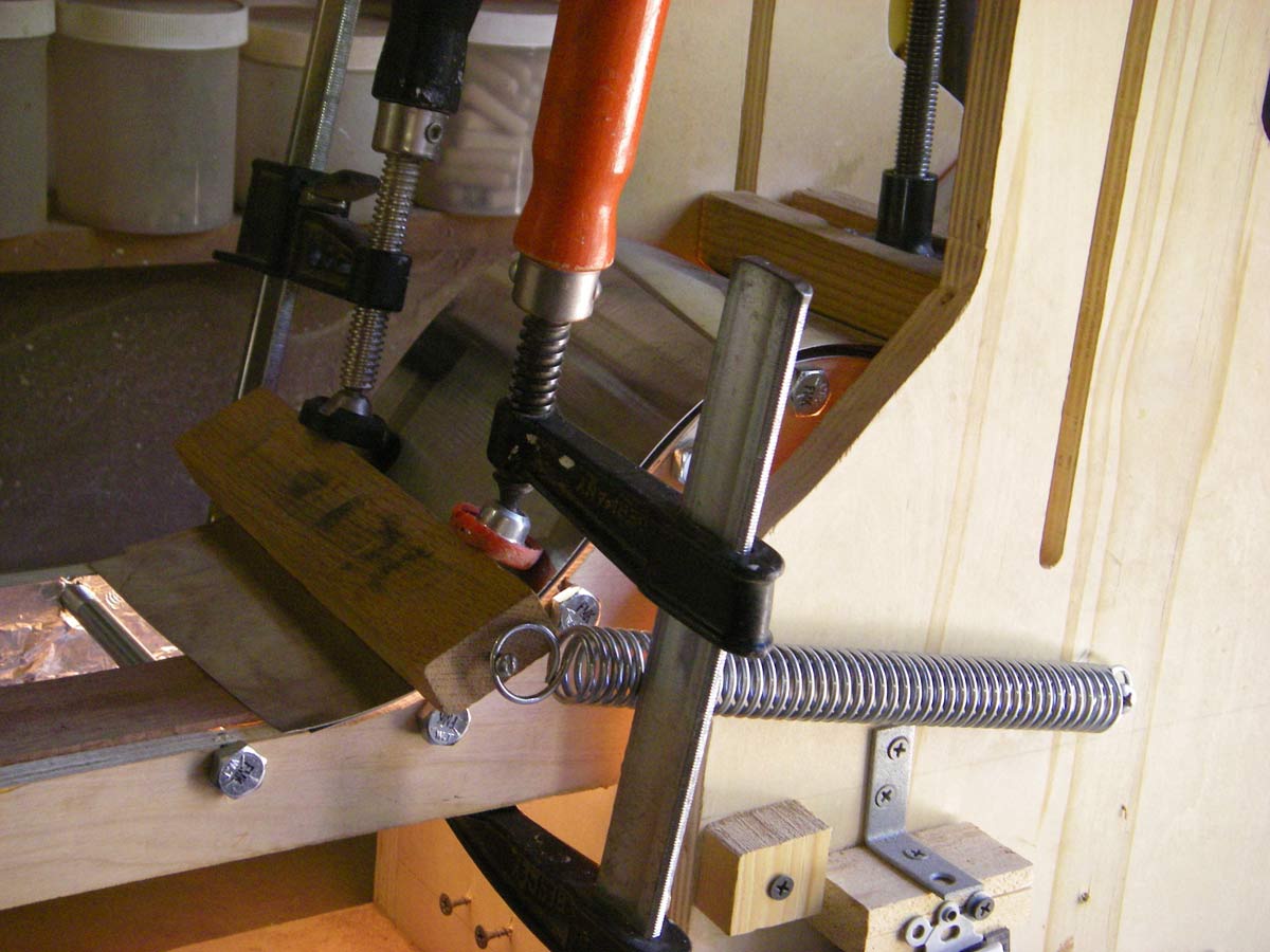

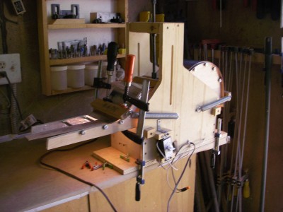

I bent the sides on my Fox style bender. I had to clamp down the back curve at the neck to make it work, but it came out fine.

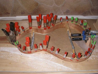

I just got back from a 12 day mini vacation in Maine (it was great), and can resume work on the weissenborn. I had done a bit of work before I left, that I did not post yet, so I will start buy posting those. On this project I pre-bent linings as opposed to cutting kerfing. I have been doing this recently and like doing it this way. I used some mahogany I had left over from an earlier project. I ripped them to 1/8 in. X 3/4 in., and bent them the same way I bent the sides in the Fox bender.

Then I glued them in place keeping the sides in the form. I used two layers of lining to build them out to 1/4 in. This gives me a nice bit of wood to glue on the top and back.

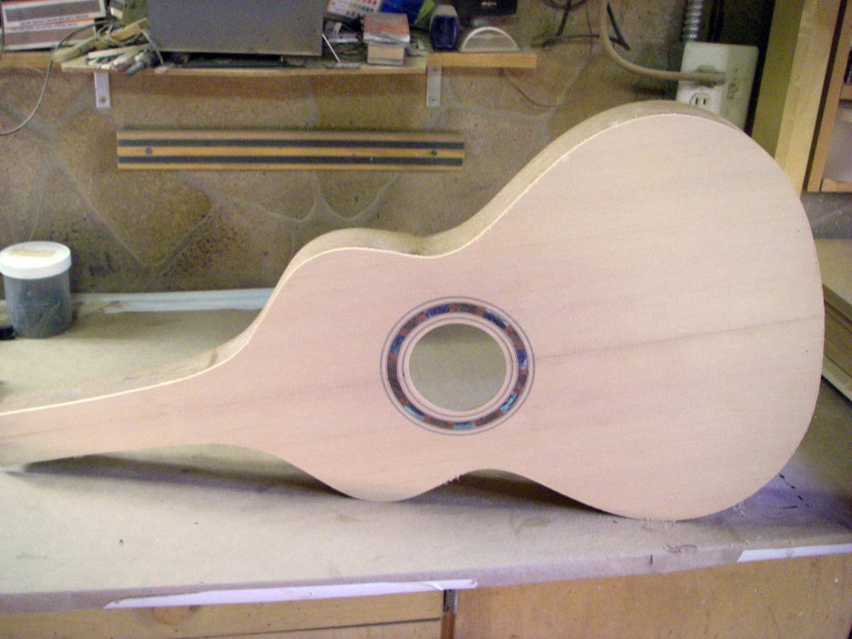

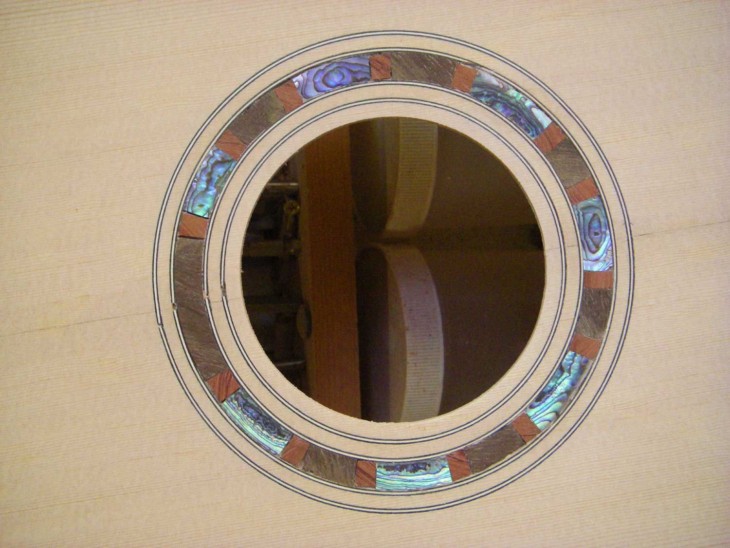

After gluing the two soundboard panels together I routed the recess for the rosette purfing, and rosette. I glued in the purfing, and cut and glued in the pieces for the rosette. I then sanded and scrapped the rosette flush with the top.

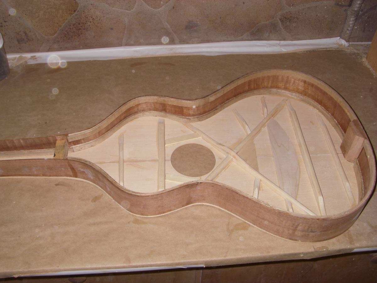

I used sitka spruce for the braces that I bought from Alaska Specialty Woods. The plans did not show using a radius on the soundboard, but I decided to use a 15 ft. radius. After the glue dried I shaped the braces and glued the soundboard on the sides.

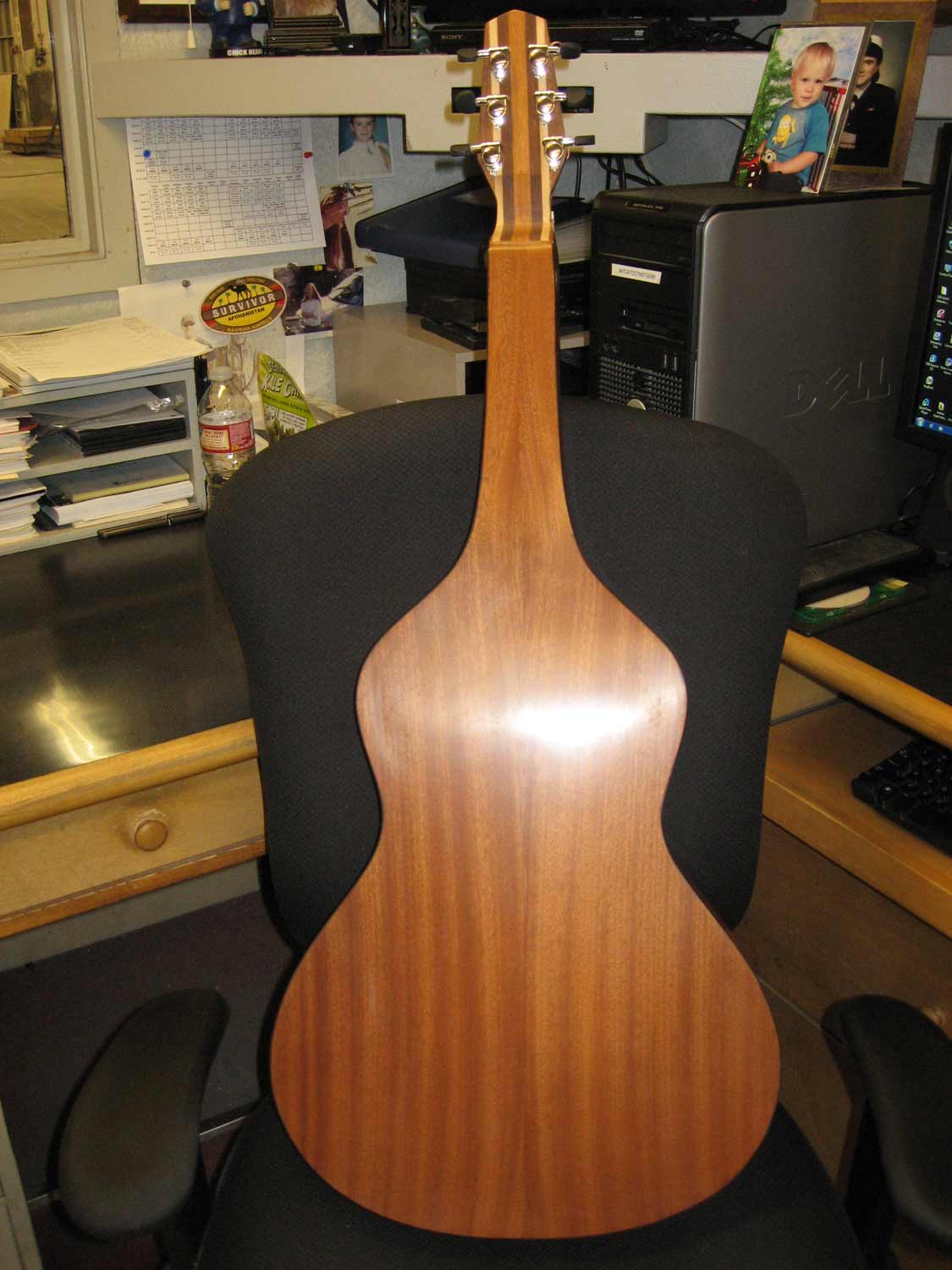

I finally finished the weissenborn !! I had to let this go for a long time, I have been so busy these last 6 months, I just couldn't work on it. I took two trips to Maine, we went to Gettysburg, My son got married, and we had several new shows at CBS that kept me going 24/7. It was a very fun project. As always I am glad I joined the Challenge. I took it to work last week and everyone loved it. I ended up giving it to one of my employees, who just couldn't stop playing with it. I may have to build another one.
