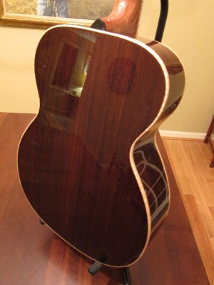

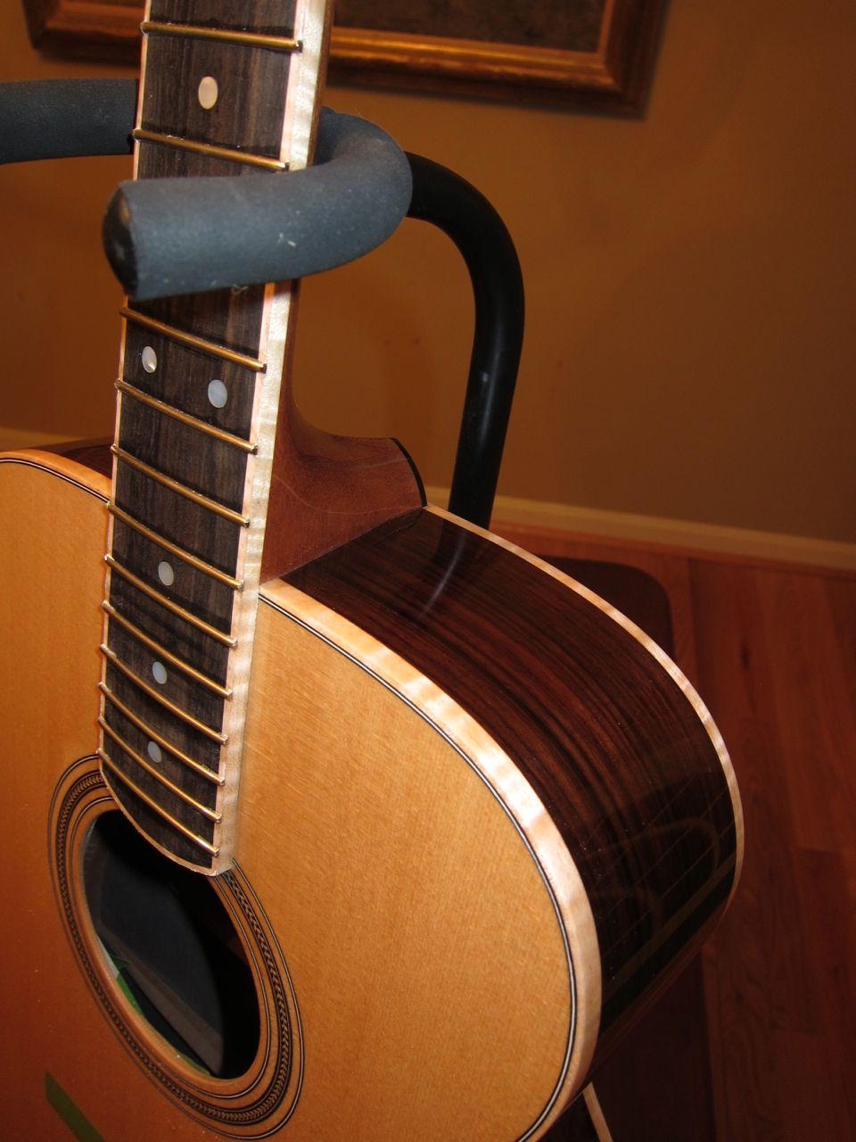

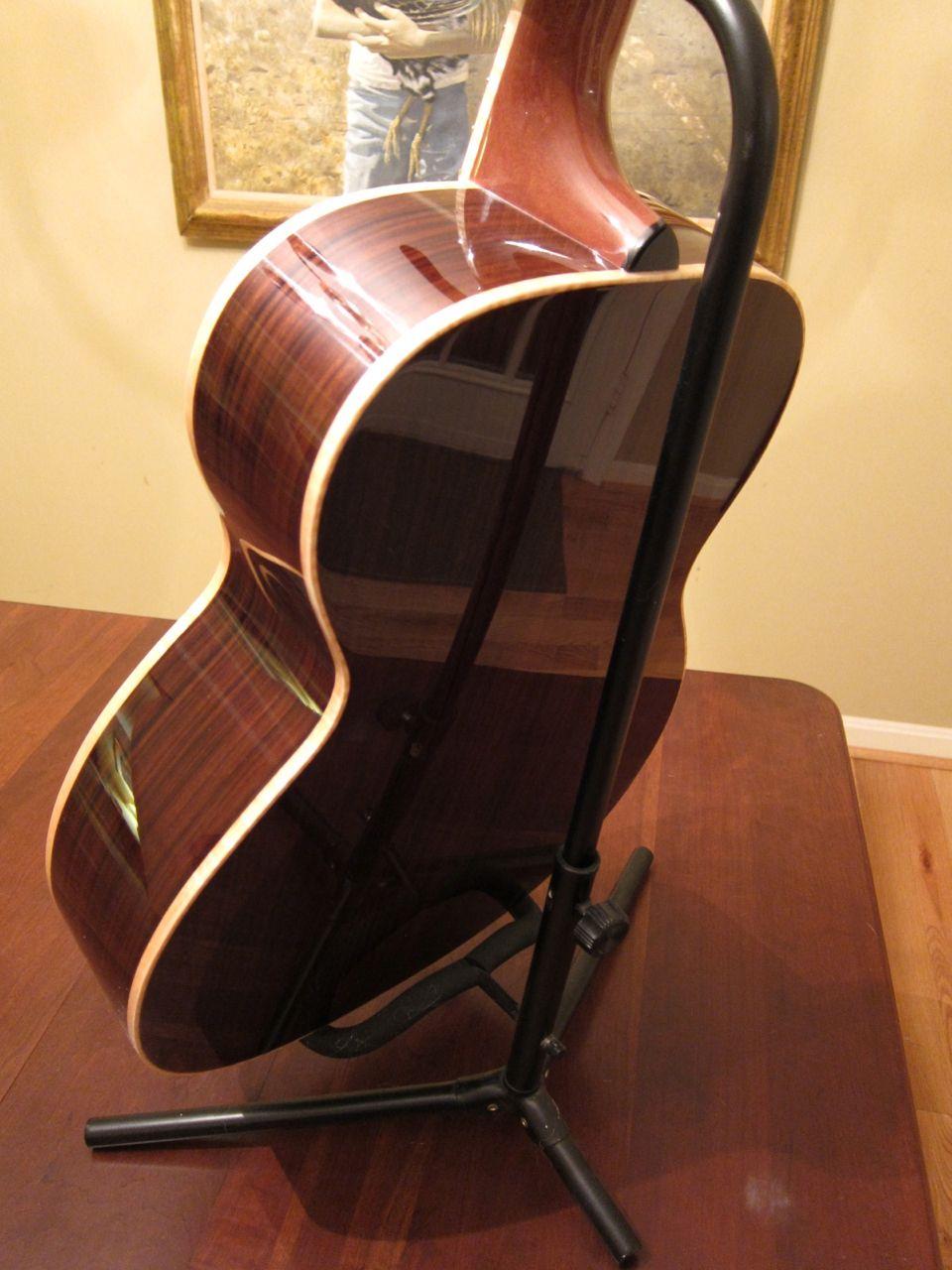

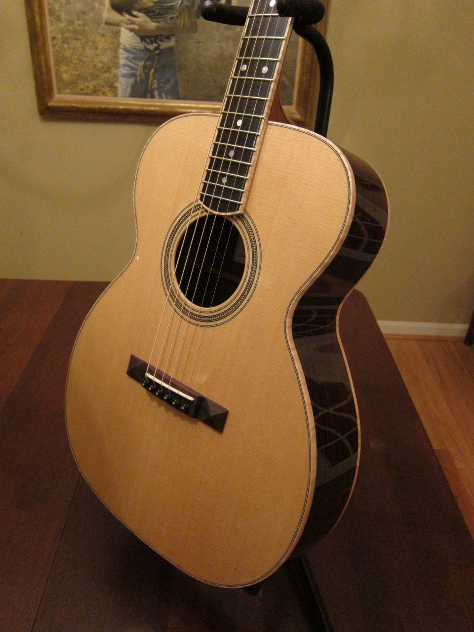

I've built five solid body electrics and two archtop acoustics but this is my first flat top. I followed Robbie O'brien's online course and I found that it did an excellent job of giving me analogs for difficult things like how you know when the top is the correct thickness and how to know when to stop removing wood from the braces. Tough concepts when you have no experience.
It is an OM in East Indian Rosewood and Sitka Spruce with maple bindings. Nothing fancy but it turned out very well and even though when I first strung it up the sound was kind of choked and not impressive, after three days it sounds like a different guitar and I'm liking it a lot. In parallel I'm building a Gibson L00 size guitar with the same materials. Should finish it after Christmas.
The build actually went quite fast but I had a lot of trouble with the finish. FIrst, I live in the DC area where it is humid and I don't have a spray booth so I spray outside. That meant I only had a few random days when it was dry enough and warm enough to spray outside. I ended up spraying in my garage and opening the doors after each spraying session to air it out. It worked OK but I'll be needing to build a spray booth soon. My other problem was with the Cardinal lacquer. When I level sanded between each three or four coats I could see witness lines where I sanded through one coat into another. Looked like a shimmering contour map. I ended up making sure my last three coats were sprayed only an hour apart so they melded into one. It worked. I had some issues with pin size bubbles in the finish too. I think I'll go back to Behlen or McFadden or try something new next time.
Thanks for looking,
Jeff

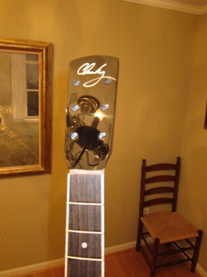

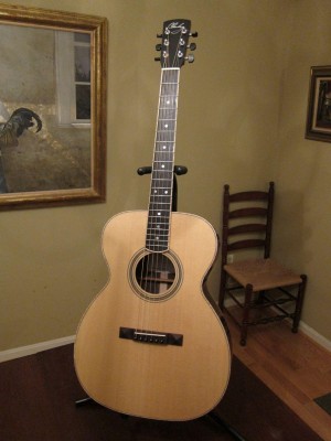

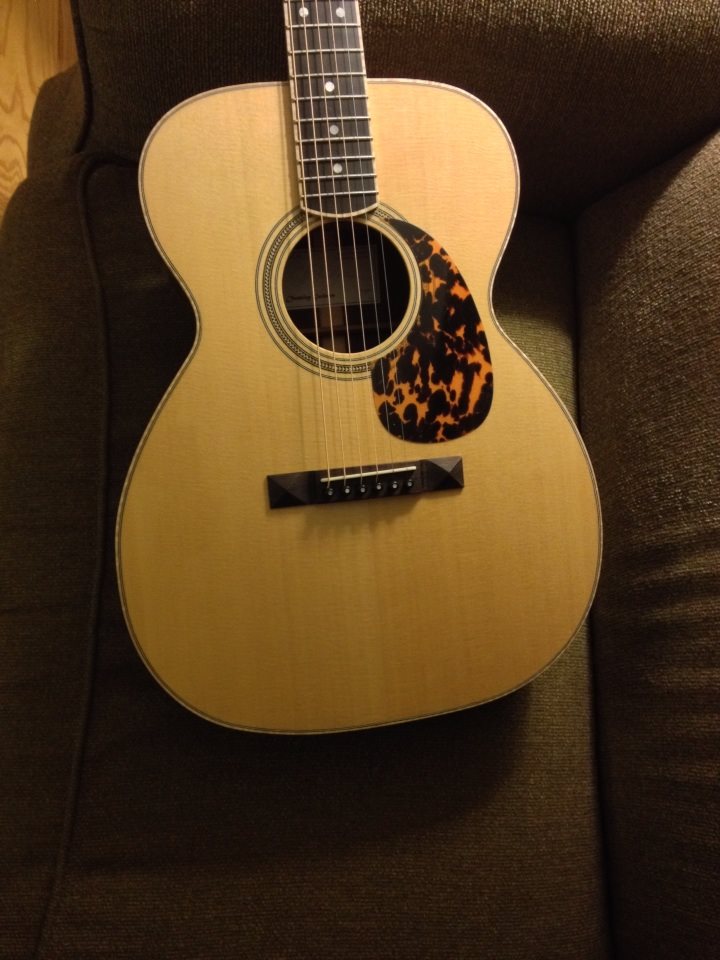

A few more pics.

Very nice job, Jeff. The finish looks great from the photos! I like the maple binding on the fretboard, and the pyramid bridge. The OM is one of my favorite guitars, and yours is very classy. The tone will continue to improve as you play it in. Enjoy it.
