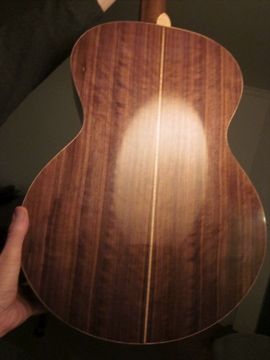

Re: First Build - Building from a kit vs building from Scratch?
My feeling on the subject (given that my experience is very limited - one acoustic built on a course, one electric on a course, and two electrics at home) is that a teacher, or someone who can act as, if not a mentor as such, a sounding board and answerer of questions, is probably more useful than either a book or a kit. If you do not have access to equipment necessary to mill and shape timber, then a kit would be useful, but I suspect that, even if building from a kit, there will be times during the build that problems occur that the kits' instructions do not answer. A book (chosen wisely - and I have already mentioned my particular preference for Cumpiano/Natelson and those by Melvyn Hiscock) is constantly accessible, and will provide you with the necessary guidelines/framework/methodology. Neither are they particularly expensive (assuming you stay out of the Somogyi/Gilet/Gore level).
I think (not having made from a kit) that you will receive far greater satisfaction from doing as much of the actual work as possible, even if it takes you considerably longer, and with possibly greater expense. As mentioned by others, you will make mistakes on your first, but the way you work around these mistakes will only enhance future builds. With regard to the pair of electrics I made at home, I do prefer the aesthetics of the first one, but the second is a considerably better instrument, probably because of the ways I found to overcome errors.
Is there any particular reason you might be thinking of a kit? Having the sides bent, neck join, rosette inlaid, plates thicknessed etc for you? If so, there are ways of doing such steps with a little practice on scrap material, or reclaimed (i.e. cheap!) timber. For my first home acoustic builds, I am making a pair of ukuleles, mostly because (I think) a lot of the processes are similar to an acoustic guitar (with some minor exceptions), but because I they are much smaller, I can use bits of wood that I may otherwise have chucked away (ok, perhaps rippled maple was not an ideal choice for first set of bent sides - but bent they are, and cheap too) as scrap.
Overall, I imagine you would be better off not with a kit and doing it from scratch, but those with a helluva lot more experience than may say otherwise.
If you are ever over in Scotland, you are more than welcome to visit and have a look at my setup.

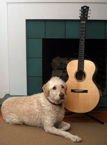

All good comments above. Since I was one of the people who suggested considering a kit, I'll add my two cents. And because I don't know anything about your experience, abilities, shop or goals, I'll tell you mine and you can extrapolate to yours.
I'm an intermediate player, own several very nice guitars. I'm pretty handy, an engineer who is fascinated by how things work. I thought I would add a small body guitar to my collection and thought it would be fun and interesting to build it, knowing full well that I might end up with an expensive canoe paddle. I spent about 6 months doing research - different books, what it would take to equip my shop, what exactly I wanted. Decided that a customized kit made sense - I'll talk about why in a bit. Built an 000 28 clone which has been my go to six string for seven years now (my D18 sits in the closet). Next I thought a small bodied 12 string would be fun - again, a customized kit, followed by a little parlor for my daughter, ditto. Here they are stacked like cord wood
Since then I have built mostly from scratch, but there are still a couple of things I like to buy. I'm pretty proud of this one
and my latest is a little 00 size mahogany guitar which, ironically, was based on a the plans for my first one
OK, what does a kit get for you? Actually there are different levels of kits with different amounts of work pre done but basically, first you get everything you need and usually good quality. You don't have to search the internet for that special length truss rod or a piece of maple for the bridge plate. Second, some of the difficult tasks or those that take special tools are done for you. Plates are joined, thicknessed and the rosette channel is cut. Neck is rough shaped, truss rod channel is routed, the tenon is shaped. You get a neck block that fits. Bridge is shaped, slotted and drilled. Fretboard is radiused and slotted. Braces may be preshaped. None of these are impossible for a newbee, but I promise that if you screw up one fret slot you'll appreciate preslotted boards. You may or may not get instructions and plans (kits vary widely). You may or may not get someone you can call on for help. You will get the challenges of setting a neck, binding, locating the bridge, and finishing. The only power tools you'll need are a drill motor and a router or laminate trimmer (however a band saw is handy for making a mold). Here is a build thread for my first one
http://www.kitguitarsforum.com/archives ... 25_0_6_0_C
I'm scratch building now, however I still buy slotted fretboards and pyramid bridges if that's what I'm going to use. I hated my first carved neck, took it off (thank goodness it was a bolt on) and reshaped (I made some templates from a neck I like). I'm spraying water based lacquer now which I'm pretty happy with. With each build I add one new major tool that I wished I had on the last one - a Fox bender, a router table, smaller router, more bits, belt sander, band saw, table saw (don't use it much), air compressor, dust collection. All sorts of jigs and fixtures. Next on my list is a floating router attachment for bindings - doing the horn of a Les Paul by hand was a pain.
Here is a build thread for the last one - I petered out on posting before it was done but you get the general idea of the additional work.
http://www.harmonycentral.com/t5/Acoust ... p/35542693
Just as long as you know what you are getting into, then by all means build from scratch. I'm very happy that I did it this way.

Thanks, once again, Freeman for your detailed response. Nice guitars! I love the mahogany resonator. Looks beautiful. Whenever I see these wonderful creations I always wish I could hear a recording of them being played.Freeman Keller wrote:All good comments above. Since I was one of the people who suggested considering a kit, I'll add my two cents...
Claran, thanks for the compliments on the dog and the guitar. Neither are from kits, though both are hybrids. The dog is a cross between two similar breeds (Labrador Retriever and Standard Poodle), both intelligent mid-sized dogs originally bred to be water retrievers and now mainly used as pets. The idea was to combine some of the best characteristics of both. The guitar is a hybrid between the J-185 and the 000 (with a 15.5 lower bout width, and a nod toward dreadnought depth; it's designed to fit in a D-size case). I hoped to have some of the good points of all these guitars. I call this my "Labradoodle" shape. This is a silly name, but does conform to the tradition of naming this shape after an animal.
