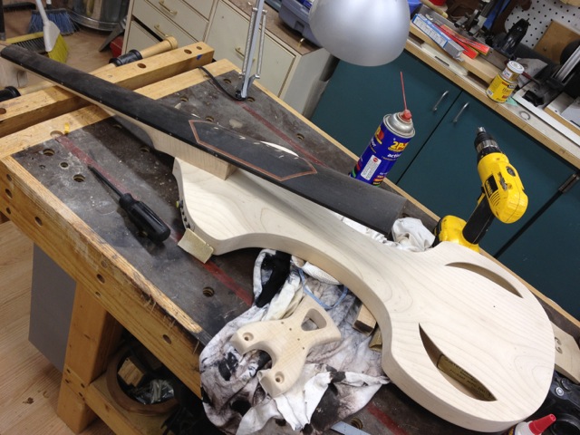

Do you have some work-in-progress pictures?

Hans, this is about the only "in-progress" pic I could find, but it gives a different view of the EUB. You can see in the upper bout how I integrated the preamp, so that only the adjustment knobs are showing. Battery access is in the back. The piece in front is the solid maple tailpiece, which attach with bolts. Unlike most other EUBs, I kept the neck angle and bridge height roughly the same as a standard acoustic bass and I also used a standard bass endpin, instead of a tripod mount.

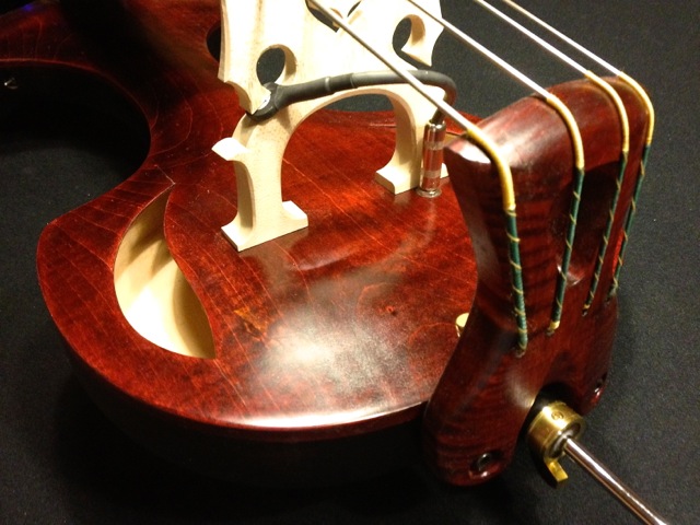

Could you post some pictures of the tailpiece?
Justin Tugaoen
Posts: 35
Joined: Thu Feb 02, 2012 3:44 pm
Re: Maple Electric Upright Bass
Post by Justin Tugaoen »

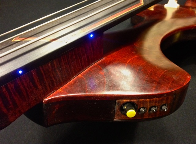

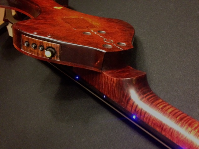

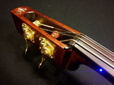

Here's a couple better closeup pics of the bass, including the tailpiece
I shall assume the tailpiece is the reason most EUBs don't use actual bass geometry: you really gotta get those string ends up off the top. Dang, that's a seriously beefy chunk of maple!
