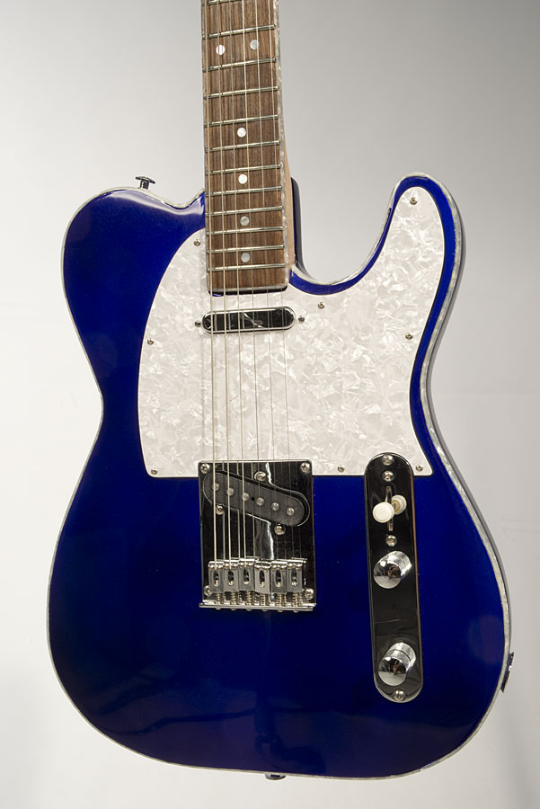

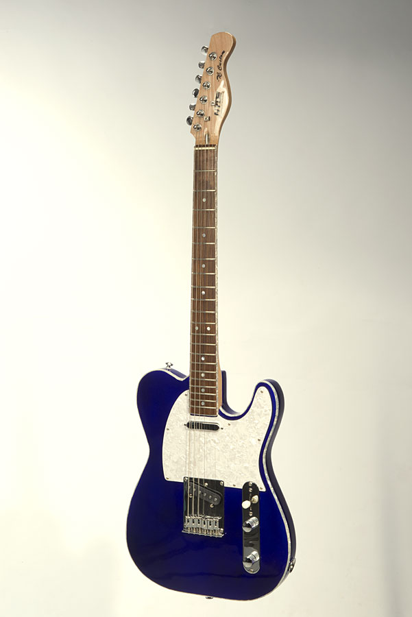

I took some studio portraits of the guitar the evening I finished it. Here they are:
Full frontal pose
Full frontal pose
The body
The body
Close-up of the body

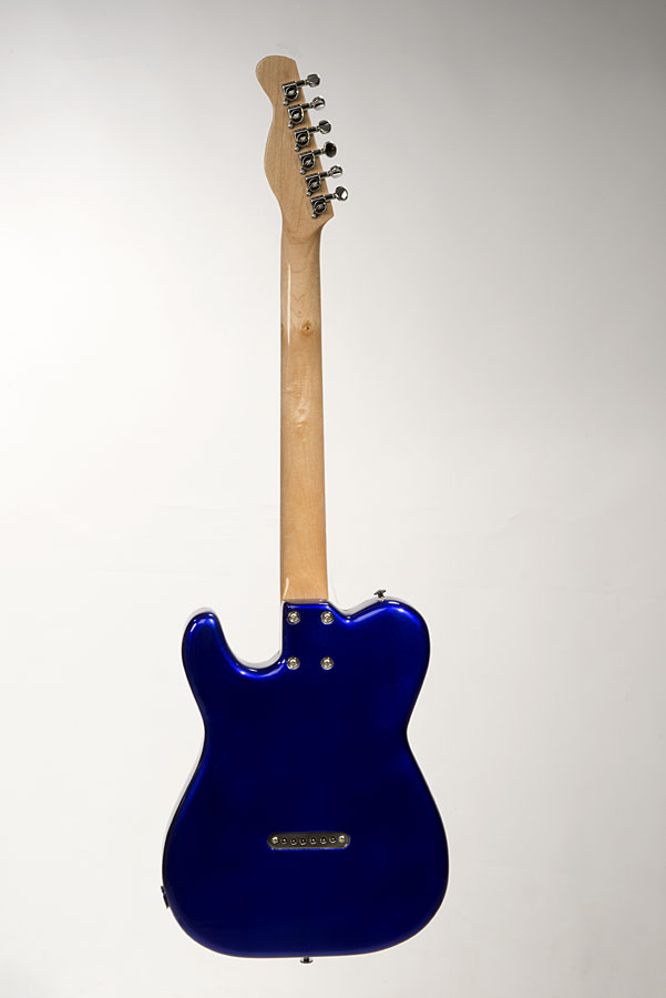

Full back pose
Full back pose

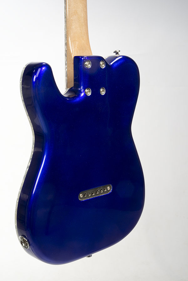

The body back slightly sideways

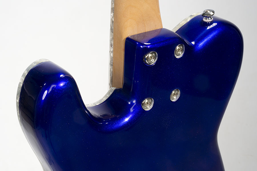

The neck joint is done with with ferrules in stead of an attachment plate. The back edge is so round that the ferrules were the right way to do it. The body back is very comfortable and I like the look of it too.

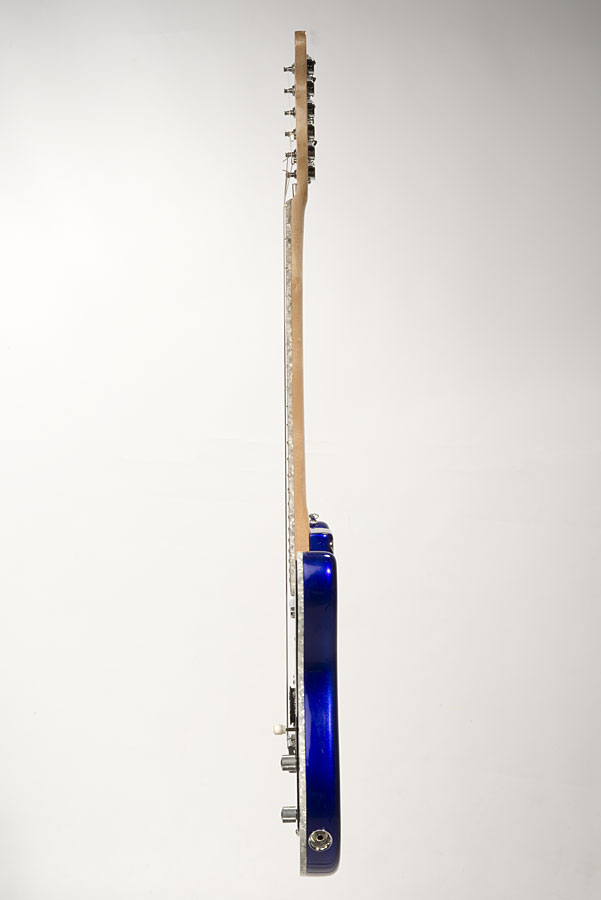

Totally sideways
Totally sideways

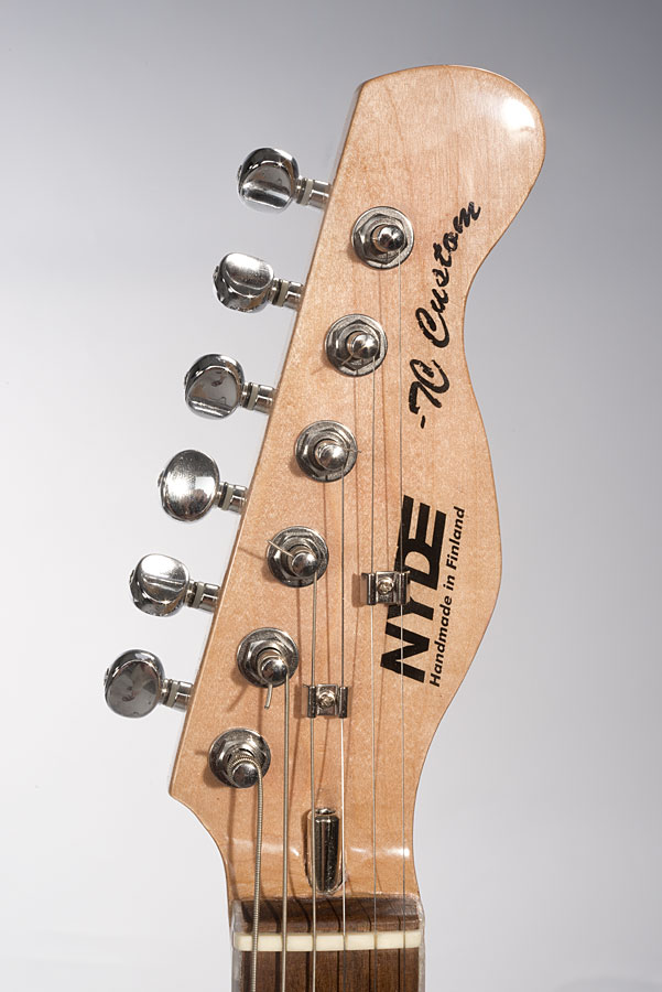

Headstock with logo
Headstock with logo

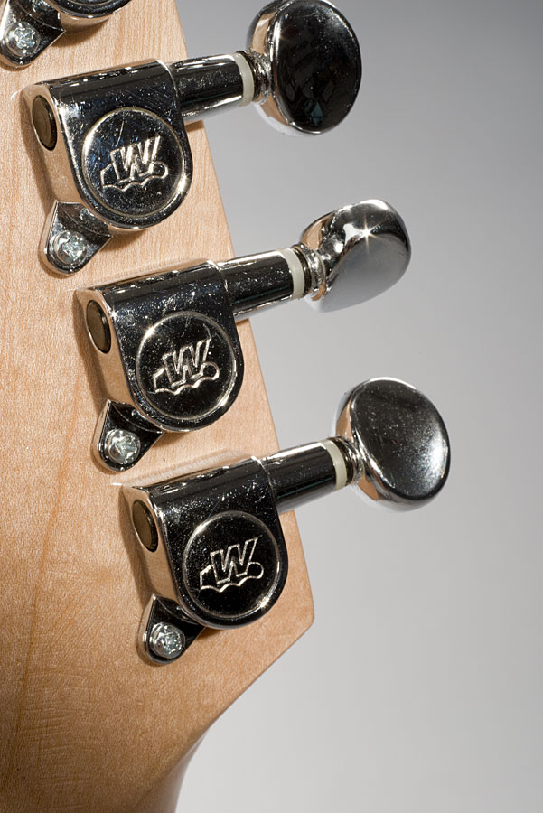

The 19:1 ratio Wilkinson tuners are great. They have a smooth action and they keep the guitar in tune nicely. I found them at Gear4Music for £15 a couple of years ago. I bought 4 sets and I haven't found such a good deal since. Now i have one set left.

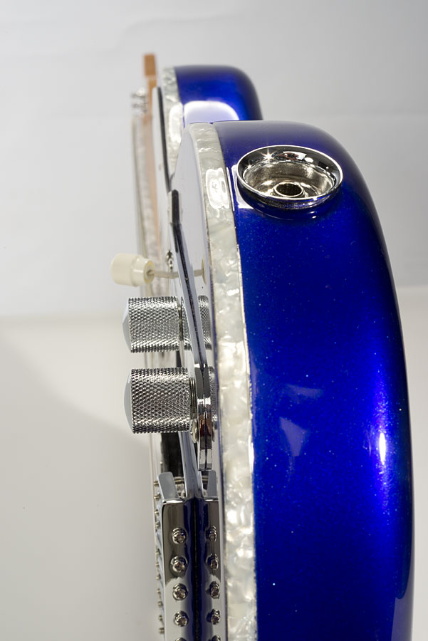

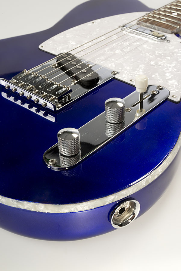

A close-up of the controls.

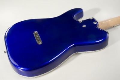

The back. The steel bar string retainer gives a good sustain. So no ferrules here.
The traditional cup style jack plate - out of the blue.

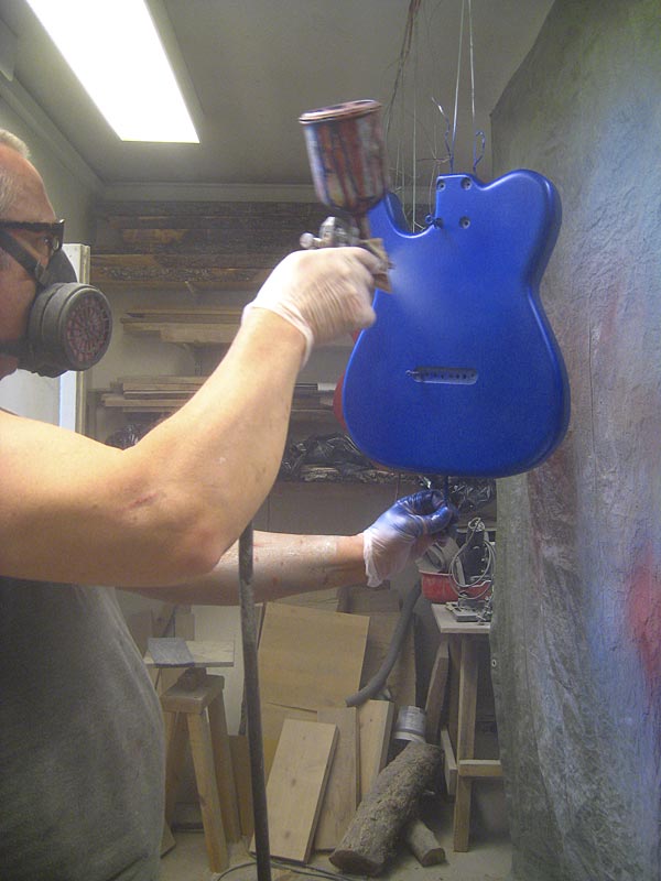

Thanks, Mario. The colour is a multi-layer job starting with primer. It's not all that difficult when you've got the hang of it. Always clean the spray guns meticulously after use, and then some more. Spray a little thinner through the spray gun before pouring the lacquer in. And practice on scrap first. Here I go like a teacher. But I am a photography teacher and believe in good instructions.
I use white Troton 2-component Acrylic Filler diluted with thinner in 1:1 ratio. It cures in a few hours and is a breeze to sand. I spray two coats of this and fill in any possible dents with 2-component putty of the same brand (and sand) between coats. Having sanded the second coat of primer really smooth with 800 grit paper I wipe off all the dust with a cotton cloth doused in naphta.
Then I make a blend of silver paint. I have previously used rattle cans, but they always let you down at some stage, spitting out big drops of solvent, no matter how you shake them. I mix 150 millitres of 2-component clear acrylic lacquer with the equal amount of thinner and then a tablespoon (15 millitres) of silver powder. I use a siphon cup spray gun with a 1.7 mm nozzle at a high (6 bar) pressure. I keep the paint container whirling laterally between spray bursts to keep the silver powder mixed in the lacquer. I use this spray gun for metal powders and flakes only and spray tints and clearcoats with different guns. I usually spray three coats of silver to get a an even silver basecoat, The silver paint is dry enough for another coat in 15 minutes. Let the last coat dry for 15-20 minutes.
The next step is to blend 10 millitres of Stewmac Color Tone transparent stain with a mixture of clear lacquer (25%) and thinner (75%). 200-300 millitres of this blend will usually do. Spray thin layers at normal pressure and let dry 15 minutes between layers - until you have the desired tone and transparency. The beauty of using the same clear the whole process through is, if you can avoid spraying too much at a time and causing run marks, that you can spray the first top coat of clear in just 15 minutes after the last coat of transparent tint. This particular build was topped with 6 coats of clear lacquer, wet sanded with 800 and 1200 grit papers between coats, with 800, 1200, 1500, 2000 and 2500 grit papers after the last coat. Finally it was buffed no less than 6 times.
I made a couple of candy flake finishes last year and two smooth shimmer candies this summer. I warmly recommend trying it. In no time your paint shop will be known for the coolest bike paint jobs of your neighbourhood. ;)

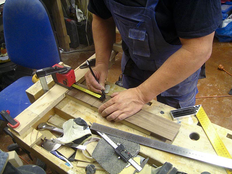

Measuring fret distances from the nut, with a digital measuring tape and a steel ruler. I use a pdf-based freeware program called fretcalc to determine the distances. Fretcalc can be used both with inches and millimetres.

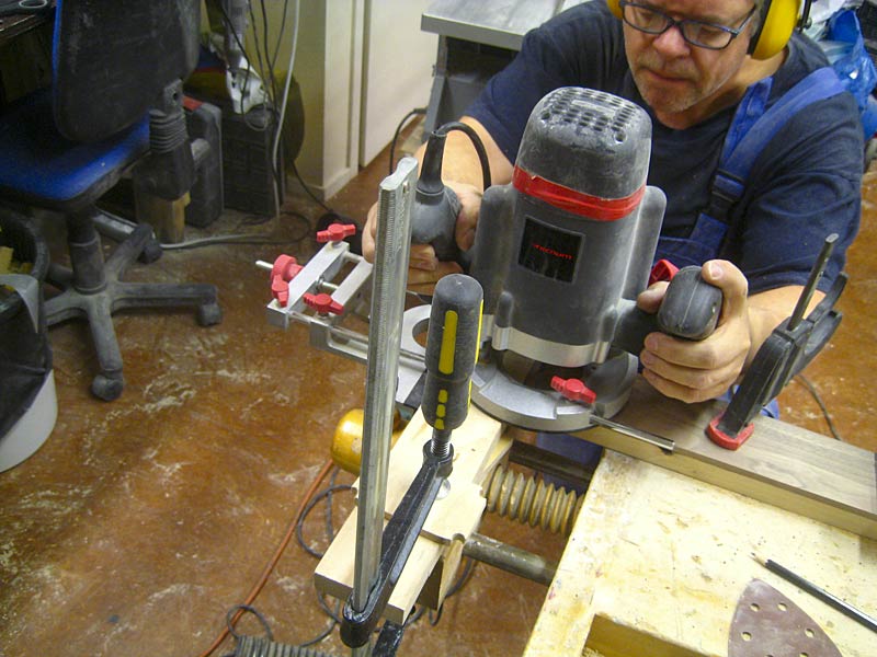

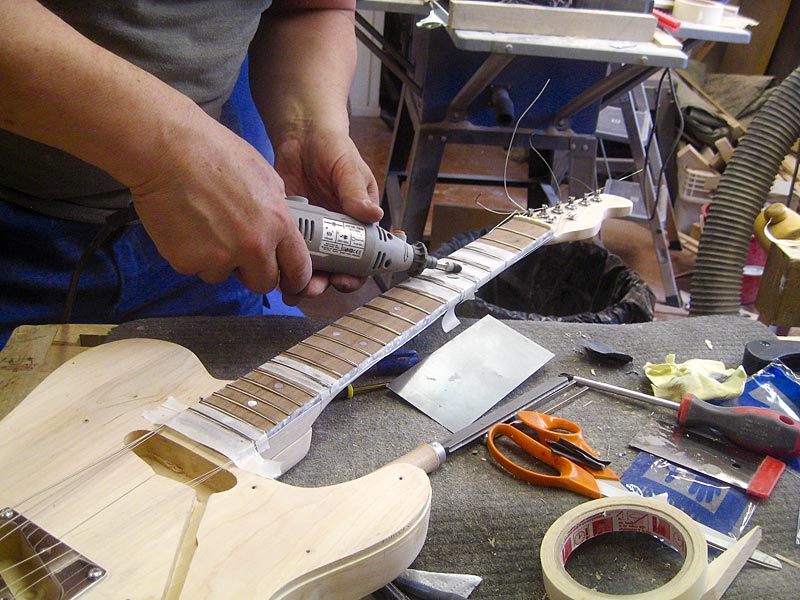

I cut the fret slots with a dozuki saw in a mitre box. After that I draw the outlines and cut the fretboard out from the blank with a bandsaw.

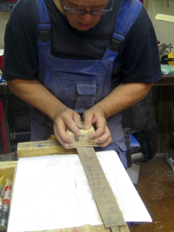

Radiusing the fretboard here. I've made 12", 16" and 20" radius sanding cauls for the job and most frequently use the 16" caul. They all have hook side velcro glued to the arch and I can use any sanding paper with velcro fastening with them.

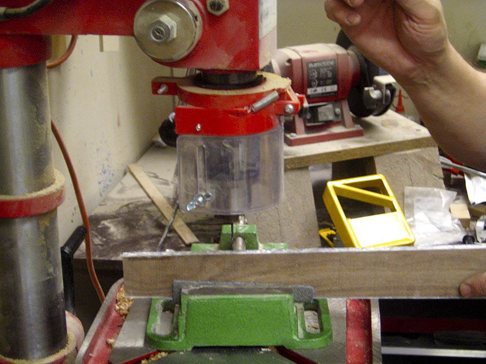

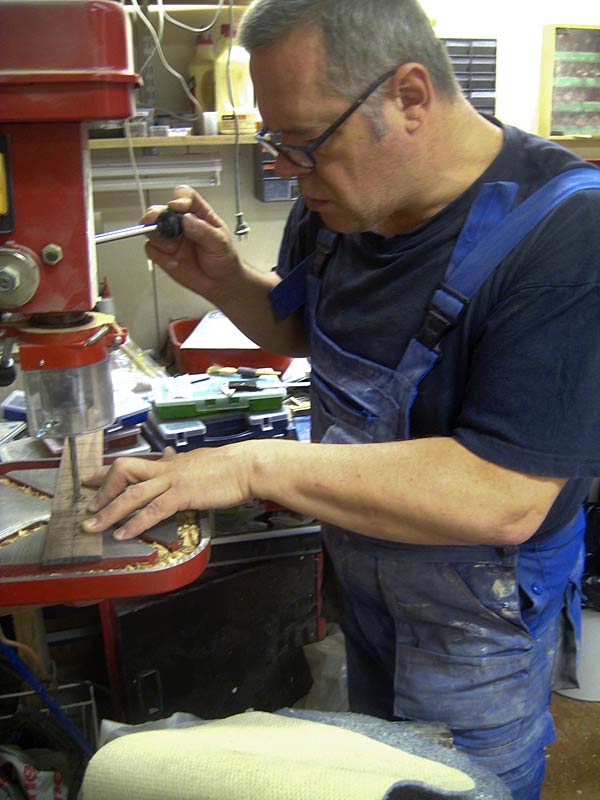

Drilling cavities for position markers. The markers are 6 mm diameter dots of real mother of pearl. I've purchased them from http://orders.mopsupplies.com/ where they cost 10 cents apiece and were swiftly delivered to Finland for an 8 € cargo. A guitar parts store in Helsinki charges 1.50€ for one dot. I'm not paying that.

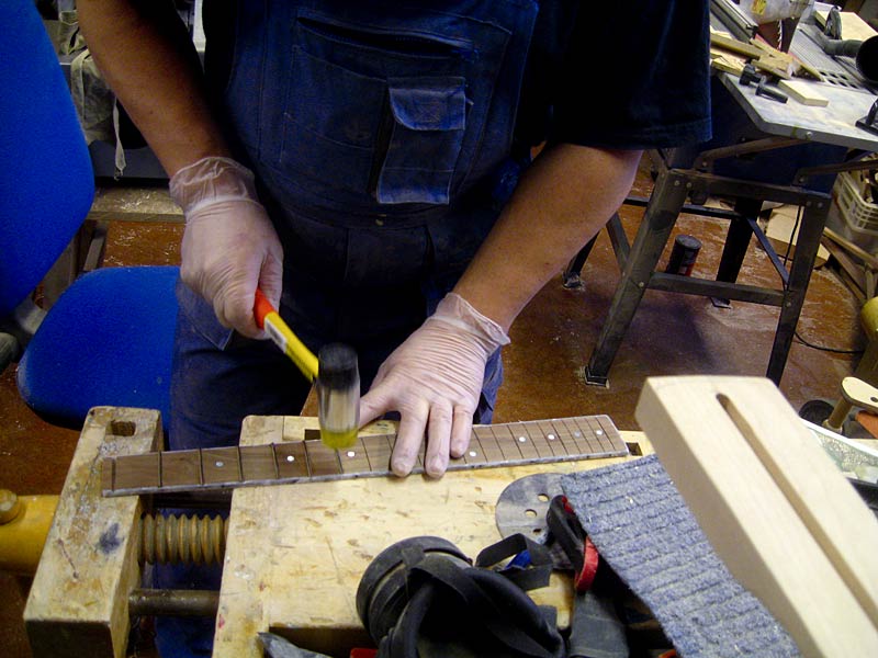

A plastic head hammer is a good tool to hammer in the frets, as it leaves no marks on the frets. Before I drive a fret into its slot I mask the fret slot edges with masking tape and flood the slot with CA glue.

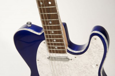

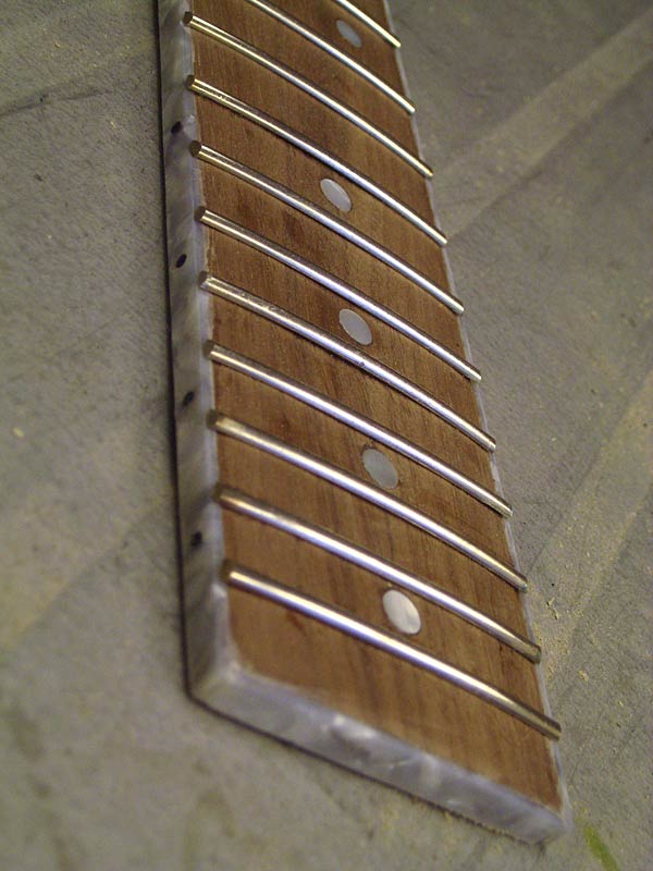

Here's the fretboard with binding. It took me a while to level the frets, but now they're good.

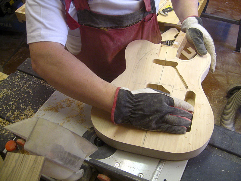

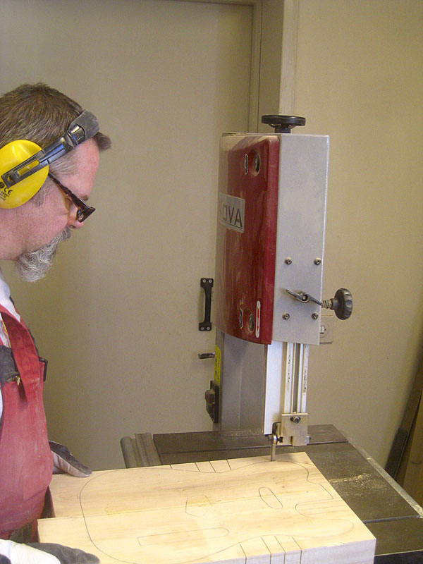

Cutting out the body with a bandsaw. I have purchased good plans of the Telecaster and made a plywood template for the body. Here's the new guy at work.

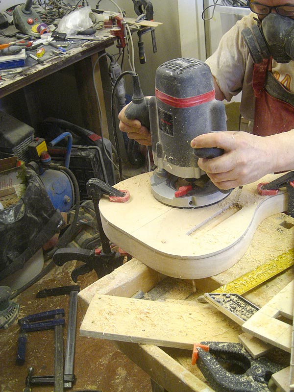

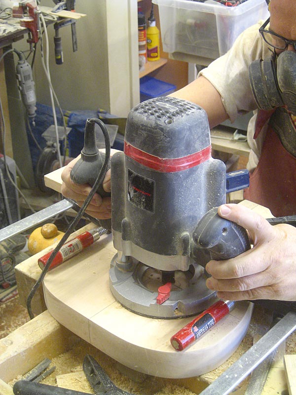

Trimming the body edge flush with the template using a table router.
Routing pickup cavities using the template.

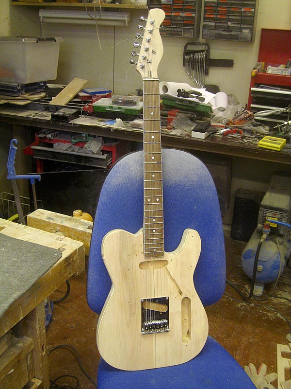

With all the body cavities routed I temporarily assembled the guitar to rule out any major glitches.

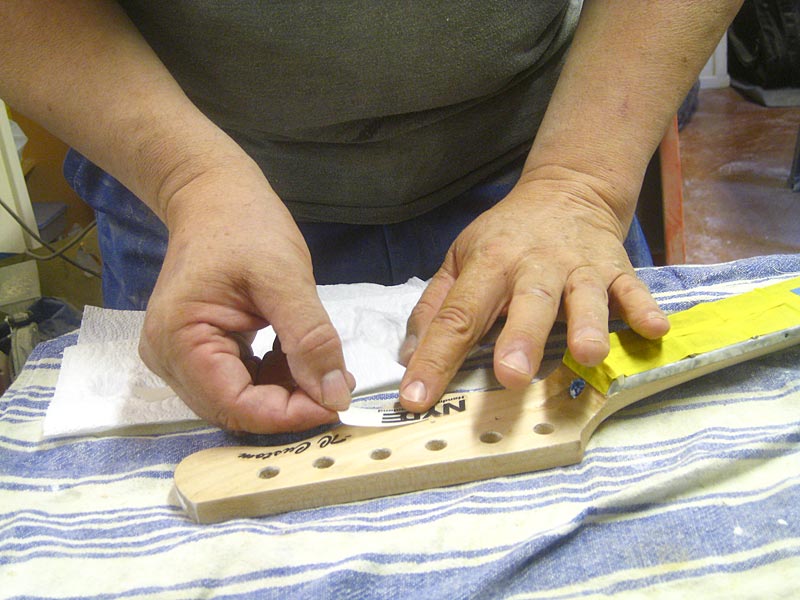

After the first layer of lacquer I attached the logo on the headstock, printed on a laser decal transfer sheet.

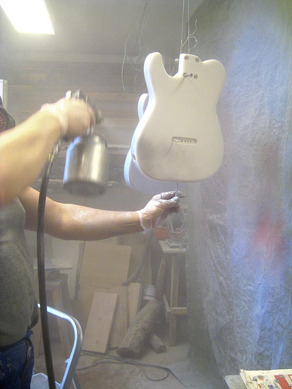

After spraying the second coat of primer and sanding the surface smooth I sprayed the body with silver paint until it was nice and even.

The next step was spraying transparent blue tint on the silver paint until the tone and the transparency where what I was trying to achieve. After that I sprayed a coat of clear.

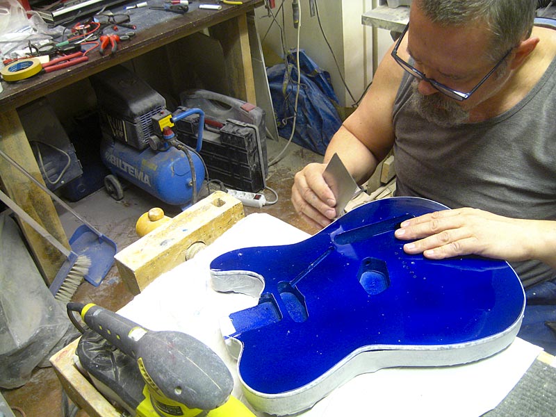

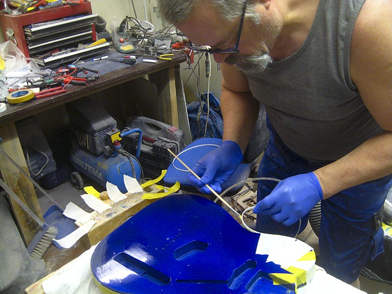

When the lacquer was dry I scraped off the excess lacquer from the binding channel and glued the binding in place using acetone as adhesive. I found it easiest to apply the acetone with a narrow brush.

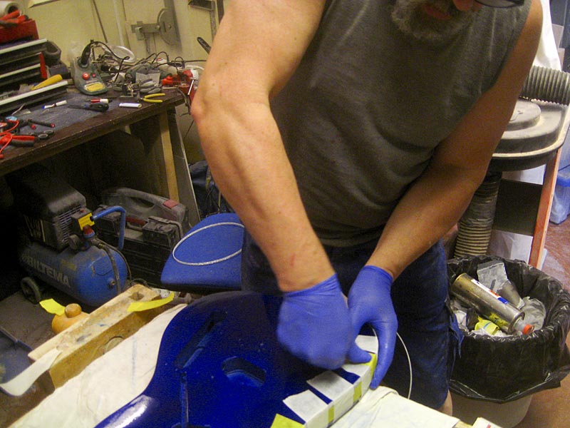

Fixing the binding into its channel with masking tape until the adhesive has set.
Scraping the binding flush with the body.
