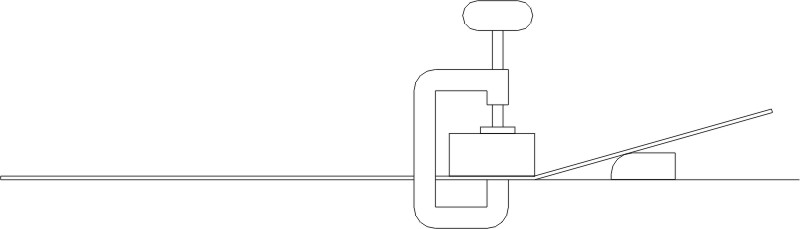

I make Selmer style guitars with the crease or "pliage" as the French call it. There a number of different ways of doing this and I think I tried most of them before arriving at the following very simple method.
I heat the bend area of the thicknessed, unjoined top plates and clamp each to the bench with a block of wood at the bend line and another under what would be the lower bout, to get the angle ala the sketch below. The sketch shows one clamp, but I actually use two, one either side of the 8" wide top plate. This gives me lots of control and a positive bend line. If you want a less visible line, do not clamp hard to the bench. I do NOT score the wood on the inner surface as 1) I have not had need to and 2) I can't help but think this weakens the top in the long run. My finished target is usually 6-7 degrees and I over bend as there is some spring back. I have bent both spruce and cedar tops this way.
I actually use a bit of a hybrid between hard and soft line, making it harder toward the glue line, softer toward the edge. This helps when gluing to the rims, which are usually straight at this point. That is, the sides force the pliage flat where the top meets the pliage, so you might as well bend it that way to start with.
BTW, the top plates should be pretty close to your target thickness before bending as planing or thickness sanding is tougher with a bent top.
For heat, I use either the top of my wood stove or my wife's heating plate for melting aquatint resin on etching plates
. You could probably heat a flat metal plate in the oven for this purpose. A heat gun or a clothes iron might do. A traditional side bending iron would do I suppose if it is wide enough for the 8" +/- top halves. Anyhow, I use a just little moisture and get the top piece hot enough to just scorch the interior surface a bit in the immediate area of the bend. Do not heat any more surface area than you have to, certainly not the whole top, just an inch or two either side of the bend. Get the heating done asap and with as little moisture as possible to avoid warping.
I apply the clamps fairly quickly so as to bend while hot. Crank it down over about 15-20 seconds. Listen to the wood. I have only come close to breaking the top once and I heard it well before it caused serious damage.
Try to leave the top set in the clamping jig overnight, but I have pulled them out in as little as 60 minutes and still had success. Over-bending is better than under-bending. Just reheat with heat gun and pull a bit of it back out. The exact angle is less important than that the two top pieces be at the same angle so they can be glued up easily.
Here is a sketch of my setup.
Good luck with your Selmer D. 14 fret to the body I assume? A 14 fret Selmer with a pliage AND a large D sound hole is a potent combination.

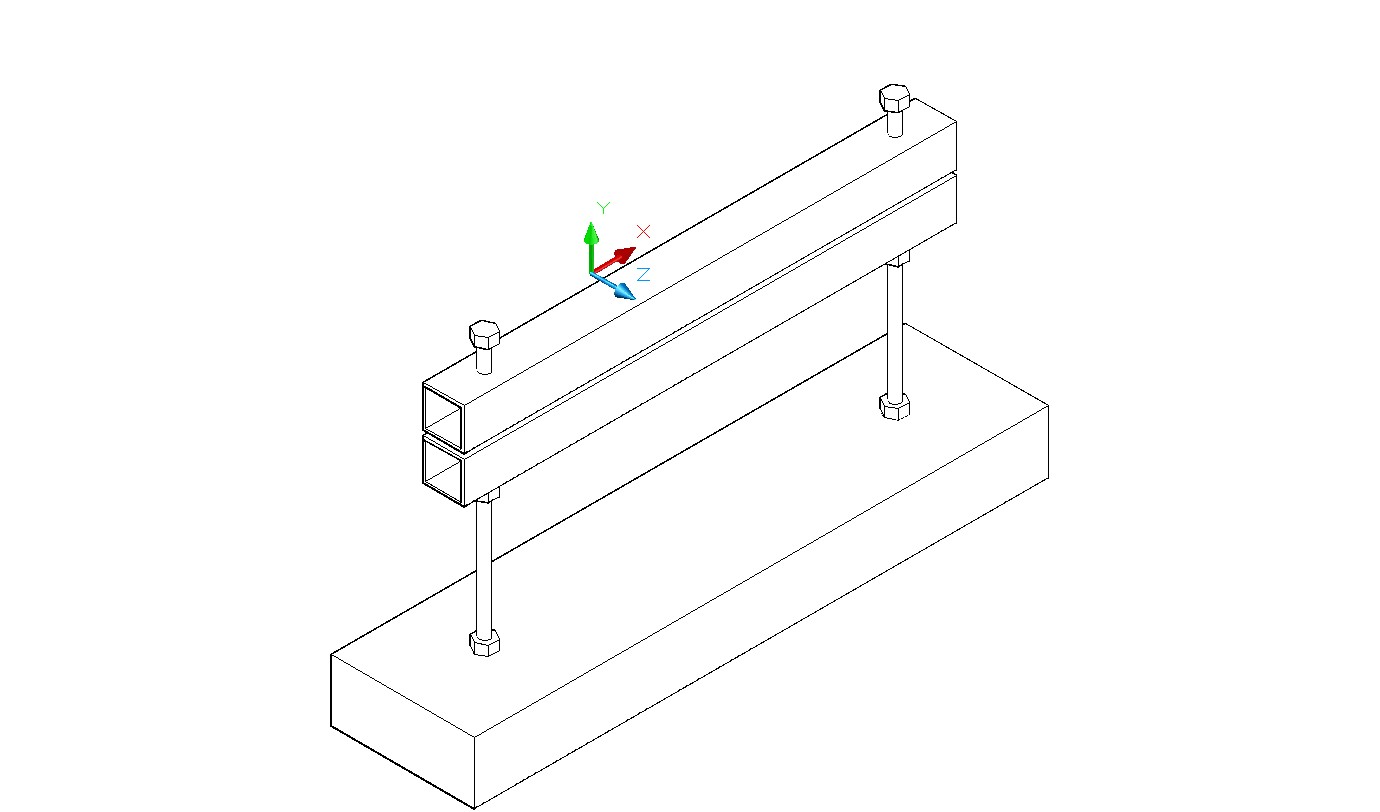

I built a clamp from square aluminum tubing (1") that is heated with a torch both top and bottom. This heats a 1" strip which is advanced 1/2" when ready and the clamps screwed down. The top is then bent on a previously scored line and removed from the clamp. The top is thicknessed to .09 - .100" (2.1 - 2.2mm) and scored about 1/3 their depth. I wet the top as it heats. It's been a long time, but I think we tried to get the clamp to around 350F and heated about 1 minute. I have observed that the scoring of the top creates a crush zone for the fibers and helps prevent the top from cracking. By scoring, I mean the fibers are severed but no wood is removed; we used an exacto knife and made a block to control depth. The angle is somewhat greater than Craig mentions.
You will need to let the plates sit a day or two before gluing so the moisture level in the heated area equalizes with the rest of the top. The bent plates are glued up before any dome is introduced but the angles are, obviously, matched up. I have noted that we used a 6.5' radius for our braces; this gives a nice dome to the top.If you check the library you will find some pictures I posted. I also hope that I can post a drawing of the clamping jig. I found the auto cad file of the drawing; it will take a few minutes for me to render it useable here.

This is a sketch of the clamp. I modified a fan shaped torch tip to give two separate flames to feed the tubes. Basically I just squoze (mashed) it shut in the middle! Also the clamp has wing nuts on the top of the bolts for quick clamping.

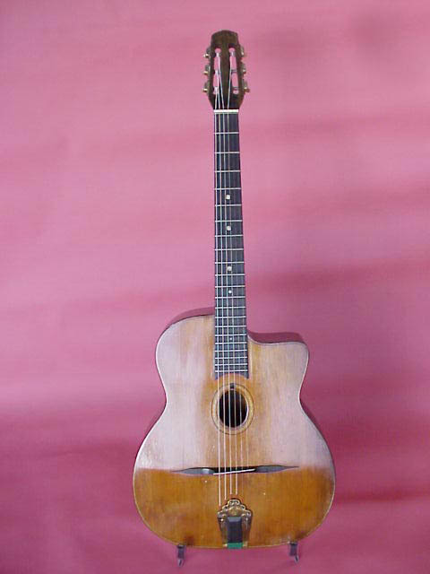

Craig, the reason we don't see the hard line on the guitar is the dome. This pulls the crease out at the edges unlike the flat top of the mandolin where the crease continues to the side. I agree, your picture illustrates the hard line I'm talking about. Interesting on such a late guitar.
- Posts: 372
Re: Doing the "crease" for a Selmer-Maccaferri model.
Al, the mandolin top is not flat, but arched. The photo Craig posted above shows a pliage clearly, but you really can't tell from the photo just how sharp the bend is, as so much is dependent on the lighting angle in photographing the guitar: making 3D judgements from a 2D image is very, very difficult. I will say that the pliage on the Selmer that I examined in Francois Charle's shop a number of years ago was definite, but not sharp like a mandolin; whether or not that was due to a flattening over time from the string pressure on the bridge I can't say.
