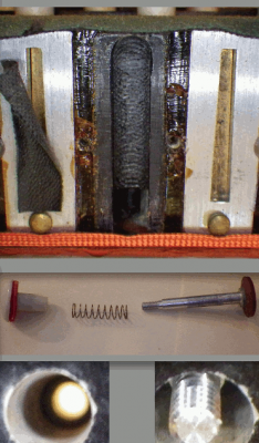

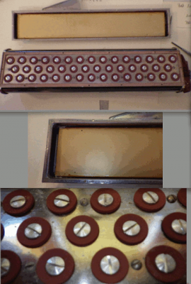

I thought I'd follow up on this thread as the last item was a request for more info to be posted here. I ended up purchasing Casey's Marcel Dreux accordina and it arrived today in great shape. I've attached a photo of this accordina along with one built several decades earlier by Borel.
Cheers !
I'll post another photo later of Casey's Borel dismantled so you can see some of the details. I'll mention in passing that the limitation of 150k on files has required me to severely reduce the color resolution of these files.Cheers !
- Posts: 105
Re: Accordina plans - parts
Here's the first section of the interior parts photos that Casey sent me. I had to cut up the nice montage he sent into 3 parts and reduce the color palette to meet the 150k limit on files. Hopefully these will help any who want to know what's in these little beasts.
- Posts: 105
Here's the second section of the interior parts photos

This is really interesting. I was not aware of these curious little "mouth accordions." Can you explain more about what we are seeing in the photos? What is the path of air through the instrument?

I was going to try to draw something to illustrate the air path but it's difficult to capture as a 2D diagram. I'll try it this way...Jason Rodgers wrote:This is really interesting. I was not aware of these curious little "mouth accordions." Can you explain more about what we are seeing in the photos? What is the path of air through the instrument?
The mouthpiece is mounted on the bottom of the case (of the instrument, not the carrying case). The bottom of the case is an air tight chamber under a block where all the valves are located but the only way the air can escape is through a valve opening.When a button is pressed a path opens from the chamber to the reed associated with the valve/button. The air flows past the reed, which has to move to let the air past, since the reed blocks the opening. The vibrating air is now in the outer chamber (ok, that's not technically a very good statement, but we're thinking air path) where it finally escapes through opening(s) that face down towards the mouthpiece.
