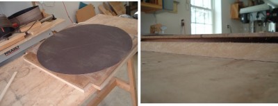

You can make your own radius dishes very cheaply. I pulled a 1/4" piece of masonite into a near sphere by calculating the deflection at a foot from the center, making a rim of that height, and pulling down the center with a flat head bolt. The same dish is very useful for sanding the rims. You know you're obsessed with building. You might as well surrender now and forget about the budget. You're going to spend everything you have anyway.

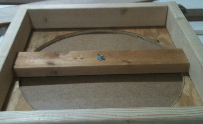

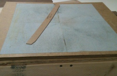

Re: Radius Dish Help
Here is my adjustable radius dish. The pics are not great; I can't get to my computer to resize images right now so I had to do cell phone pics and crop them down.
Despite being haistily made, it is quite functional. The circle cut out is 20". Not shown in the picture is the stop block that gets sandwiched between the bottom of the Masonite and the cross peice. As mentioned I can use different thicknesses to provide a positive stop for the various radii. It is worth mentioning that the laminated Masonite will eventually take a set to whatever dome it is left at. I laminated the two peices with contact cement and ther is some degree of cold creap. Occasionally, I turn the dish upside down and weight it down for a day or two to flatten it enough that I can pull it back to whatever radius I need.
On top you can see one of the radius templates (the one I use for tops). I check that I t matches the dome I have dialed in and then use that to mark my braces. Then I plane them to match and do final sanding/fitting in the dish.

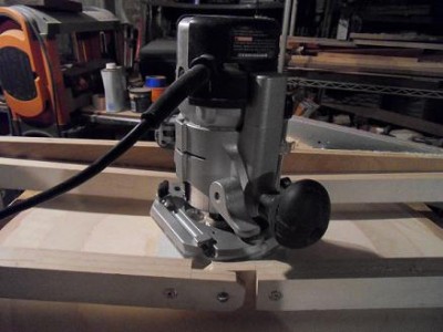

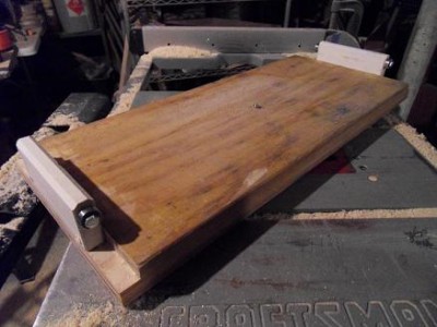

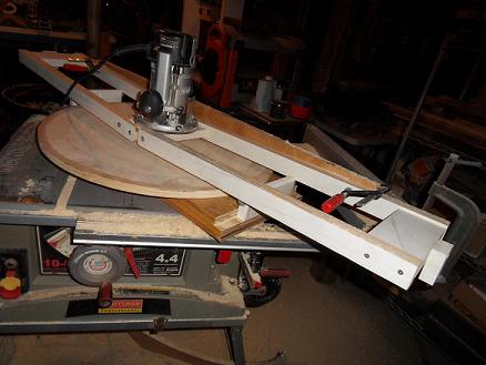

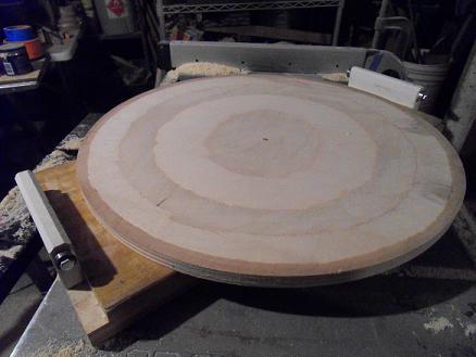

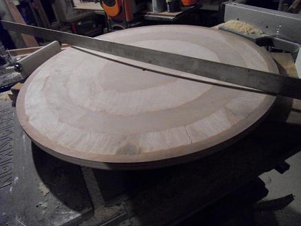

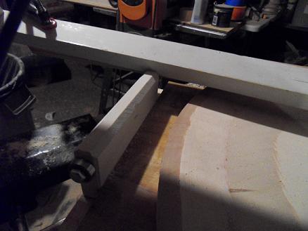

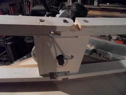

- Posts: 275
I made a dish radiusing jig a while back that was adjustable, and it works great for me. I did so because everyone seems to gravitate toward 15' and 25' and I wanted to be different
- Posts: 275
Additional views... NOT for indoor use!!! Bryan's and Bob's technique is a lot less messy!
- Posts: 1120
Louie's comment about indoor use is an understatement. The first MDF radius dishes that I made with a router I made outdoors. There was still way too much dust. I don't do any major routing of MDF anymore. It just seems unhealthy.
