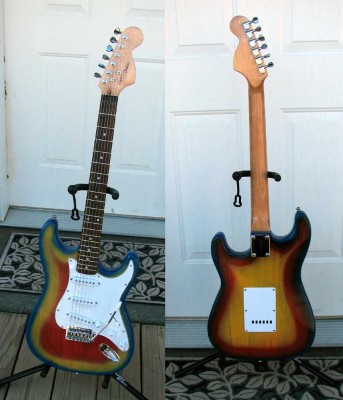

My grandkids and I built the Guitarfetish strat kit about 3 years ago. Construction-wise it's a super simple screw together project. Everything is precut and drilled (except the headstock, which can be easily shaped or left as-is.) The fret board is fretted, and the neck and the body just need to be sanded and finished. The only negative is that the body wood is soft and dings quite easily. We didn't do very well on the finish - no filler, cheap spray on rattle can paint, then polyurethane - but this made the body more dent resistant.
It's a cheap way to learn how a guitar is built, and with proper attention gives you the opportunity to learn how to finish and set up a guitar. No instructions for this were given, but there is plenty of information here and elsewhere to get you through it. The guitar was certainly playable, but not being an electric guitarist I can't comment one way or another on the sonic quality.
