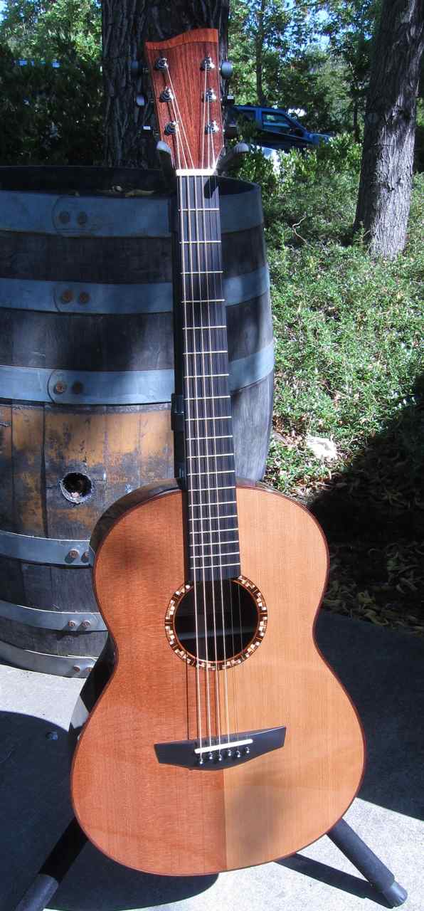

Re: Classical style guitar with steel strings?
I made a steel string guitar based on a Rodriguez body that came out nicely. It has 13 frets to the body with a 25.4" scale. I like where the bridge ended up with that combination. The top has a 30' dome. It's x-braced with two tonebars. The first is scalloped and the second is smaller and tapered. The tone is clear and full with plenty of bass, though not quite like a larger guitar. I liked it so much I'm making another.
Ken, very nice that looks like what I'm talking about. I didn't think of a 13 fret neck but I guess why not, like you said it seemed to feel right where the bridge wound up. On the classical I built I thinned the fretboard toward the bridge to get relief and it worked well, has anybody tried this on a steel string? The neck angle on a steel string is only one degree I think on average?
