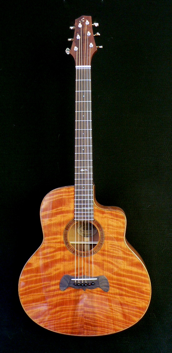

I was responding in another discussion about a guitar with a redwood top, and since I just finished one I thought I'd post it.
This is a "Fatboy" style guitar, for those who may not remember those, it has a 24.25 scale and was patterned after a Regal guitar that was made in Chicago in the '40's. I loved that old guitar so I used it as a starting point to design this one.

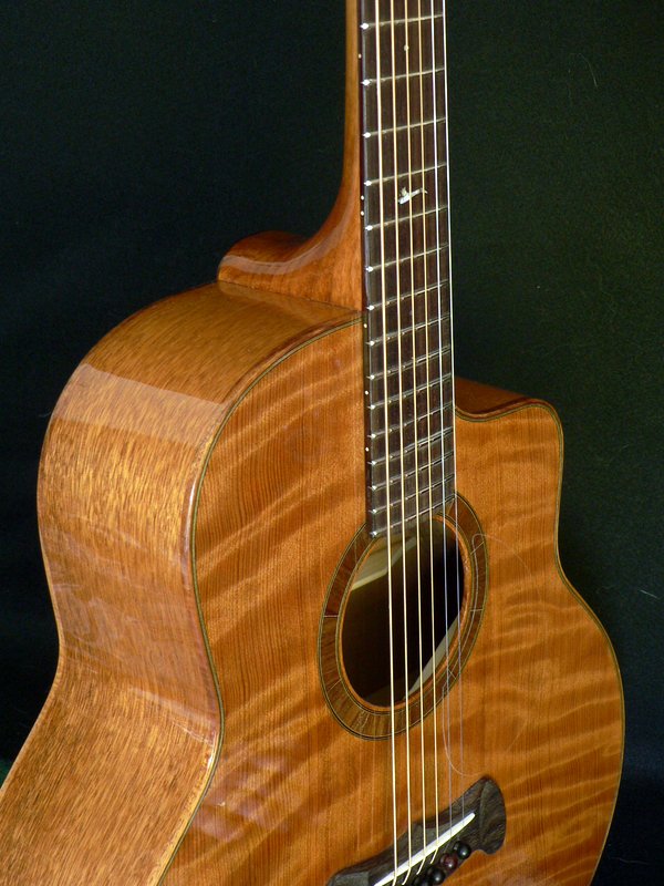

A few more shots...a rosewood fingerboard and bridge, and a segmented rosette.

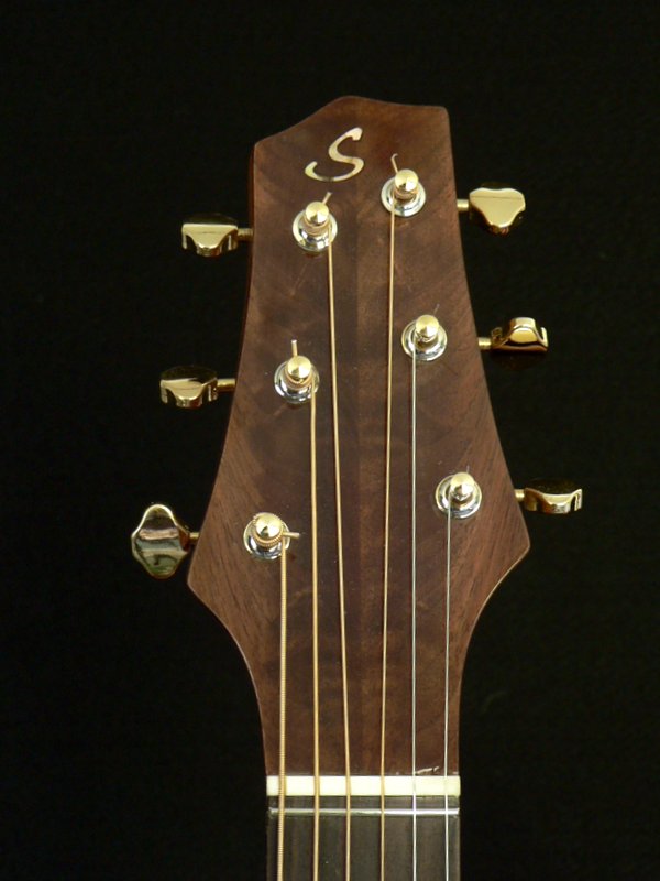

A peghead shot....That is a piece of walnut burl I used for the veneer and end cap on the back of the neck. the body has Koa binding.

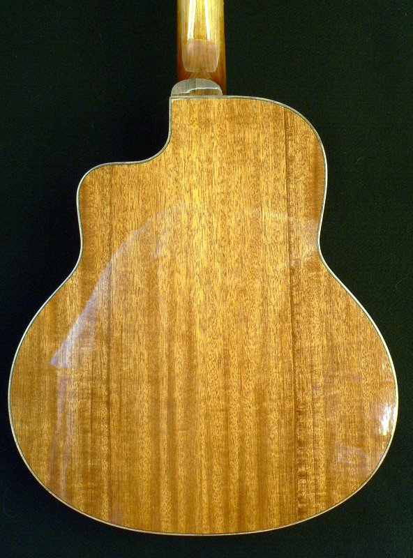

Last, the mahogany back. Thanks for looking!

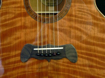

That's really outstanding. I may have to borrow that bridge design, it's interesting. Not traditional, but not really radical either. I like it. :D

Very nice job, Mark. I would expect no less from you. Your photography is also very good, as I can see the grain lines and coloration of the redwood clearly. It is such beautiful wood to look at but may surprise you some time down the road as it can separate along the curls from bridge torque. I would think it wise to use a thinner and larger bridge plate to spread the load. I have used laminated bridge plates occasionally for such applications. This way the plate can be thicker under the bridge yet still spread the load to a greater area. Another remedy would be a Bridge Doctor to relieve most of the torque from the top, but that may effect the acoustic response.
