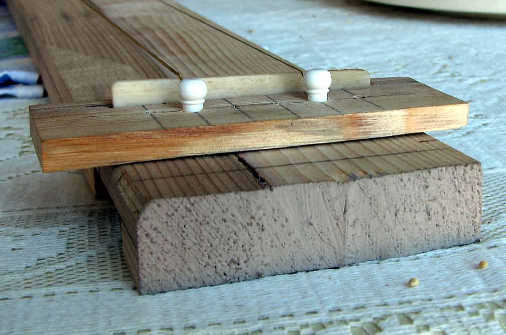

A question for Mark S and anyone else that has seen a lot of lifted bridges, to followup on Mario's thoughts on causes -- Can you tell how often the failure seems to be caused by abuse (hot car, etc), poor joinery, too much stiffness mismatch, age, some other factor(s), or just something that happens to some % of guitars but a cause isn't very clear? Also, do they usually start peeling at the rear edge or the wings?
Trevor, I think we very much agree about artfully simplifying a model to gain enough insight for guiding design work. Also that there are many valid levels of sophistication in modeling, depending on the question asked and the time and tools available to answer it. The thing that led me down the path of modeling for non-rigid parts and pressure distributions was the curious behavior of the pinned bridge FBD when I assumed rigid bodies. In my first post on page 2, if b>h, the pinned bridge doesn't lift and the rear force actually becomes compressive. So I got to wondering about how flex might change the model. I'm pretty sure the "R" force is real as I've seen it elsewhere and it explains a lot, but the rest of the distribution is more of a guess. Curious what you think.
Peter, I'm curious about a behavior in your experiment -- if you force the unglued bridge down flat against the top, does it return on its own to that same slightly rotated position?

Peter, Good to hear, thanks for confirming that! Would you have a rough estimate of how much force it takes to get the bridge to lie down flat?
Jeff, thanks for the suggestion. Yes, that approach does resolve the odd rigid FBD behavior. On the one hand, I don't want to try to convince you, but I'd like to explain why I don't adopt it... To make make a FBD of a glued bridge, I 'cut' through the glue line. For a rigid free-body, that cut face needs 3 reactions: N, S, and M. I can't assume M=0, particularly since it's a long glue line. M is also equivalent to a couple of 2 normal forces, placed anywhere (though the front and rear are most likely).
N, S, and M can also be transformed into the single reaction force (and subsequent distribution) that you described. That is an elegant transformation, but I can't assume it's how the bridge behaves. When I draw that diagram, it looks like it treats the bridge as a particle with all forces pointing through the particle center. For finding bridge reactions, I think it's best to model the bridge as a body, but for modeling effects far away from the bridge, a particle model would be good.
On the experimental side, Peter's model shows the unglued bridge rotates slightly. In order to get it to lay as flat as a glued bridge, the bridge needs to be clamped at the rear. If we wanted to remove the clamp but keep the bridge just as flat, the bridge would need tensile reactions at its bottom rear.

On the experimental side, I think what you are seeing is mostly due to the deformation of the test soundboard creating a hump under the bridge. The downforce at the front of the bridge is maintaining contact there while the back separates
I think one of the issues you are having with trying to analyse this is that you are not putting any dimensions on this. If you give h and b dimensions as I suggested then you can actually solve this for a single reaction located back from the front of the bridge.
If you can give a dimension to the width of the bridge w then you can solve for a two point support.

No, it's not due to deformation of the soundboard - it was present in the first experimental model on the essentially solid plank.Jeff Highland wrote:On the experimental side, I think what you are seeing is mostly due to the deformation of the test soundboard creating a hump under the bridge. The downforce at the front of the bridge is maintaining contact there while the back separates

Peter, do you have the correct "neck angle" built-in to this test rig?
- Posts: 497
Re: Purpose of bridge pins?
In the physical model, the bridge's rotation is being limited by the bridge pins. When the clamp is removed, the moment is transfered to the pins.
If that is correct, tighter pins should reduce the rotation.
By the way, has anyone measured the horizontal displacement of the bridge due to string tension? I'd like to know if the estimate I came up with is in the ballpark.
