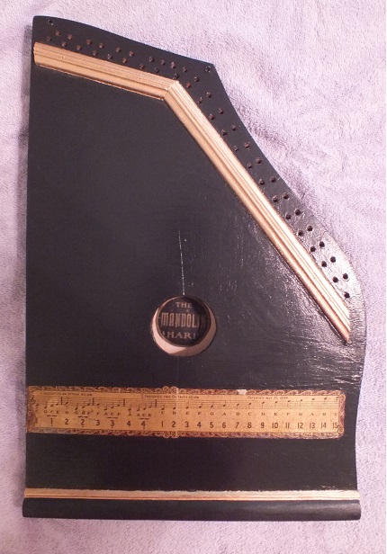

Well, disaster has struck as usual, when it comes to painting something. I have always had disasters when painting something. I was trying to paint the sides of the Zither, when I knocked over my paint, splashing the instrument with the black paint. Now I will have to basically paint the whole instrument again, black on the back and sides, and the goldish colour on the front. I will just have to come up with new decals of some sort, or if possible, use the pictures I have of it, and create new decals. Not sure I can do that, but I will try.
Of course, the disaster was not limited to the instrument, but to furniture and the floor. I just do not know why paint and I do not mix without some kind of disaster happening.. So, I will stop the posting until I come up with some solutions, and something that is worthy of writing, and putting up pictures on. Caley Ann

Karl, All isn't lost, thank goodness. At least I didn't drop it, and break it. The positive in all of this is that those cracks I repaired will disappear under the paint, except in one spot where the decal shows the key to the notes accross the intrument just below the sound hole.
I've looked at more vintage Zithers online, and found many have either black fronts, or are finished wood appearance. Since the one important graphic is untouched, the key to the strings, I am going to paint the remainder black. I have had a lot of difficulty painting, and not only the disaster I mentioned. I never have been able to use a brush, and not get brush strokes. My first coat of paint I ended up using 400 grit sandpaper to remove as many of the brush stroke ridges as I could, and still did not get it all done. I then used a sponge brush, and for the most part, things are pretty smooth, though still having some of the original brush ridges. But I guess it will do. I definitely like the black paint that Home Depot made by matching the original black on this instrument. I guess there is always one positive in it all.
Of course, you Guys will probably shudder at what kind of decals I am going to use, but like I said, there are many vintage Zithers out there, and a lot have floral graphics. I found 1/2x3 inch floral border graphics, and also one graphic that will be able to span the sound hole, a floral wreath like graphic. Anyway, waiting for the graphics to arrive. Meanwhile I am continuing painting, something not as difficult as when I started. Caley Ann

Gents, Like I have said before, painting is not something that I can do. I can put it on, but not very well, and the picture shows just how bad I am at it. It is painted, and that is almost telling a lie, as I am not a painter. Never could figure out how anyone can get a perfect finish with a paint brush.
I put felt pad feet on the back, instead of the brass tacks that the previous owner had on it. At least they are soft, and will not mar the surface it is put on.
Paint is black everywhere except for the strips of wood that the strings sit atop. Those are done in imitation gold leaf.
I am still waiting for my vintage floral waterslide decals. I am hoping the decal colours are vibrant enough to show on the black background. Caley Ann

I waited almost two weeks for a set of decals. They finally arrived. Anf they did not work. They were totally invisible on the black background. So I decided to just stay with the border decals that are designed for ceramic and glass work. The results are pretty undferwhelming.
But I now can start on putting the strings back on. Have to redrill a couple of anchor pins that were basically sticking upwards. Then I have the fun of figuring out just which string goes where. Even with what I considered detailed notes on each string and location, nothing is a given when I am doing it.

Steve, no idea why you are apologizing. Yes, I knew I could print my own, but you have to have the right brand of inkjet printer that uses the right kind of ink. Some laser printer ink does not do well when it gets wet, even after drying. The only way to use such a printer with runny ink is to have a can of spray stuff that basically seals the ink under sealer.
These are waterslide decals, so they can be removed with some effort without hurting what's beneath them. But before I go to the expense of purchasing the waterslide decal sheets, and the spray fixative, I need to research more graphics for these Zithers, and find a photo that is actually clear enough to use in a graphics program. So far I have found nothing but low and medium resolution photos.. CaleyAnn

Steve, Yup, used a rattle can of Polyurethane. I just sprayed from about 18 inches from four directions, and called it covered. I guess you would call that type of spraying, misting.
I am now on the final stretch. I put in the string retainer pins, and then the tuning pins. I've started putting the strings back on. Right now I am putting the thick ones back.
I have finally realized that piano wire is probably only good for wires under .030. From what I have read, the wires starting at that size are wound bronze type strings. So, those piano wires I purchased .030 and over will only be good for crafts.
I need to locate a website that lists all the sizes of wound type strings up to about .064, as I will more than likely need some. I've already had one wire give up the ghost. It was just too brittle to take the twisting. I am guessing that is probably normal for strings that are old, and have been stretched.
Might get the strings in by tomorrow, but tuning them might take some time, as this will be the first time I have ever done a tuning of a stringed instrument. CaleyAnn

Newest on the Zither saga. I was going on in my usual slapshod manner, not understanding why I was not getting some strings placed properly (askew at an angle acreoss Zither face). Well, I finally got smart and counted the tuning pins, then the hitch pins, and discovered that not only do I have missing strings, but I also have a couple missing hitch pins.
Seems hitch pins are expensive when you include shipping. Does anyone recommend a substitute I can get from Homely Despotty?
Also, due to my discovering that my piano wires are really only good for about .020 and under, does anyone know of a source of music strings above that size, and wound music strings .030 and larger. Of course, these strings need to be able to be shortened to fit this instrument. I looked at guitar strings, and they do not look like they can be shortened
As for doing loops in the music wires, that did not require a special twist pliers tool. I just used my vise grips to hold the crossed wires in place, then used another set of pliers to twist the two wire ends a few times. I used a nail to make the proper sized loop.
Right now I have gotten in the frustration mode, so I am stopping work on this for a few days. I did manage to get 75 percent of the strings in place, though a few are anchored to the wrong hitch pins due to a few of those missing in action. Some of the strings I thought I had labeled, somehow lost their tags, so I am going to have fun trying to figure out where those strings go9. I am using the length method, where the string comes over the bridges, and then hits the tuning pins. They all have a bend at that point, and I am hoping my method of madness will work.
So, just waiting for you Guys to point me in the right direction of replacement strings, and hitch pin substiitutes. CaleyAnn

Bill, Thanks, that is just what I did this morning, and just happened to have a couple of the correct diameter. I just snipped them to the length I needed.
I went ahead and loosened the strings in preparation for having to move a few over to the correct anchor pins.
This Zither is really strangely setup when it comes to the string notes. I'm not sure how many strings a guitar has, but it seems they are grouped in four, with a thick string followed by decreasing diameter strings. There are four sets of strings like this. Then the last 34 strings are for the most part paired, with only two being individual strings. The pairs are of course one thicker and one thinner string, but the size difference lessens as you move to the right on the board. All of this is going to make figuring out what the missing strings sizes are interesting. I guess the important thing is trying to get each of those missing strings replacements to match the note on the chart on the front of the Zither.
One thing I have noted about the old strings is that many of them sound odd, not sharp like I hear from most instruments. I am wondering if these near 80 year old strings might just be stretched to the limit, and have lost their resonance, or whatever you would call it. I think I will be replacing them slowly, as I figure out what kind of strings will work on this instrument. I get the feeling it is going to be a lot of trialf and error when it comes to those strings over .020. CaleyAnn

Chris, Thanks for going to all that trouble. Unfortunately my Zither is not a guitar Zither. It is an oddball type called a Mandolin Zither. So, fret positions will not help.
What I need to do is figure out just what sized string goes into each string position. What I have done is create a chart containing all 46 strings. I labled each column as follows: String Number, String note printed on the graphic on the front of the Zither (to include the note about some strings being one to two octaves Lower than the associated string with the same note in that four note grouping), and I measured the length of the strings from bridge support to bridge support.
I really do not understand what part of the string actually does the majority of the resonating, but I am guessing between the bridge supports.

I finally decided to fill the empty slots with temporary strings. They are the correct diameter, but they are not quite what I want. I am still trying to determine just what kind of strings Zithers use nowadays. One lady, "ZitherGril" on YouTube showed how to put on a new string on an old Zither. The string was either silk, or nylon covered. Apparently not all strings are outwardly looking like metal. I now see plastic type strings, the ones with the nylon coverning, wound and unwond. Kind of confusing. I'm not quite sure what the general type string most commonly used is for Zithers.
I attached a photo of it, with all the missing strings filled in with nice silvery music wire. You can tell the difference in the photo. I am guessing all the others are quite oxidized, and need replacing.
This is only an experiment for me, trying to repair something that was probably not worth repairing. But I have learned more about these instruments, and hopefully I can continue to increase my knowledge. Mr. Garside(unfortmately deceased) had a video on how to make a simple Zither. I plan on making a few myself, but really want to make one that is higher quality. Also want to string it to the Munich type setting, instead of the Vienna. Apparently the Munich stringing is supposed to be easier to work with. I need to read more about this. But I think that these two setting are for guitar type Zithers that use a fret board. If I remember one video of someone playing this type, they basically used the four strings above the fret board, and occasionally strummed the other strings that I think are called Melody strings
I appreciate Everyone who has helped here. It has been fun. I always like doing something new and interesting. Once I have gotten more done on this instrument, I will post more. Thanks again. CaleyAnn
