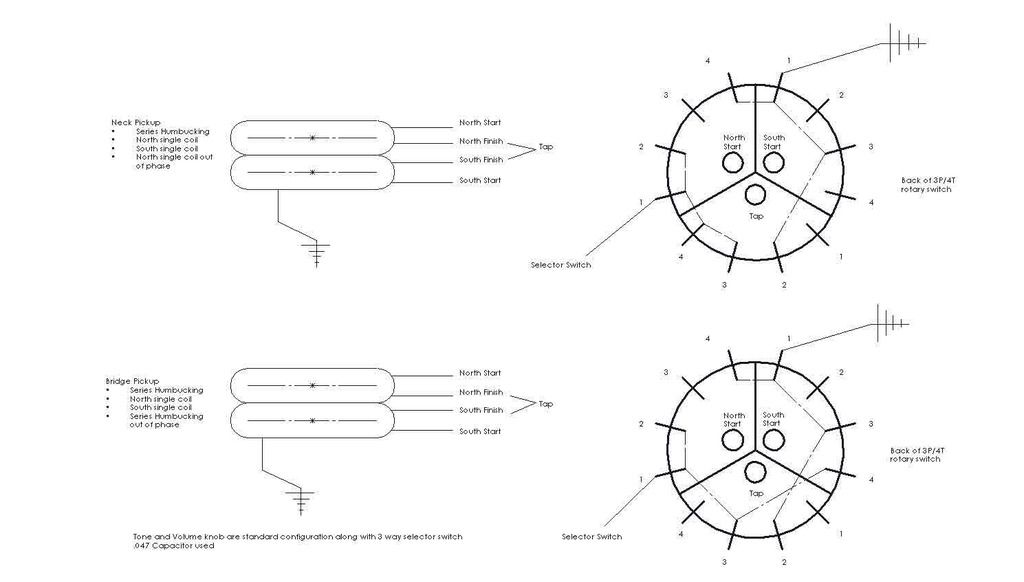

Post by Eric Baack »
Here's the wiring schematic for the rotary switches
Did a small electronics repair on it last night. The single coil out of phase option on the rotary for the neck pickup (now that's a mouth full!) was not soldered, the jumper wire was through the lug but I had forgotten to solder that one so in the clean tones video you can hear where it drops out when I switch to that option. Just a dab of solder and it works great :)
Now to fix that broken screw sometime....
